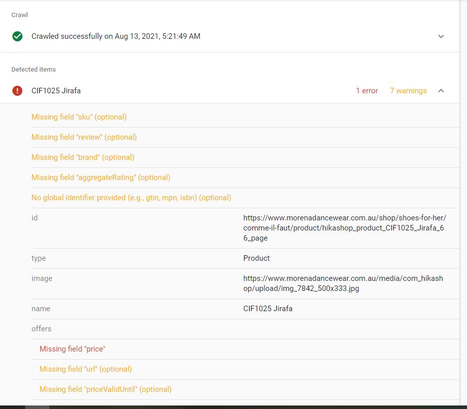

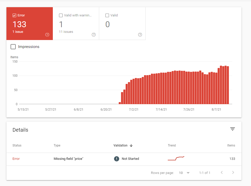

According to "Google Search Console", my website has error in 133 Products in which the price is not given. I have around 500 products and I am wondering if there is anything we can to ensure that these 133 products are complying as in the rest of the products.
I have attached photos of the problem for your information.

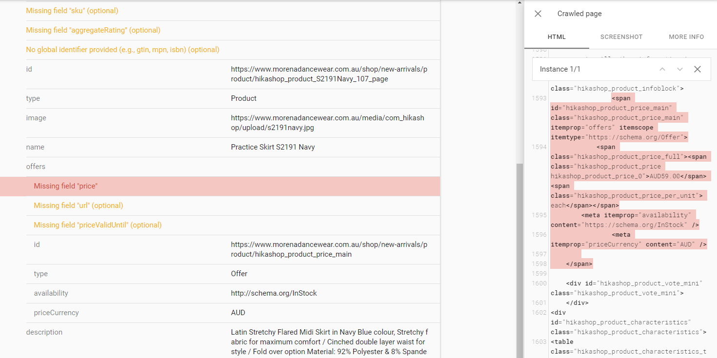

The meta data seems to be included in the view file of hikashop (in my case line 103 has "<meta itemprop="price" content="<?php echo $this->itemprop_price; ?>" />".
Google seem to be looking at a different section! I have attached a description of the error in a picture.

I was a bit fast, my bad.
The issue and solution is what is described on that other thread, but with one difference.
You've changed the "layout on product page" setting to use "tabular" instead of "default".
So in that case, it's not show_default.php which is used but show_tabular.php
So please check that view file instead.
