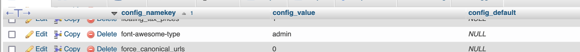

You can't remove it just for the cart module.
You can remove it on the frontend.
To do that, you can add an entry with the namekey font-awesome-type and the value admin in the hikashop_config table via your PHPMyAdmin. That way, font awesome will only be loaded by HikaShop in its backend.
  • Posts: 366
  • Thank you received: 26
4 years 11 months ago #335473
Thanks!
I have made this entry, but there's no difference?
Am I missing something?

So I checked your database and I can see that you have HikaShop's tables three times:
i.imgur.com/AorvVOG.png
And I can see that you've added the font-awesome-type entry only to the first one au2m8x_hikashop_config
Now, since you didn't provide the backend access of the website new.novame.dk/ I'm not sure which one of these tables is used by that website.
Looking at the configuration.php file of the FTP access you provided, I can see that the Joomla website of that FTP website is using the table prefix vsr8v3o_
So I tried adding the ont-awesome-type entry only to the vsr8v3o_hikashop_config table and it seems to have worked. Please confirm.

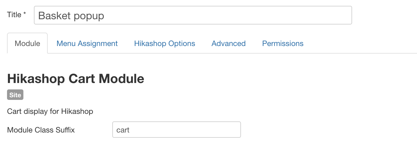

  • Posts: 366
4 years 11 months ago #335675
Thanks!
Can you point me in the direction of the files used for Hika Cart Module?
When I disabled that module, things are working fine - enabled the error appears again, so I will look into the code there :-)
  • Posts: 86094
  • Thank you received: 14197
4 years 11 months ago #335677
Well, the module's files are in the folder modules/mod_hikashop_cart/
The PHP file in the tmpl folder there can be overridden by a file in templates/YOUR_TEMPLATE/html/mod_hikashop_cart/
The PHP files there also use the product / cart.php view file of HikaShop in components/com_hikashop/views/product/tmpl/cart.php
However, this view file can be overridden by the template with the file templates/YOUR_TEMPLATE/html/com_hikashop/product/cart.php
But it's also possible that your template detects that the HikaShop cart module is activated, and then it adds its font-awesome and the custom CSS for the cart module. In that case, it could be anywhere in a file in templates/YOUR_TEMPLATE, or even in a system plugin installed by your template.
So it could be hard to find.
