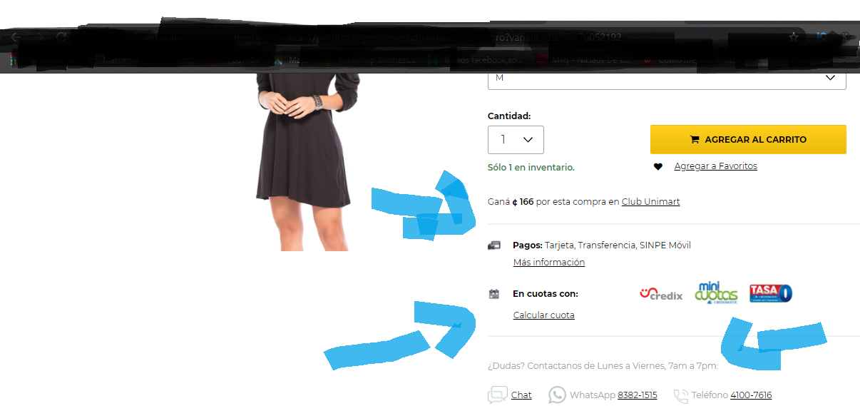

Could you help me to know what kind of configurations I would have to do for the product page to look like this?

From what I understand, that whole area is the same HTML added on the product details page of all the products of the shop.
To add such HTML, you can edit the file product / show_default.php (supposing that you have the "layout on product page" setting set to "default" in the HikaShop configuration) via the menu Display>Views. There, you can add the same HTML after the line:
<!-- EO RIGHT END EXTRA DATA -->

Hello again, what I want is to add additional codes or icons to the right side of the product as in the image on the side above, with the difference that I have the tabular configuration and not the default hikashop to display the product

Thanks but what I want is to add items on the right side of the product but not in the default configuration but in the tabular configuration of the product

You'll find the exact same line of code
in show_tabular.php
So you can just add your HTML after it. It's the same as for show_default.php
