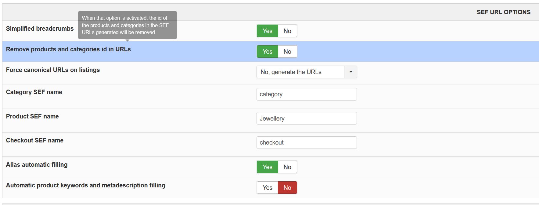

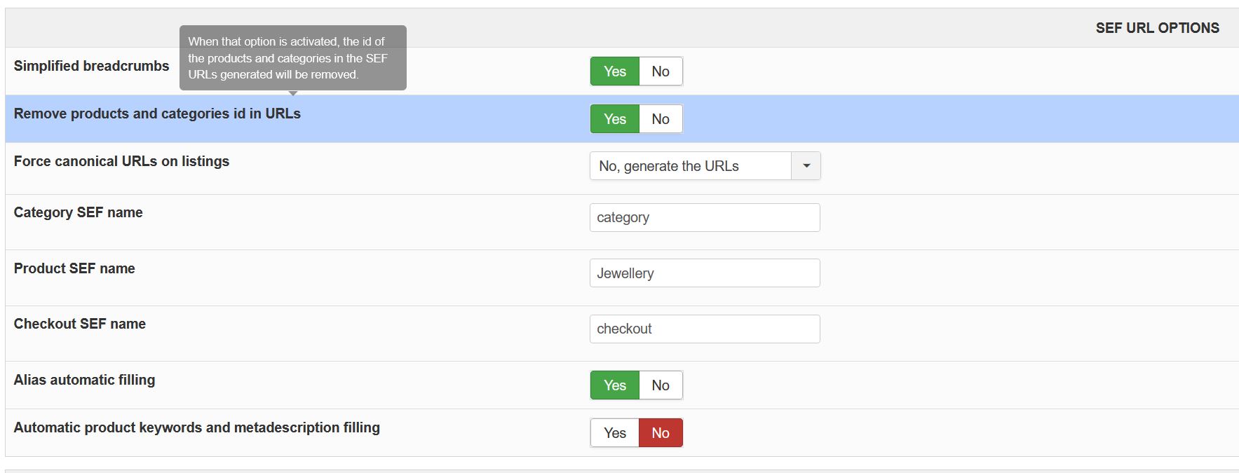

-- HikaShop version -- : 4.4.4
-- Joomla version -- : 3.10.3
-- PHP version -- : 7.4.25
Hi, I have read through the forums and can't seem to understand how to remove 'component/hikashop' from the product URL. I have attached the screenshot of the SEF settings. I am using a 'Hikashop: Categories' on the page to display the products.
Thanks.

4 years 10 months ago #336669
From what I can see on your website, you're using one or several HikaShop product listing modules to display the products listings.
In the settings of each of these modules, in the joomla modules manager, you have a setting "menu" where you need to select a menu item of the type "HikaShop products listing" so that Joomla's SEF system will use the alias of that menu item instead of component/hikashop when generating the SEF URL.
So make sure that this is the case. You might need to first create that menu item via the Joomla menu manager.

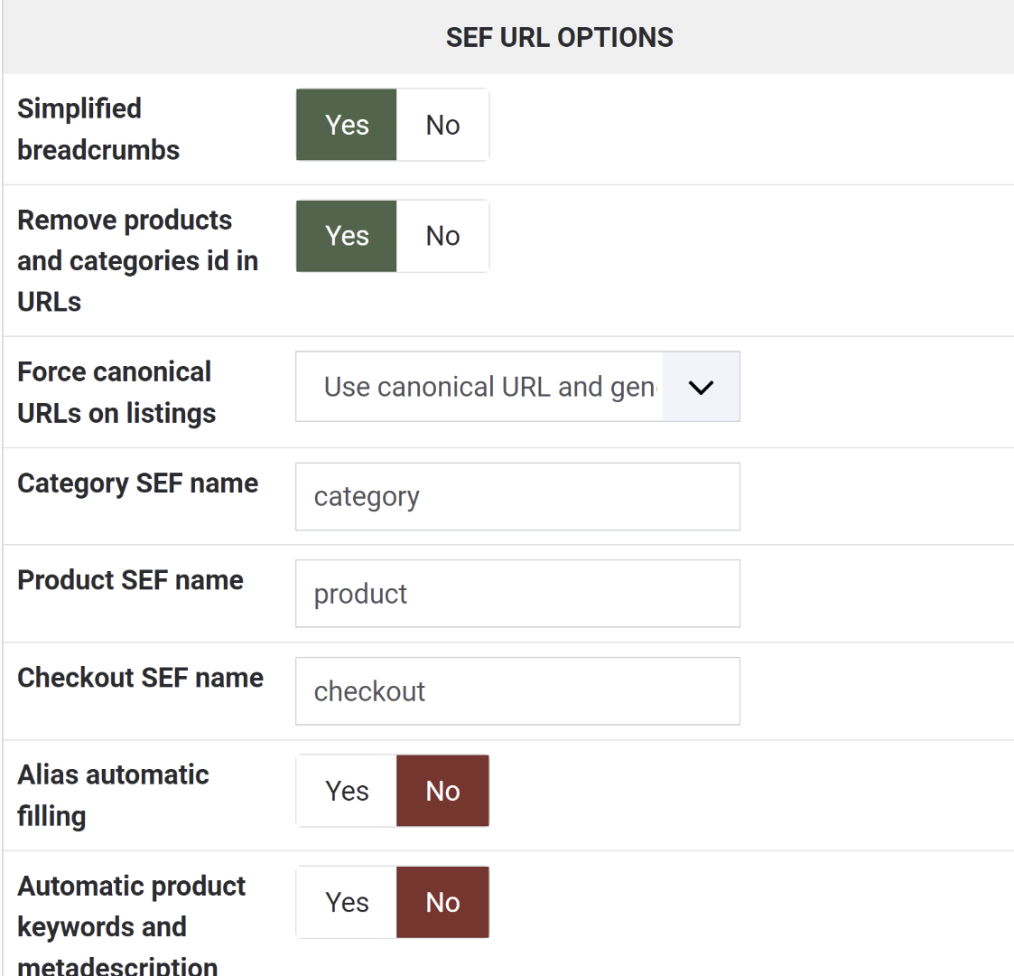

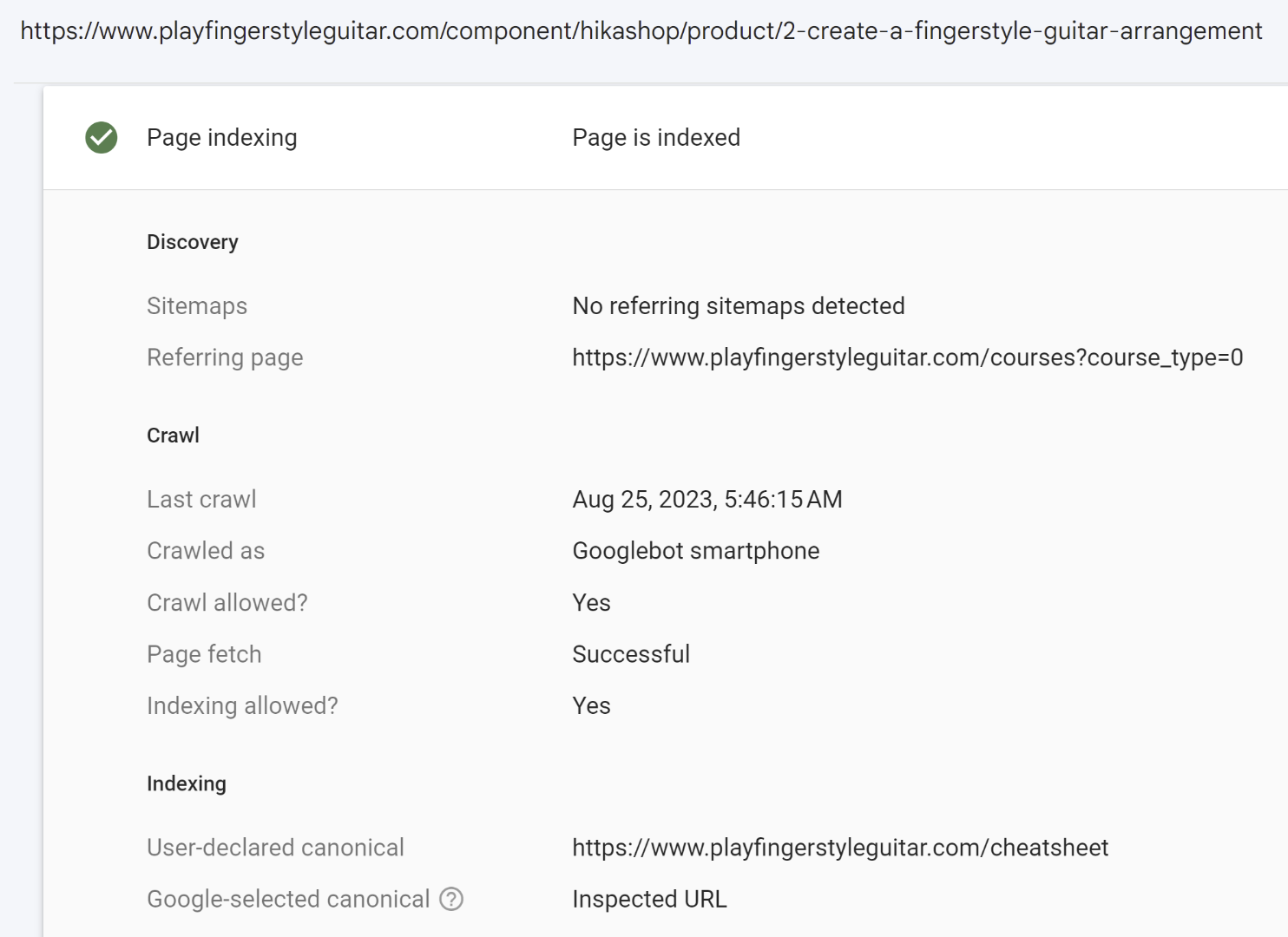

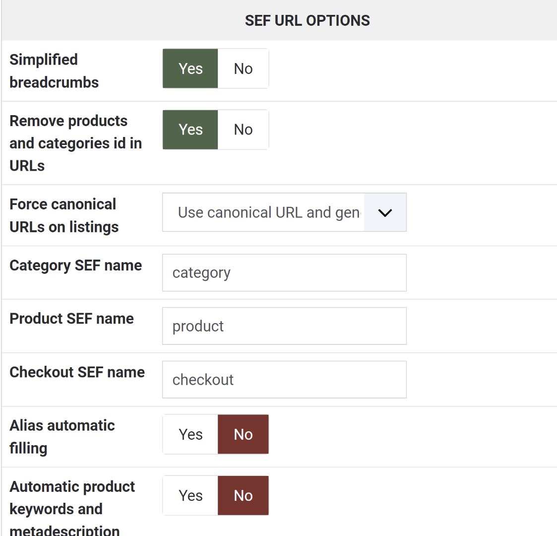

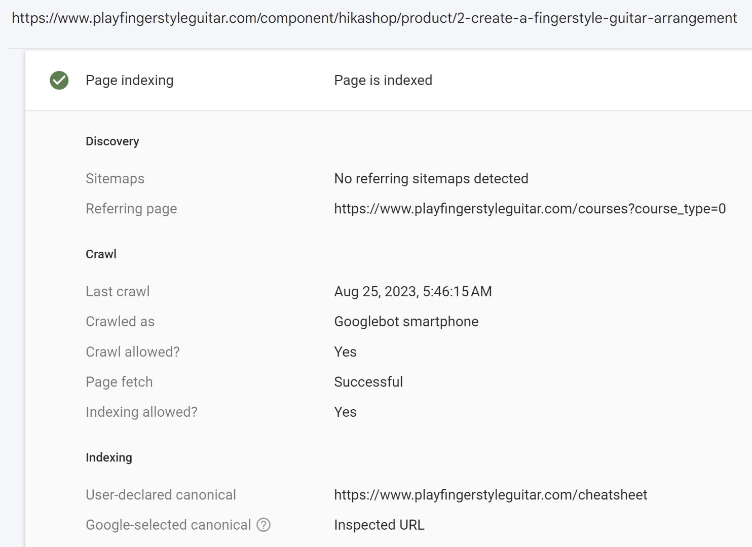

Hi, thanks for the quick reply.
I've provided a screenshot of what I see in Google Search Console as well as what I see in the SEF options for HikaShop.
It seems the referrer was from an E-learning component on my website. The URL was the "add to cart HTML link" url provided in the hikashop product options.

  • Posts: 86087
  • Thank you received: 14194
2 years 11 months ago #354995
Are you saying that because I have provided a canonical URL I shouldn't worry that this page is indexed by Google?
Based on your latest screenshot, I can see you do have a problem.
The page /component/hikashop/product/2-create-a-fingerstyle-guitar-arrangement
says that its canonical URL is /cheatsheet
However, the page /cheatsheet is not the same page.
That's why Google is referencing /component/hikashop/product/2-create-a-fingerstyle-guitar-arrangement
From this, I understand that you entered "cheatsheet" in the "canonical URL" setting of your product "create-a-fingerstyle-guitar-arrangement". This is wrong.
You should enter there one of the URLs of the product which is valid. For example, if you create a menu item with the alias "create-a-fingerstyle-guitar-arrangement" of the type "product page" linked to this product, so that when you click on that menu item, you get the product page, then you should enter /create-a-fingerstyle-guitar-arrangement in the canonical URL setting of this product.
Another thing is that Google says that it found the URL /component/hikashop/product/2-create-a-fingerstyle-guitar-arrangement on the page /courses?course_type=0
However, I don't see that URL anywhere there.
So I suppose it means you've change things around since Google indexed /courses?course_type=0 and you want it to reindex that page.

There is nothing wrong. This comes from the "product SEF name" setting of your HikaShop configuration.
Empty that setting and it will remove that part of the URL.
