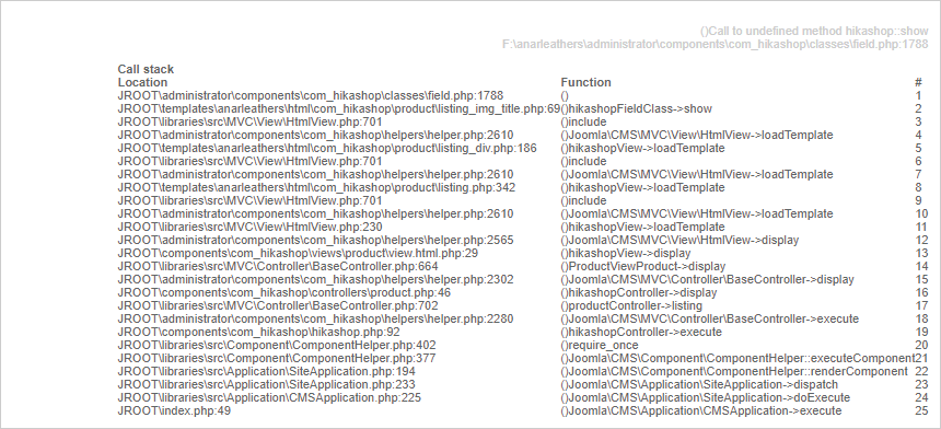

  • Posts: 240
  • Thank you received: 13
4 years 9 months ago #337357
I turned on debug system and atached the screenshot :
  • Posts: 240
4 years 9 months ago #337358
That was a kiddy mistake by me ... the code worked perfect. thank you.
