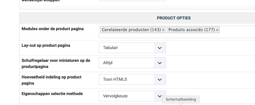

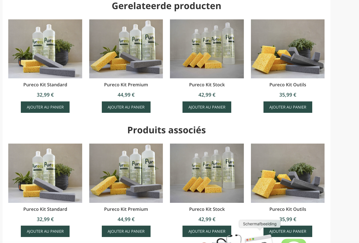

I have a site in two languages. I'd like to show a particular module under the product page.
I have the module in the French version and in the Dutch version.
Now it shows both modules in both languages! That is not how it is meant to be.
I already installed moduele manager of regular labs and included the Dutch language for the Dutch module and French for the French version.
But it seems that the settings in Hikashop configuration are overruling this.
What can i do to make it working as it should be?
  • Posts: 86181
4 years 3 months ago #342488
In the settings of the modules, you need to select the language for which each module is:
i.imgur.com/UKDizag.png
It's not a setting of Advanced Modules Manager, but a default setting of Joomla, once you've configured several content languages on your website.

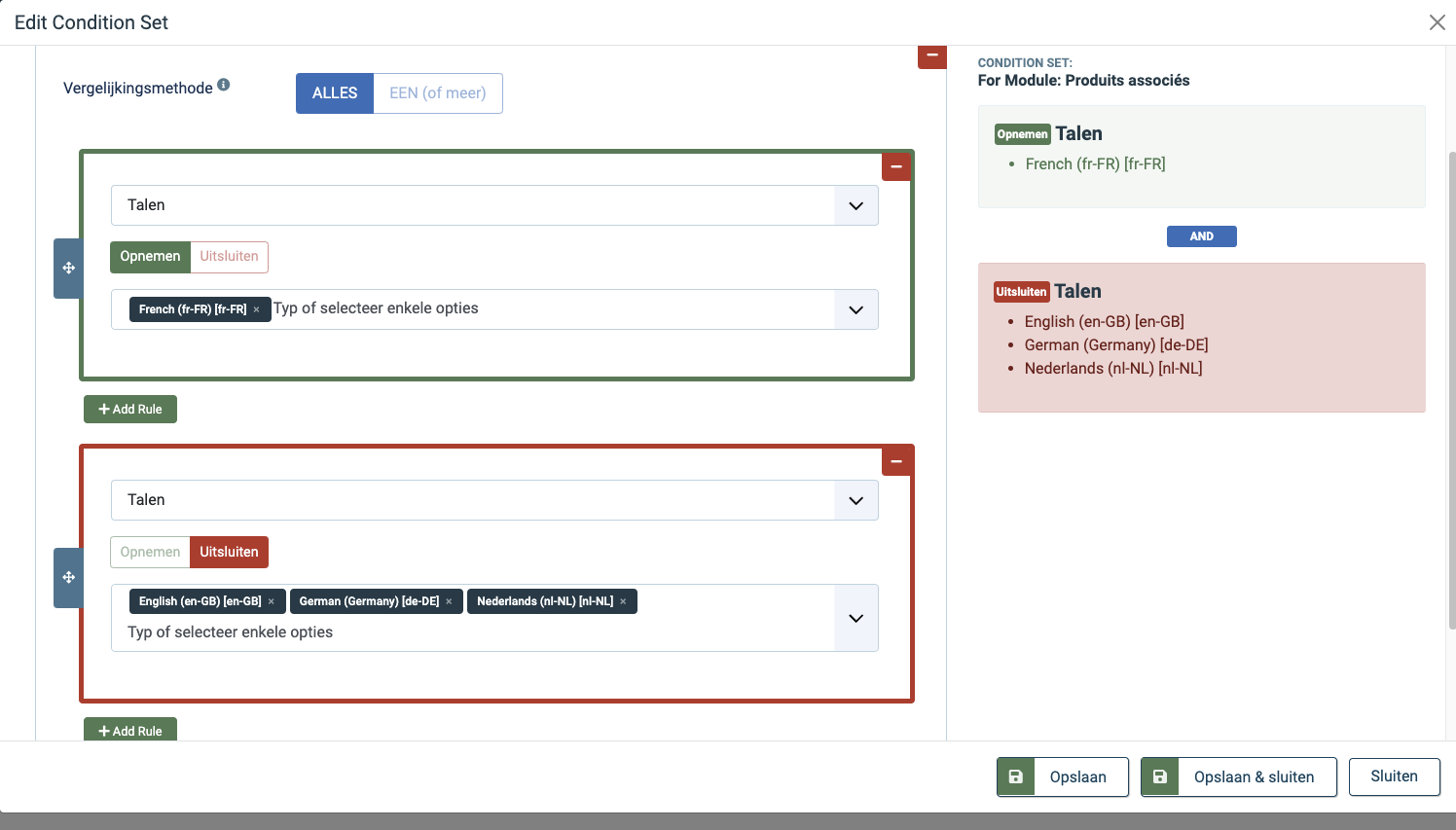

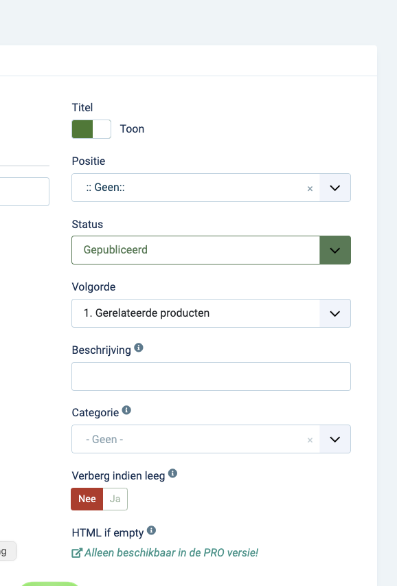

  • Posts: 22
4 years 3 months ago #342504
I understand what you mean but once you have installed the advanced module manager, the option to choose your language is not visible anymore in the first tab of the module:
Instead of that, you get the possibility to set up conditions, when the module has to be shown on the frontend:
Unfortunately, both modules (Dutch and French) are still shown on the frontend in the French version.

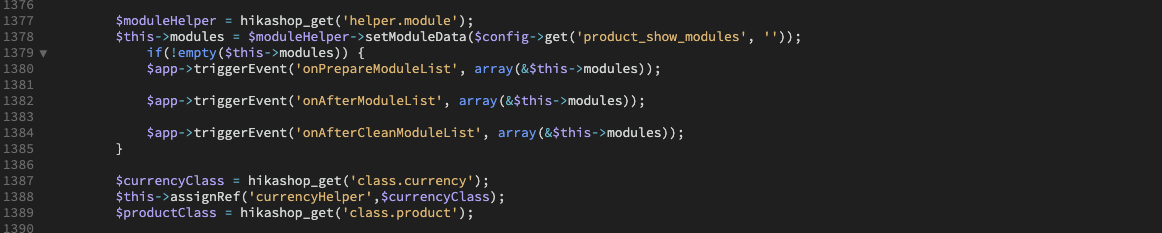

Then, add the code:
if(!empty($this->modules)) {
			$app->triggerEvent('onPrepareModuleList', array(&$this->modules));
			$app->triggerEvent('onAfterModuleList', array(&$this->modules));
			$app->triggerEvent('onAfterCleanModuleList', array(&$this->modules));
after the code:
$moduleHelper = hikashop_get('helper.module');
		$this->modules = $moduleHelper->setModuleData($config->get('product_show_modules', ''));
in the file components/com_hikashop/views/product/view.html.php and it should work fine.
Please confirm that it works so that we can include the change on our end.

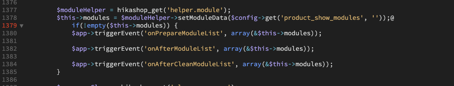

  • Posts: 22
4 years 2 months ago #342953
this is exaxtly what I did:
but I got a HTTP Error 500
  • Posts: 86181
4 years 2 months ago #342959
You've added a "@" at the end of the line:
Remove it, and it should help.
  • Posts: 22
4 years 2 months ago #342969
oops ... indeed.
I did this but still got the HTTP Error 500

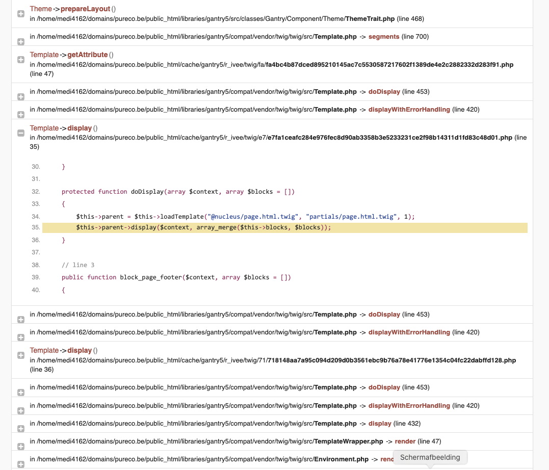

  • Posts: 86181
4 years 2 months ago #342970
That code looks fine.
Can you activate the "debug system" setting of the Joomla configuration and try again ?
It should hopefully display an error message with more information on where the problem is.
Please provide the information you get on the page (a screenshot ?)

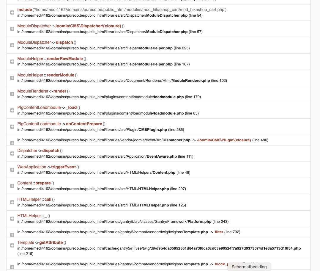

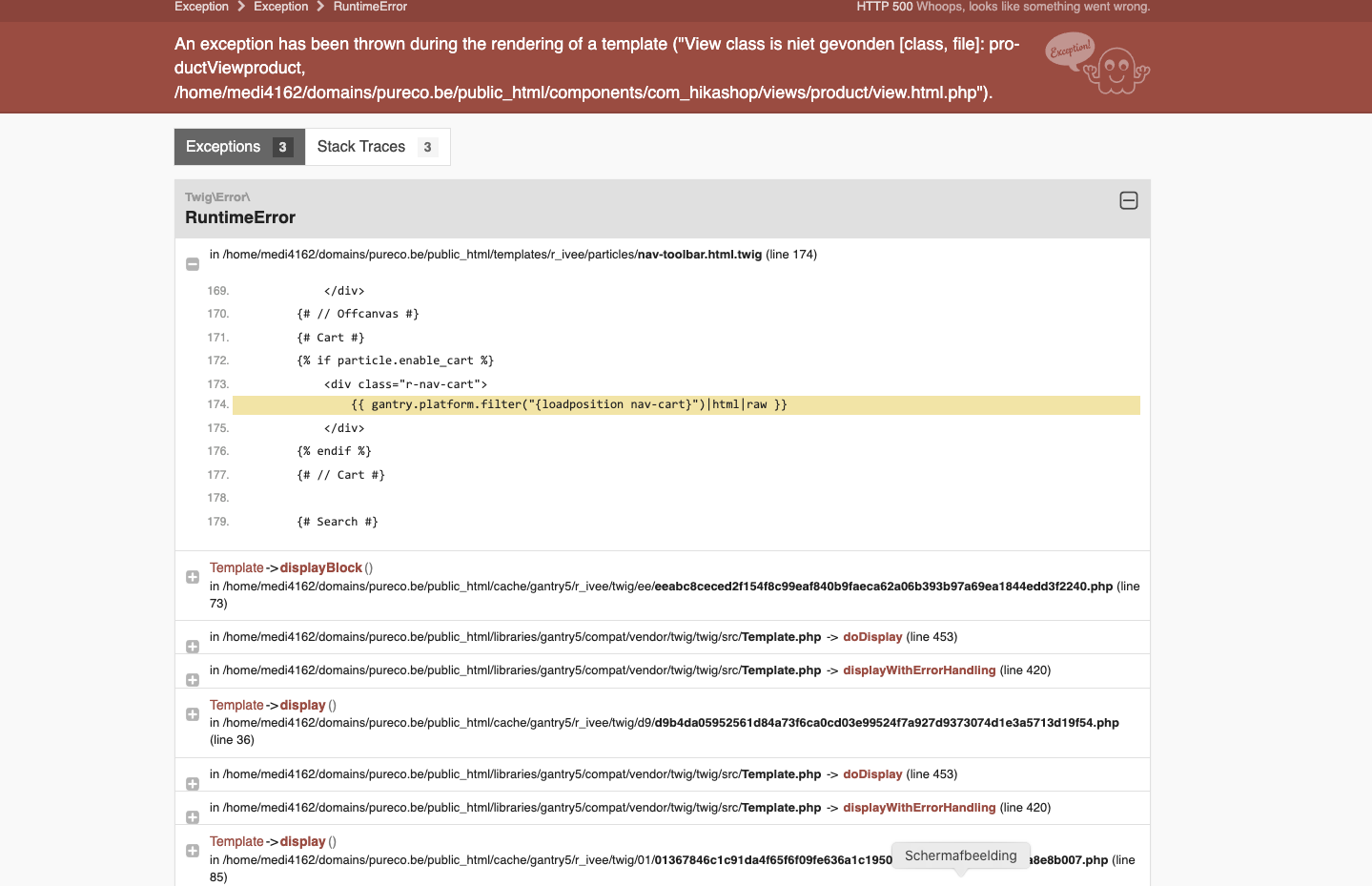

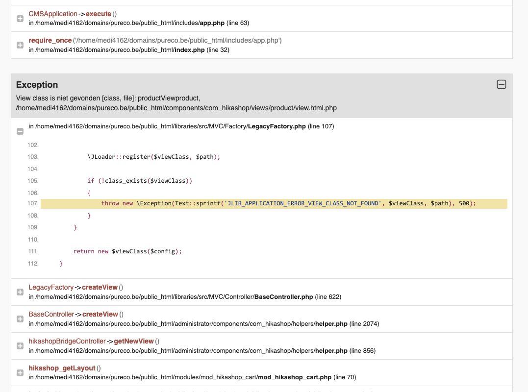

  • Posts: 22
4 years 2 months ago #342975
I hope you have enough information with this?
  • Posts: 86181
4 years 2 months ago #342978
Sorry but that's not enough. Could you provide the full page ?

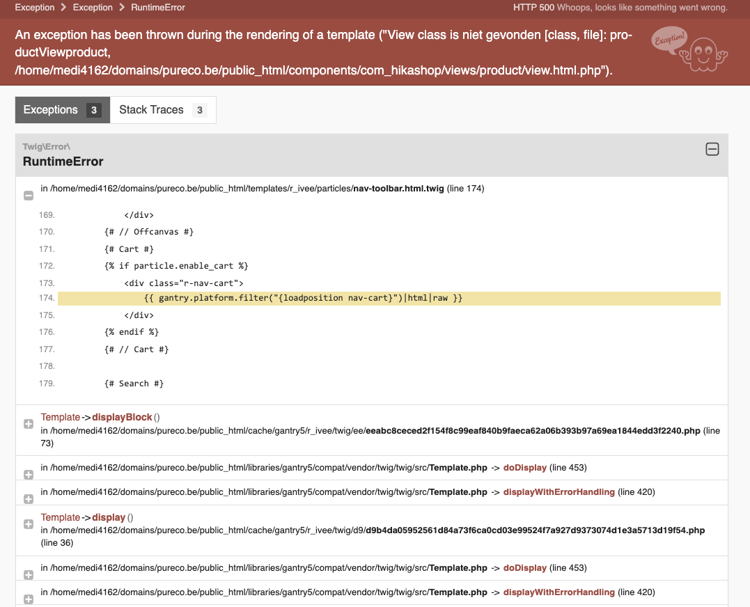

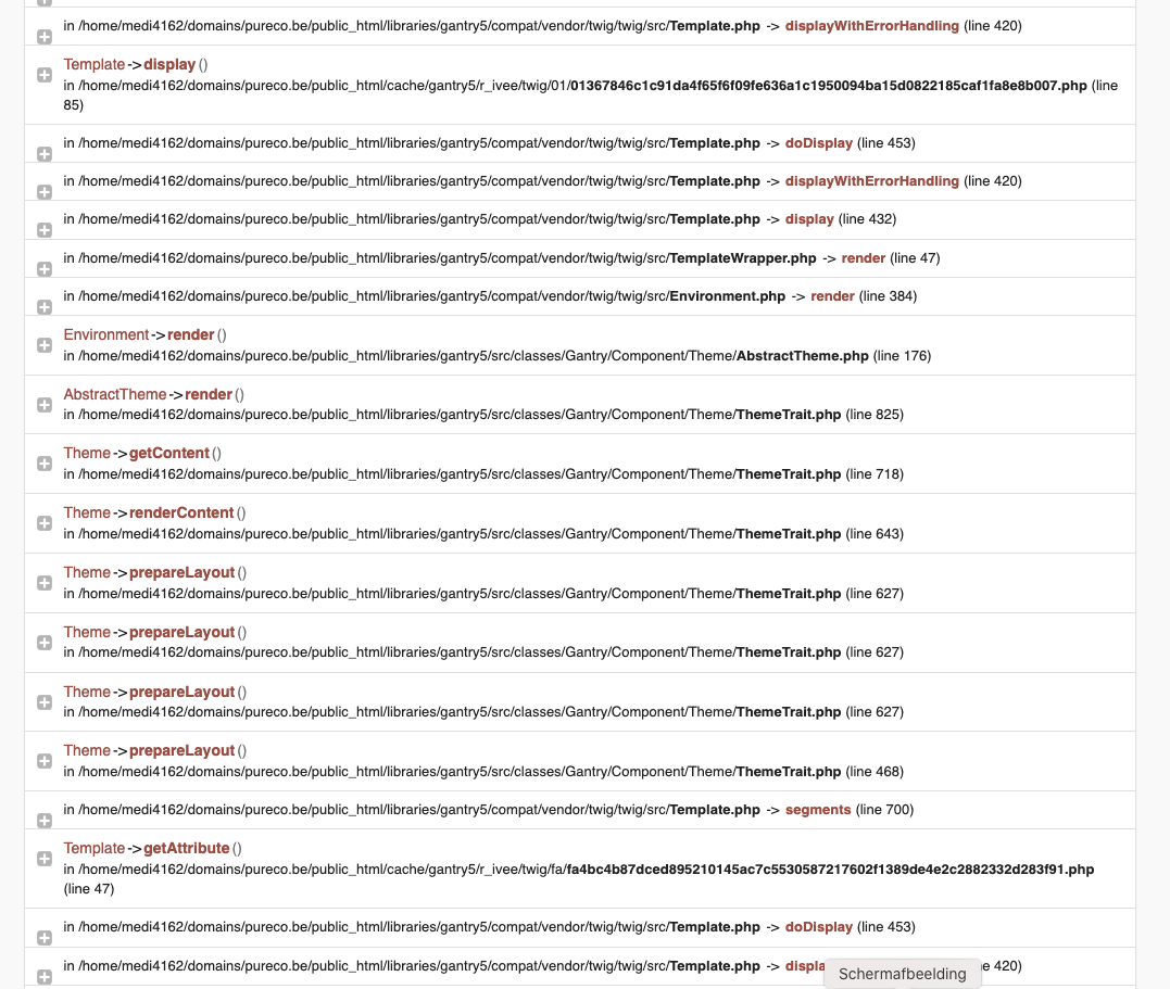

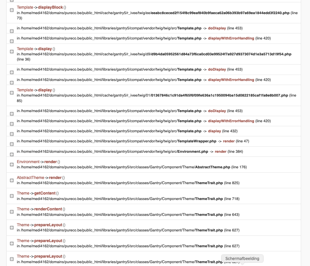

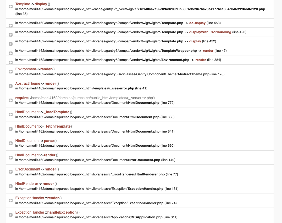

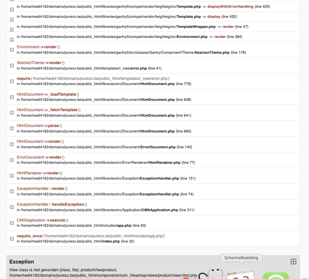

  • Posts: 22
4 years 2 months ago #342985
it is a bunch of screenshots, I hope you don't mind.
  • Posts: 86181
4 years 2 months ago #342986
Thanks. However, I don't see why you get that error. It doesn't even seem to be linked to the "modules under the product page" but something between the template and the cart module.
Can you try again with the default template of Joomla ? Do you have the issue with it ?
And if you remove the code you added you don't get the error ?
On my end, whether I have the code or not, I don't get the error so I'm not sure what's going on.
