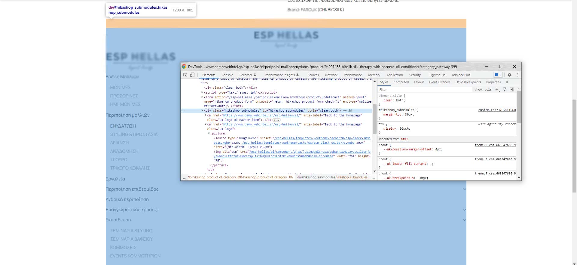

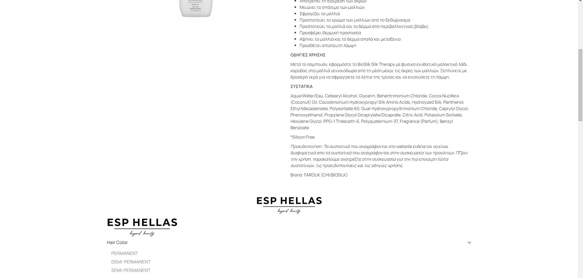

Hello!
After i updated to Yootheme latest version, there is a strange behaviour with Hkashop submodules.
A navbar module seems to appear under the products but if you look at the code is this #hikashop_submodules
You can see it in the picture below.
I talked to the Yootheme forum and they said it's Hikashop's issue.
Thank you
-- Joomla version -- : 3.10.11
Hello!
Thank you

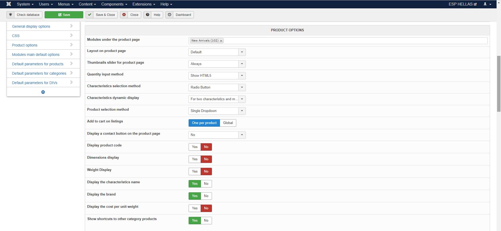

4 years 1 month ago #345138
by nicolas
Replied by nicolas on topic Hkashop submodules issue
This area is displaying the modules you've selected in the "modules under the product page" setting.
By default, you only have the "related products" module selected there.
It seems that you've selected a module displaying the categories of your HikaShop and maybe some menu module of Joomla.
So first, please review that setting and the settings of the module(s) selected in that setting.

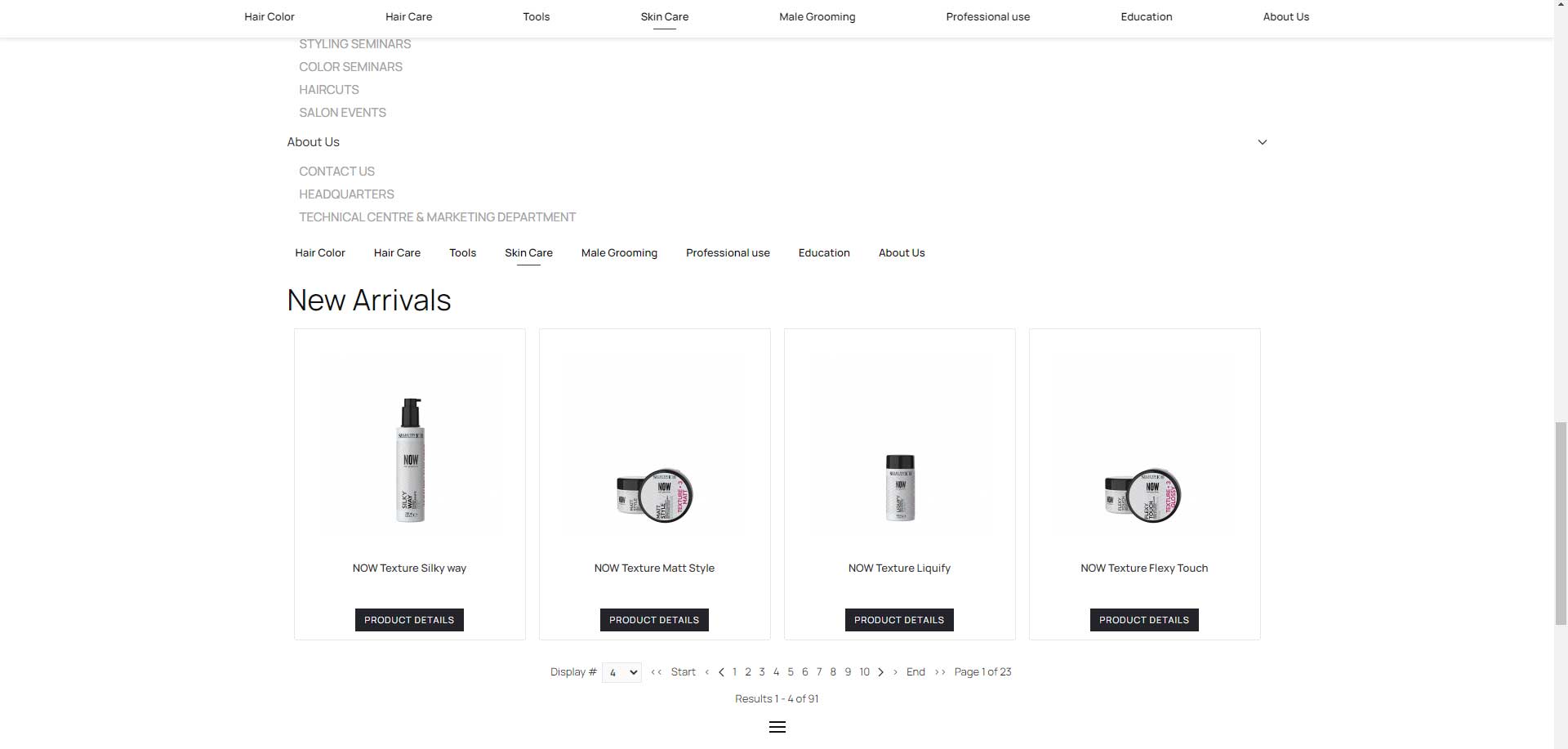

4 years 1 month ago #345144
by verzevoul
Replied by verzevoul on topic Hkashop submodules issue
Yes i saw that, i removed the related products module and it worked but if i choose to have a Hikashop submodule there (New Arrivals for example) then it shows the New Arrivals submodule and the navbar module together. I don't understand
Thank you
Thank you
