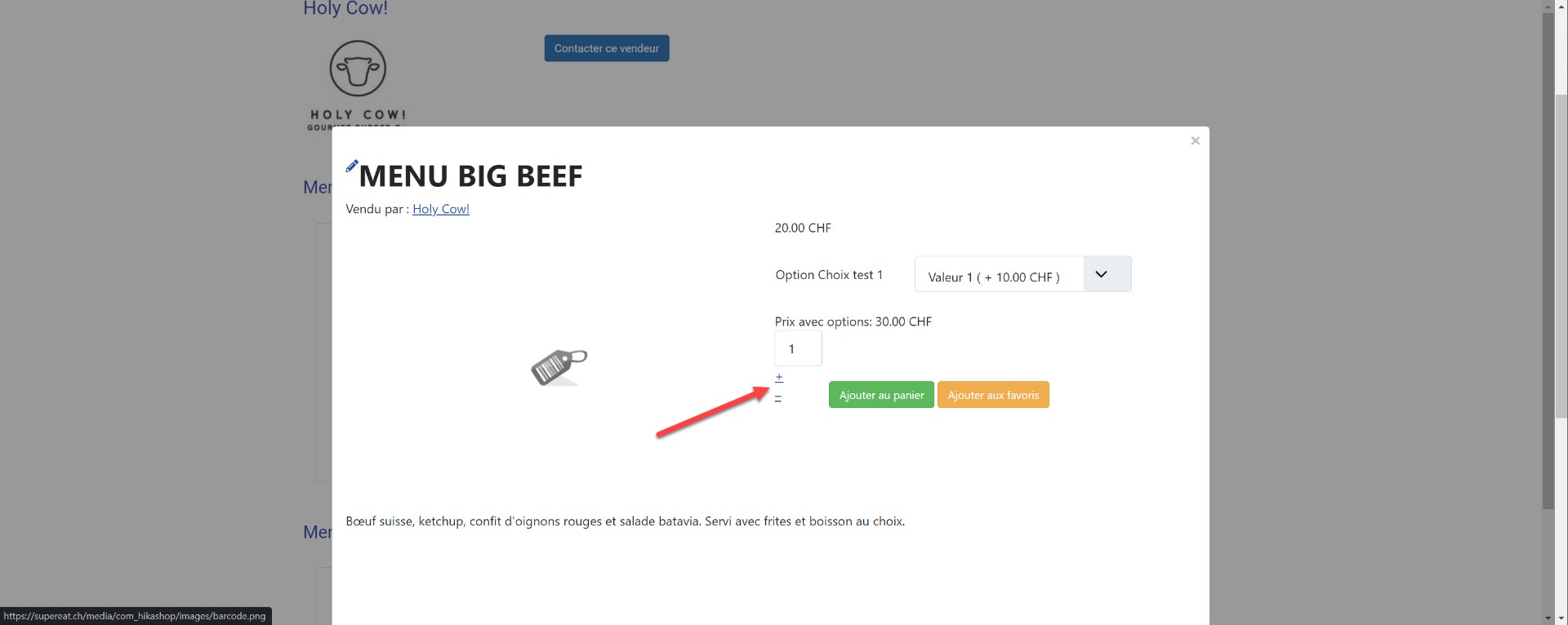

I have a problem with the layout of the + and - selectors in the popup view. See screenshot.
Can you please tell me how to fix it. I want the signs after the quantity box, on the same row.

It seems to be linked to the CSS of the template.
Try changing the "quantity input method" setting of the HikaShop configuration and try the different display modes.
Otherwise, we would need the URL of the page to be able to check the CSS on the page to be able to say what to do.

The problem is the popup take the Cassiopeia style instead my template style.
Because with my template style, the + and - are good (we already fix it in another post with css).
So can i force the popup to take my template style ?

This depends on how your template is made. You should report the issue to your template provider support. They probably need to change the component.php file of the template so that it uses the correct CSS.

OK, i will see that with Yootheme.
