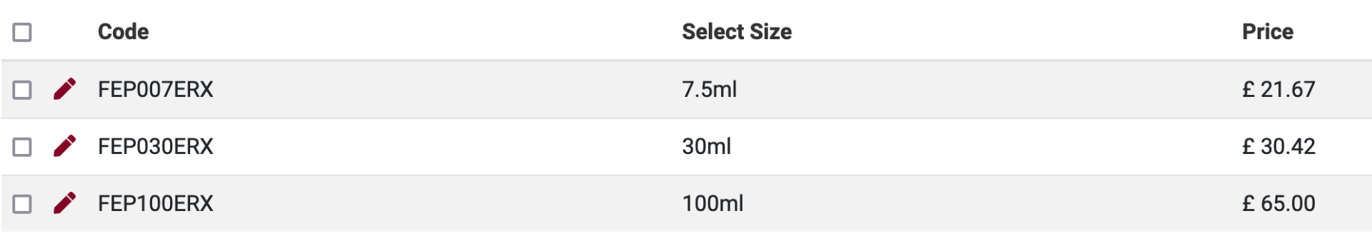

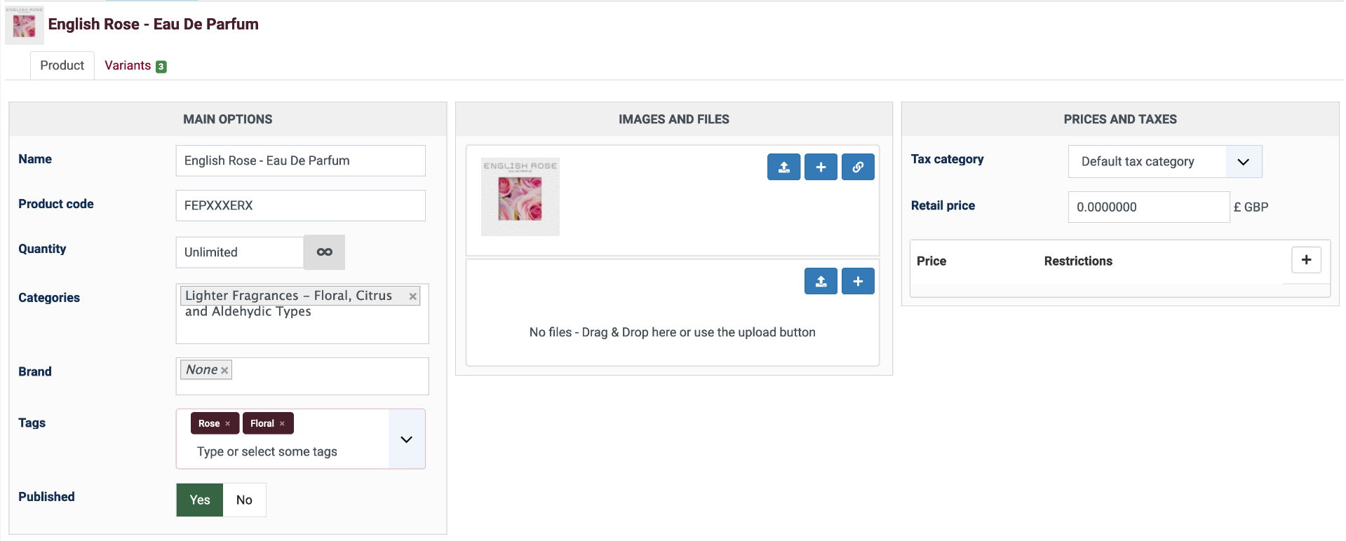

And some screenshots of my product backend, showing no 'root' price but variant prices.
