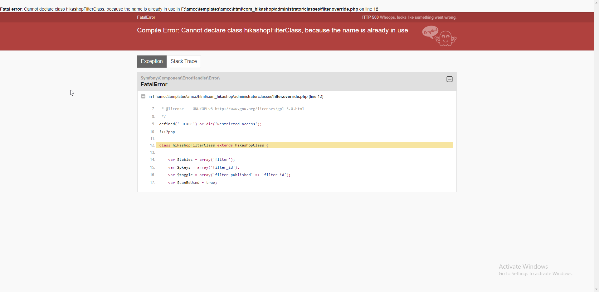

i copied the file "filter.php" form "administrator/components/com_hikashop/classes" to here "templates/XXX/html/com_hikashop/administrator/classes" to create an override for filters but i get the error which is attached to this message.
what did i mistaked ?

You need to change the name of the class to add Override at the end.
