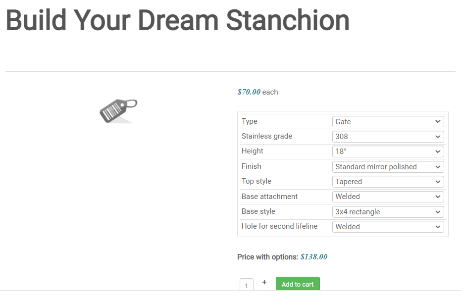

Thanks to Hika team for helping me make a prototype of an advanced product with eight options and 20 variants, dispensing with the need for dozens and dozens of separate products. It can be seen here. www.javelincommunications.com/build-you-dream-stanchion
Everything works, but there are some unfriendly user aspects.
1. The product main price is irrelevant and may only serve to confuse the user. Ideally we only would show "Price with options." Is that possible on a selective basis, instead of using a global PHP or CSS that cascades to all products? (The site I am doing will have a bunch of separate products displayed conventionally; so in those cases we will need to show base price.)
2. Ideally we would want a top text field which says: "Select options to see price." Can it be done?
3. In inspecting the source, I see that the layout is tabular. It has been some years since I last worked with that. Where can I edit the table style to increase line spacing, bortders and colors etc? Had a hard time scoping out location of souorce code.

1. Go in the menu Display>Views. There you can customize the view file product / show_default (or show_tabular if you're using the "tabular" layout) which is the main layout of the product page.
You can easily remove the main price area there with the drag'n'drop interface. And before saving, you can change the name of the layout to that you get a new layout.
Then, in each product edit form, you have a layout setting which allows you to select the layout you want to use on the product page among the available ones.
2. Sure. In the same view override (as explained in point 1), you can add your text where you want.
3. If you want the change the style of the elements, you want to use CSS code. We have a tutorial here on how to add your custom CSS :
Also, at the bottom of that page, we have some information about the view override mechanism I talk about in point 1.

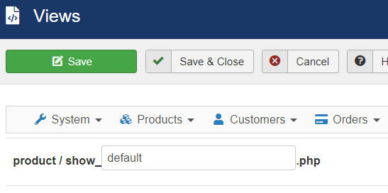

Since I am a little concerned about breaking something but accident, I am going to take these questions one at a time to confirm my understanding.
Here (see screenshot), to save a new layout, I just overwrite "default" to whatever name I want to use.
Correct? (I was looking for the usual Joomla option to "save file as.")
And then, how do I apply the new layout to my multipurpose product?
Like, will it show up here?
Thank you!
-Jim Gribble

That's correct. When you edit a product you have a "page layout" setting near the bottom to select that new layout you created.
