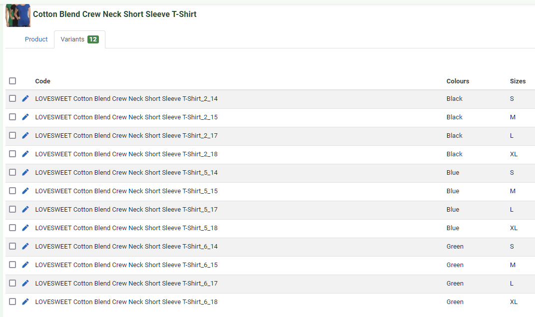

2 years 10 months ago #355677
I followed the instructions above and it worked fine. However, there is one issue.
When I go back to add more photos, I have to add it to all the sizes that was created.
Please see attached and advise if there is an easier way, because in this example, I would have to open 12 variants to add the photos.
Thanks!
  • Posts: 86089
  • Thank you received: 14195
2 years 10 months ago #355696
You could delete the size characteristic from the main product. That will mean you'll only have one set of variants, one per color.
Then, edit each color variant, and then add back the size characteristic, and duplicate again the variants.
Etiher this, or you need to edit each variant.
