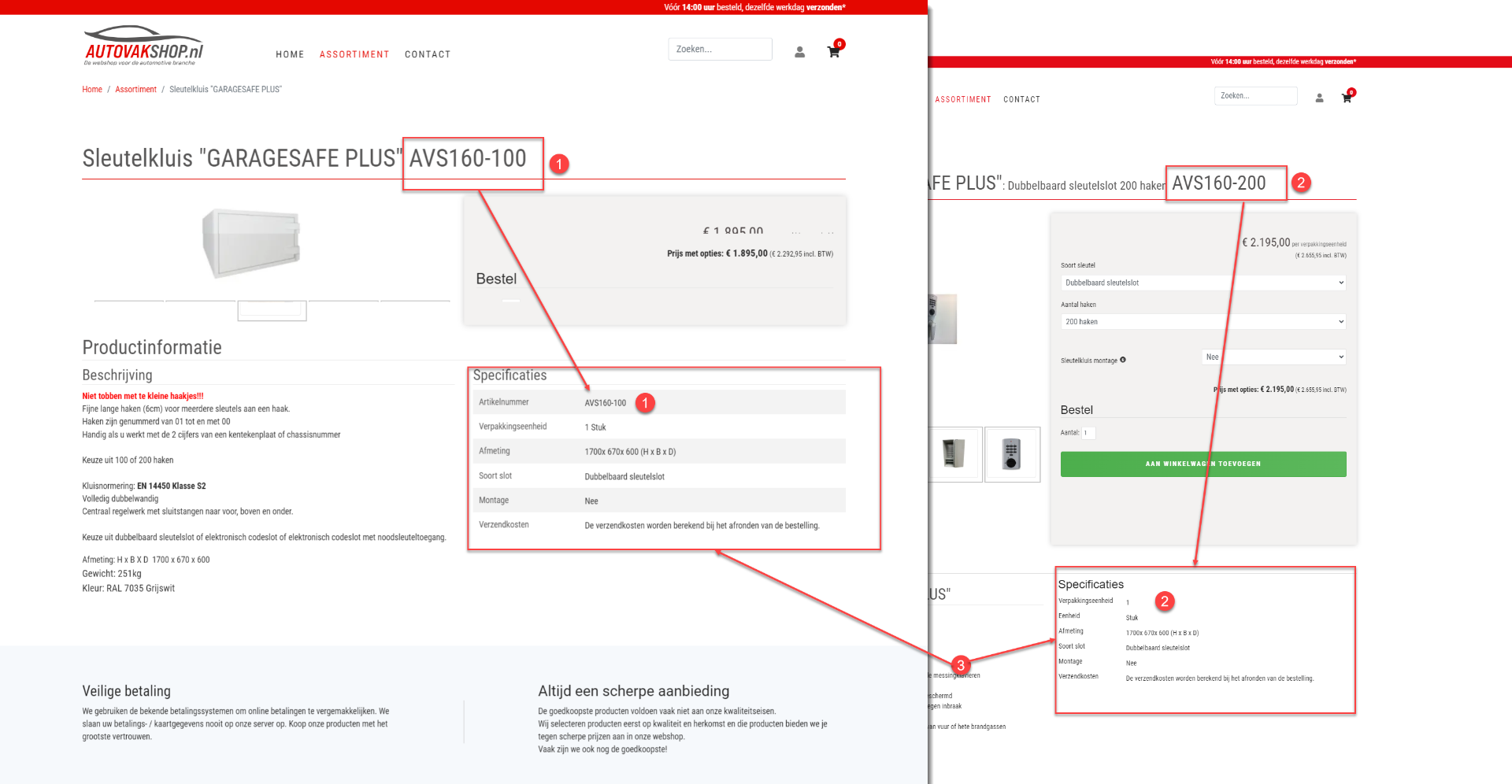

2 years 11 months ago #353996
I understand what you are saying, but if you look at the picture, you see at the left part of image (the basic produc) with the correct articlenumbers on both position(number 1).
In the right part of the right part of the image I have have choosen an other instead of 100 haken now 200 haken. The title is changed and i see the artivle numer. But the specifiaction box I don't see the article number. (block 2).
Also the markup for the specificationbox is changed (3).
SO question: how can I get the article number on bothe places and how can I be sure that the specification box is not changed?

2 years 11 months ago #354001
Ok, I didn't see the product code in the specifications area.
So, here is what I can say about this product code in the specifications area:
- HikaShop doesn't display the product code in the specifications area by default
- This display has potentially been added thanks to a custom field of the table "product". In that case, you need to edit each variant of the product and properly fill the product code in that custom field. Otherwise, if a custom field is empty in the variant, HikaShop will automatically use the value of the parent.
- This display might have been added with some custom code in the product / show_block_dimensions via the menu Display>Views. This is fine for products without variants, but for products with variants, this view is only used for the default variant. For other variants, you need to do a similar modification in the product / show view file.
