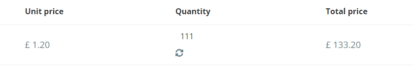

  • Posts: 4
2 years 10 months ago #354236
Just one issue remains, they could over-ride the qty in the cart, can I make the Quantity field read-only for example or change it to a drop-down or plus and minus boxes?
Screenshot attached
  • Posts: 85796
  • Thank you received: 14090
2 years 10 months ago #354242
The alternative method I proposed in my previous message will make all the quantity inputs as dropdowns with the same increment. So it would be a quick and easy solution.
Making the quantity read only on the checkout is easy too. Go in the HikaShop configuration page, and under the Checkout tab, change the setting "read only" of the "Cart" view.
  • Posts: 4
2 years 10 months ago #354256
Amazing, thank you. Works!
