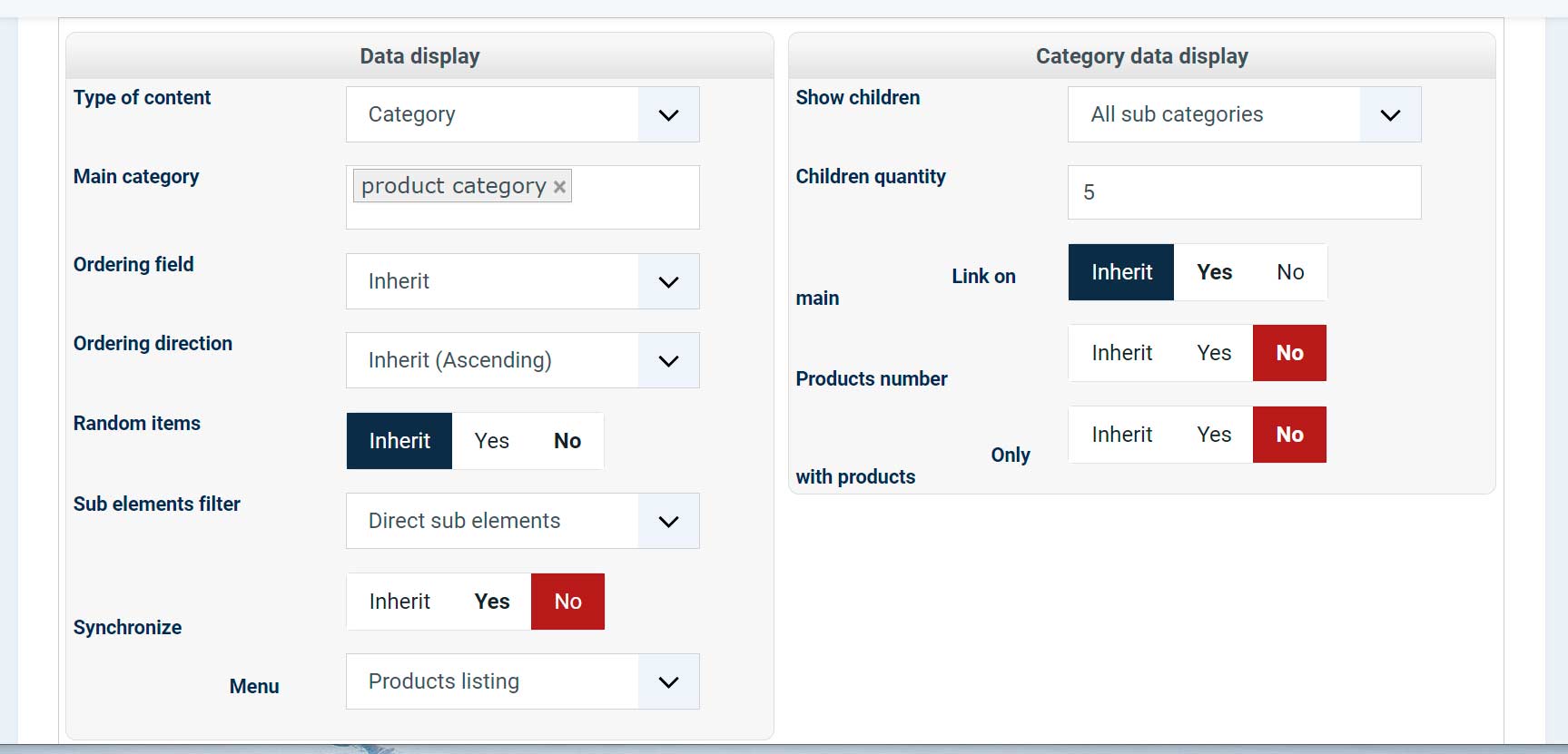

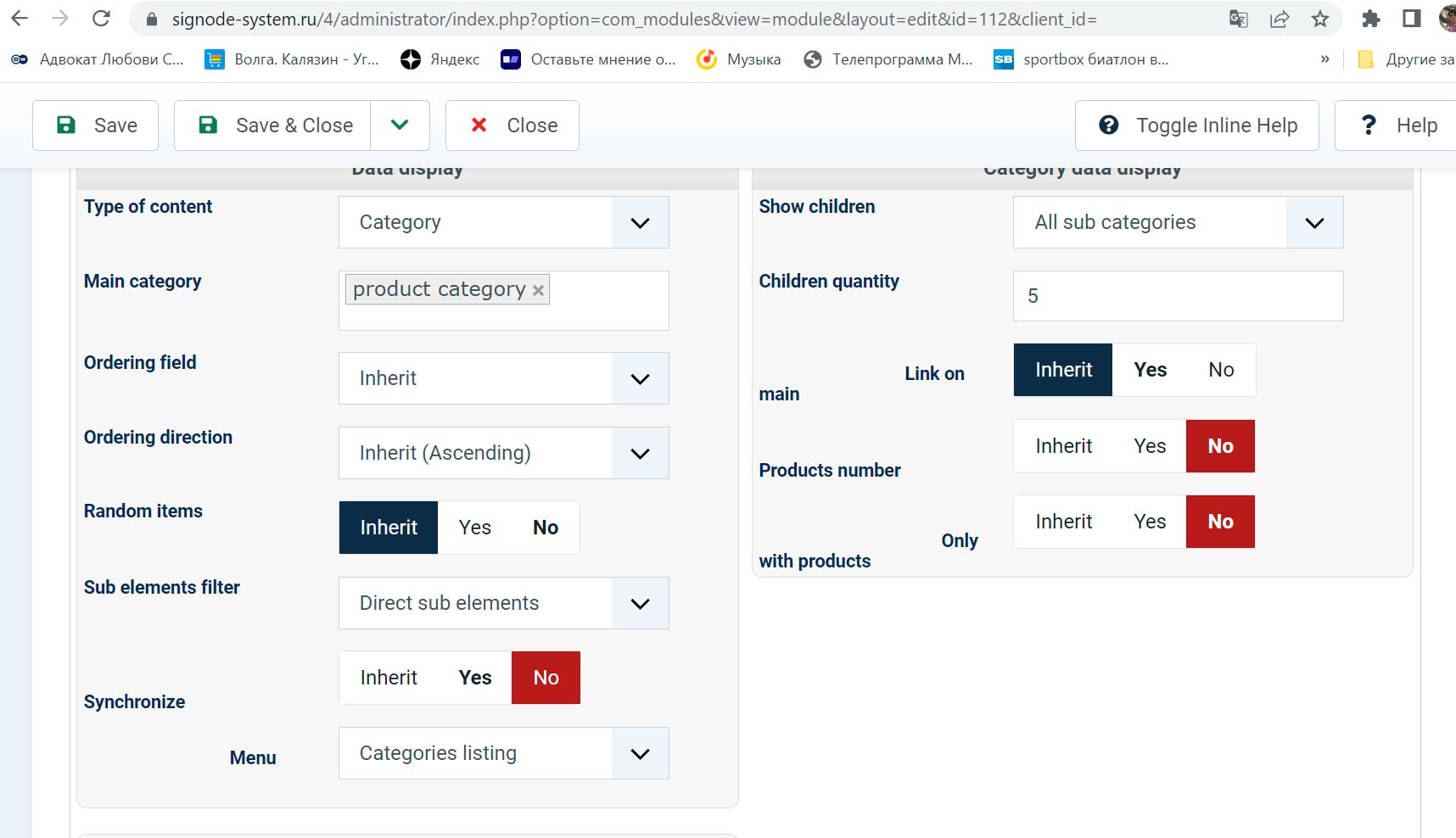

  • Posts: 13
2 years 11 months ago #354958
Hi, Nikolas! Thanks a lot for your answer!
1. Do you mean it - see screenshots 1 and 2? As you can see, synchronization is disabled, but nothing has changed - only titles are displayed on the subcategory pages. Or something else you had in mind?
2. 2. Yes, SEF URLs are already generated everywhere on my website. But I would like to change the look of the link. For example: Categories on 1 level module generates links signode-system.ru/4/hikashop-menu-for-pr...ting/16-kolding.html
And here is a link to the same page generated by the system: signode-system.ru/4/produktsiya/kolding.html .
Is it possible to change the look of the link generated by the module to make it the same? Well, or at least remove the long part, for example signode-system.ru/4/16-kolding.html ?
3. Descriptions connected, thanks.
I didn’t understand point 4, but it’s probably not necessary now, right?
  • Posts: 86089
  • Thank you received: 14195
2 years 11 months ago #354960
1. Could you provide screenshots for all the settings under the HikaShop options tab of the module ?
2. As I said in my point 3 in my previous message, you need to select "produktsiya" in the "menu" setting.
I can see you didn't do it on your second screenshot.
This will fix what you're talking about in point 2.

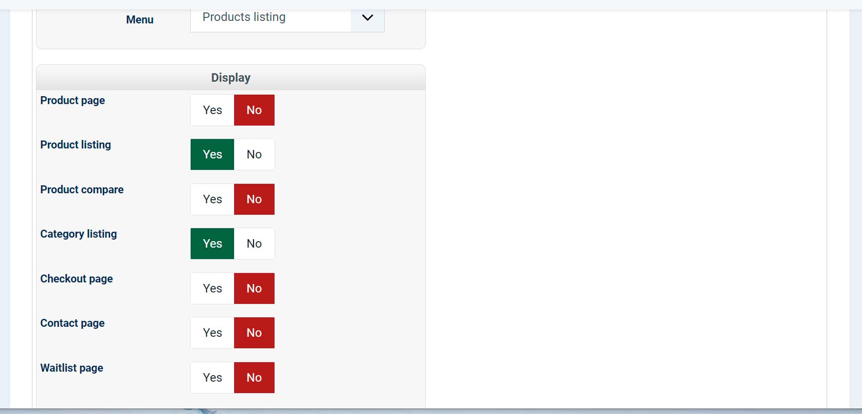

  • Posts: 13
2 years 11 months ago #354966
Hi, Nicolas!
1. When I took screenshots, I saw the Display settings at the bottom. They were all disabled. I have enabled the Product listing and Category listing options. It became much better, but! Now, when opening pages from the module, descriptions are everywhere, but there are no subcategories. At the same time, when opening from the main horizontal menu, there are subdirectories.
For example:
call from the module menu signode-system.ru/4/hikashop-menu-for-pr...ting/16-kolding.html
call from main menu signode-system.ru/4/produktsiya/kolding.html
2. Excuse me, in fact, I chose “produktsiya” based on your advice, it’s just that I made the screenshot earlier.))
Last edit: 2 years 11 months ago by catsub.
  • Posts: 86089
2 years 11 months ago #354968
No worries, but "products listing" is still not the one you need to select there. It's "Продукция" you need to select, the menu item with the alias "produktsiya". The "products listing" menu item is the one with the alias "hikashop-menu-for-products-listing"
And that's why you get URLs with "hikashop-menu-for-products-listing" instead of the URLs you want.
Once you get the URLs you want, you'll also have the display you want when you click on the categories of the module.

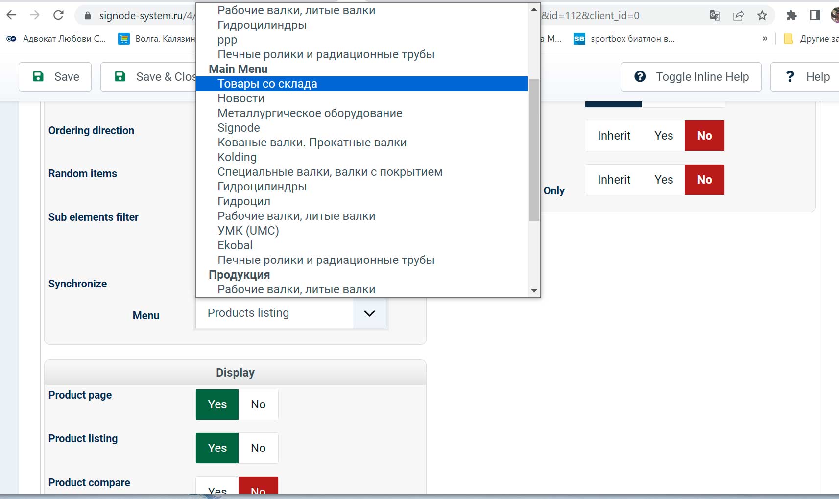

2 years 11 months ago #354986
Hi, Nikolas! Thank you for your help to me!
Do you mean this menu - see screenshot?
This menu is not formed correctly. There is no "Products" item in it. There is a name for a separate menu “Products”, but this name is not clickable.
Here is the first level of the main menu:
home
About company
Products
News
Contacts
Of these, in the main menu generated by the module, there is only News, which is why I cannot select the Products item.
How is this menu formed, can I reformat it?
  • Posts: 13
2 years 11 months ago #354989
Hi, Nicolas!
While you had the weekend, I experimented. I have a Products menu, but I haven’t used it on the site yet. I inserted the Products item into this menu and used it in the module.
In general, everything worked, but this is an incorrect way. The question is still relevant: why the main menu is displayed incorrectly in the module and how to fix it.
And I still don’t understand how to change the style of the “Categories on 1 level” header, for example here signode-system.ru/4/produktsiya.html
