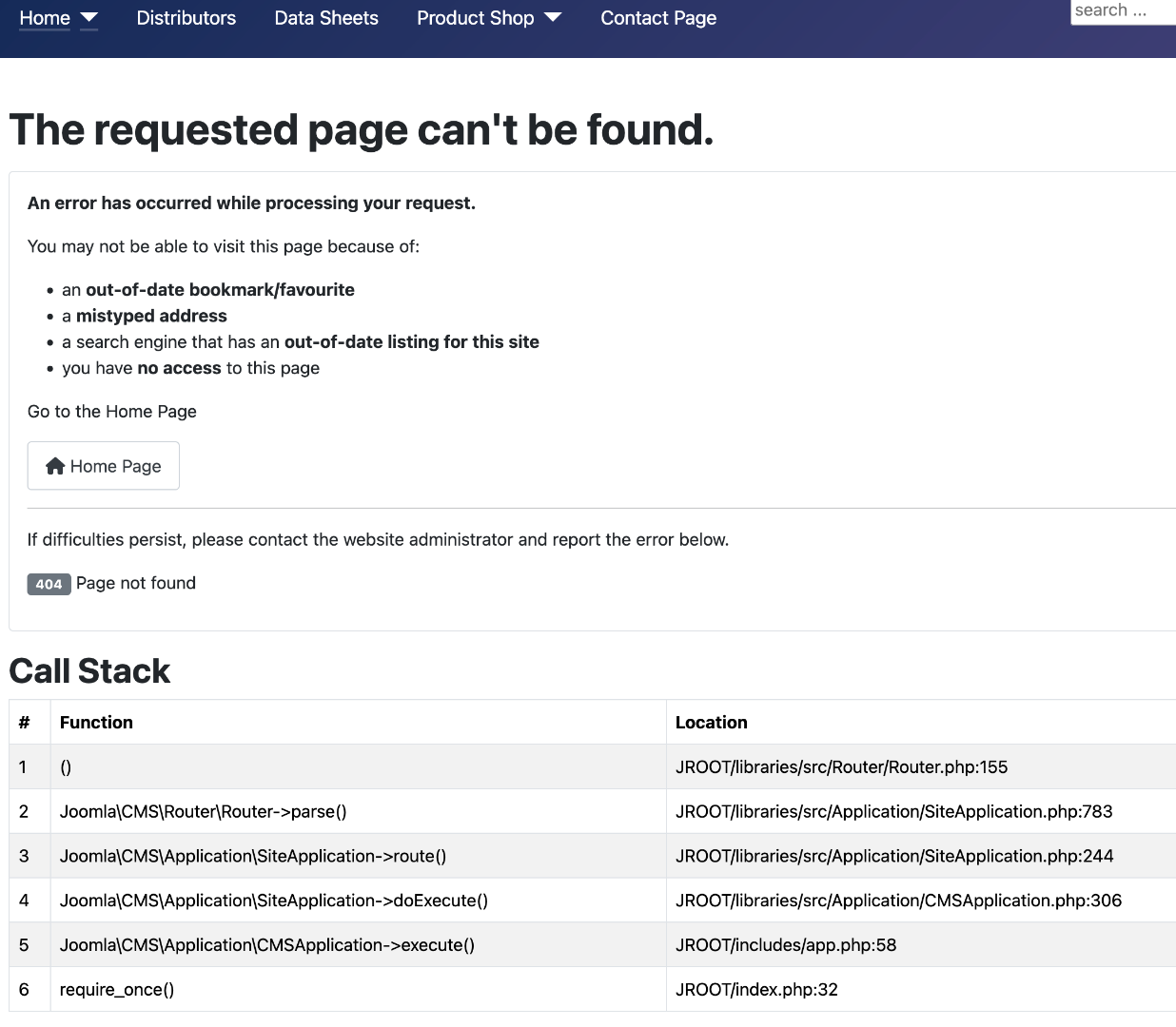

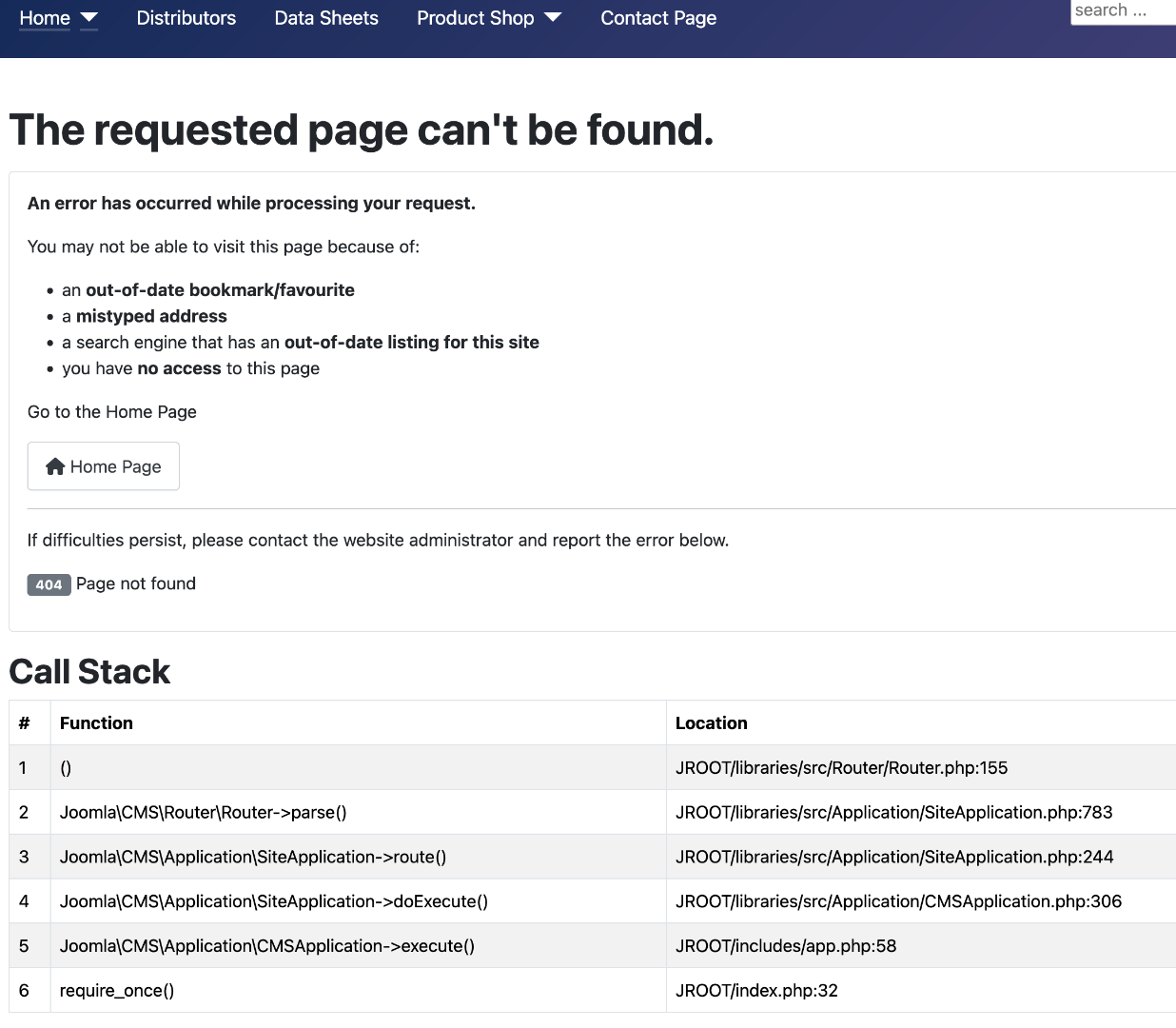

Could you activate the debug setting of the Joomla configuration and access the 404 error page of a category ? Could you provide a screenshot of what you see ?

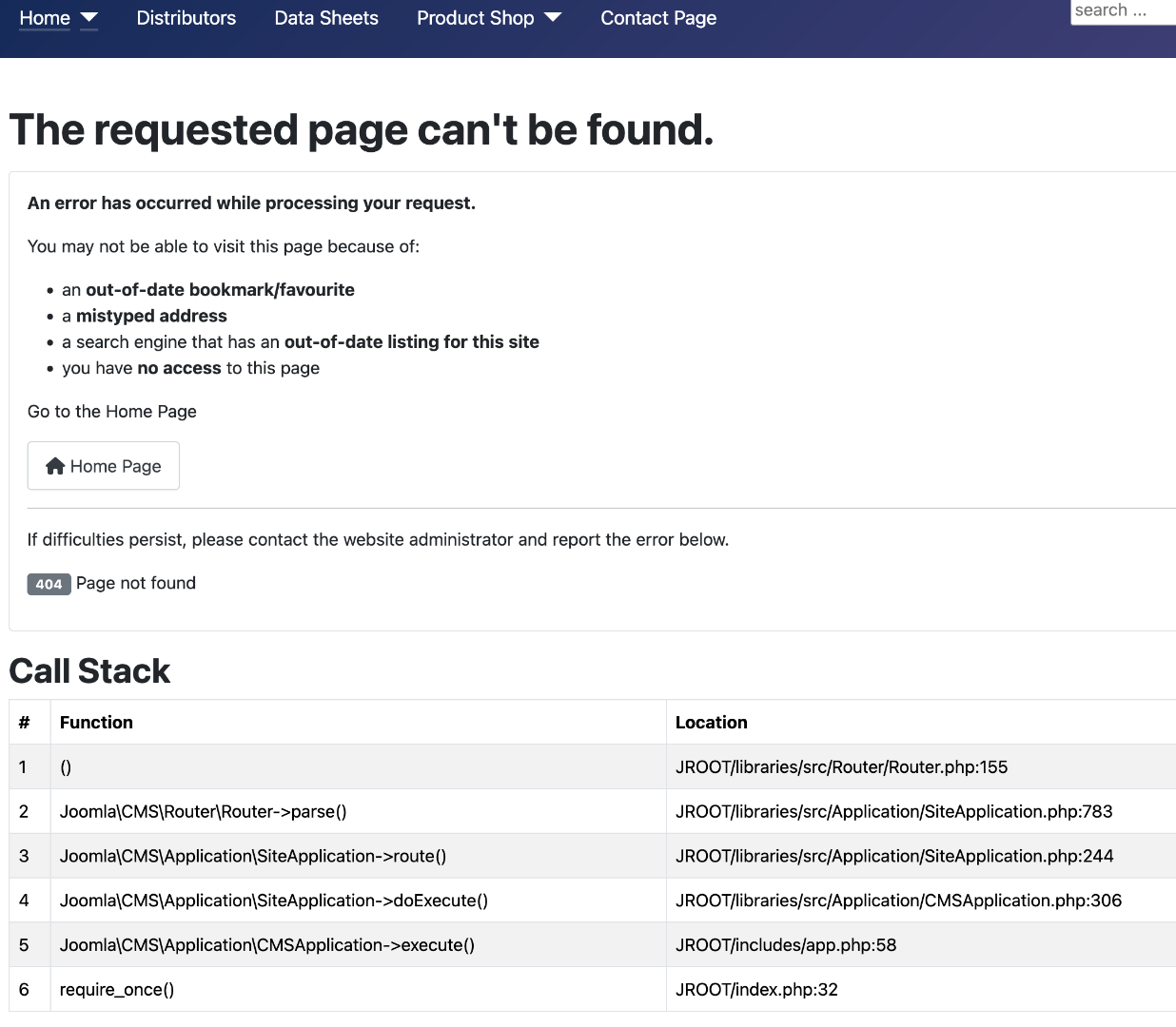

I have enabled the error reporting for this first larval category
https://taab1:8890/taab/product-shop/category/14984-chemicals
Error message as attached image
Tony

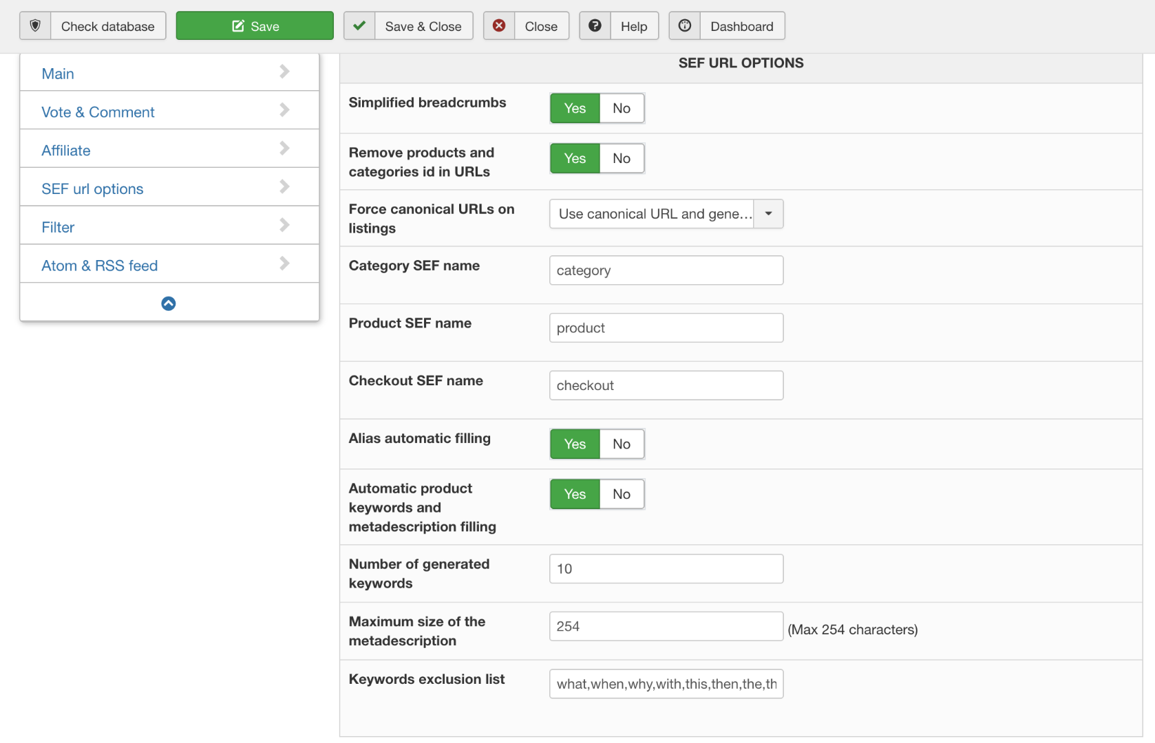

1 year 3 months ago #365987

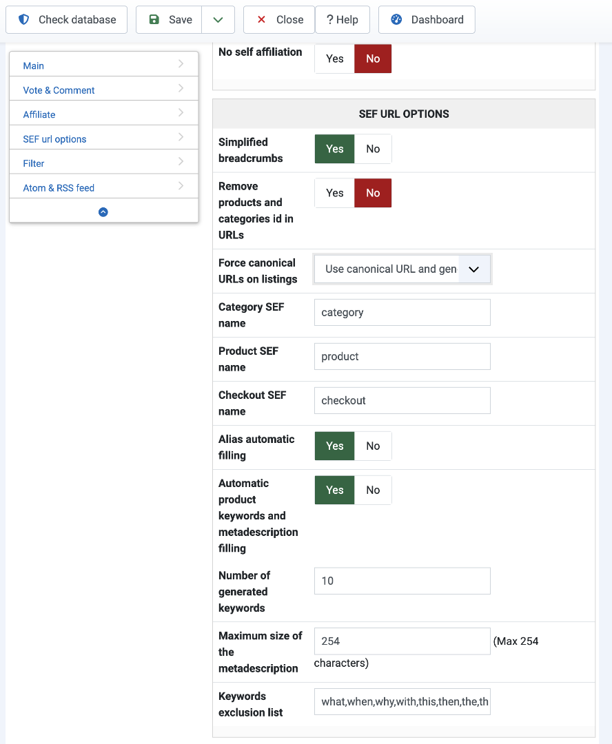

Do you have some kind of SEF extension, like SH404SEF ( 4SEF ), or JomSEF, or others ?
Something strange with your results is that even on the live website, some URLs don't have the id of the category in the URL (like the beakers ptfe). Normally, either all of them should have the id or none of them.
This indicates that you probably activated the "force canonical URLs on listings" setting of the HikaShop configuration:
www.hikashop.com/support/documentation/5...ig.html#features_sef
And in that case, the URL used is the "canonical URL" that you configured in the settings of the category, even if the URL there is invalid. And so, if you setup a category with a canonical URL using the alias of a menu item, and that something changes with that menu item or with some SEF settings, the URL would then generate a 404 error.
For example, I can see that you have the "category SEF name" setting set to "category" on your live website. If you changed that setting on your local website, then all the canonical URLs of the categories with that "category" SEF name would be invalid instantly.

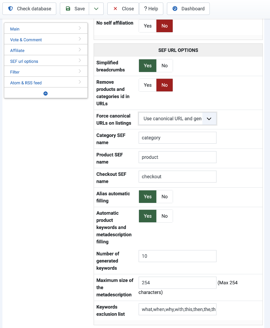

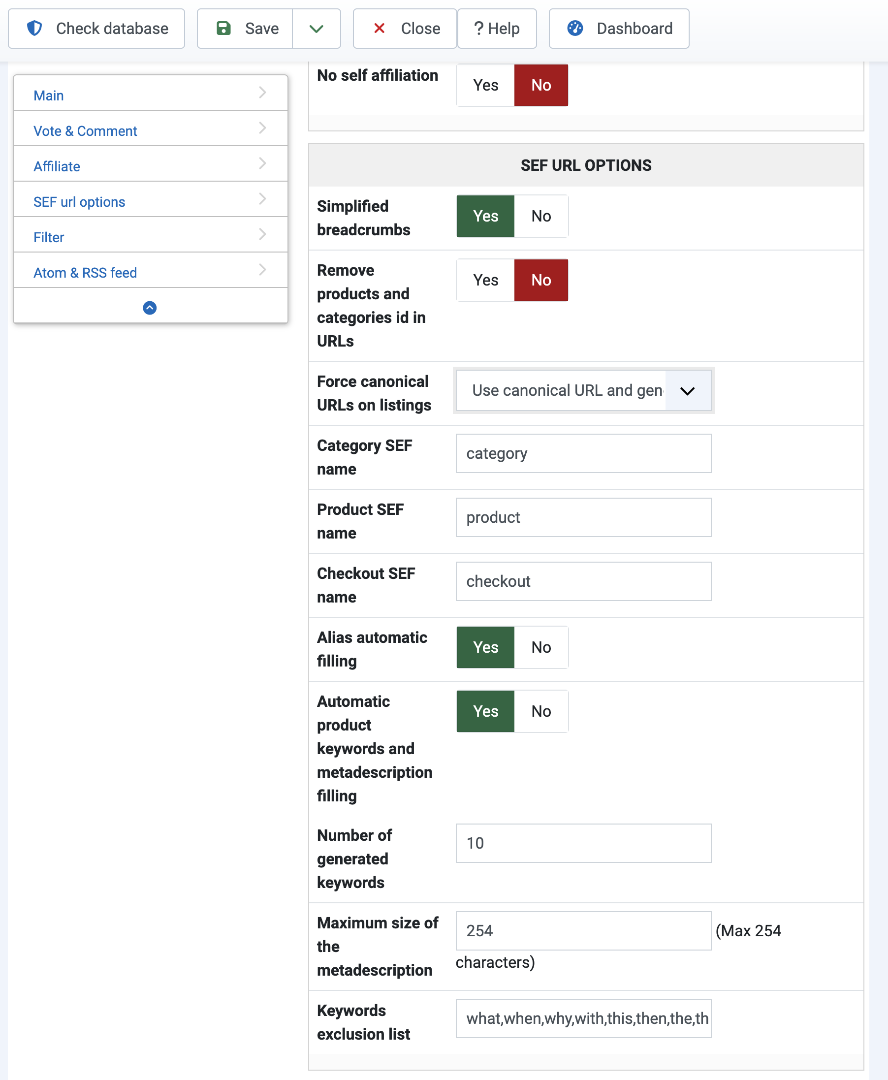

Could you provide a screenshot of the "SEF" section of the HikaShop configuration page on your local website ?
What if you empty the "canonical URL" of a category and then refresh your frontend, and access that category ? What URL is now used ? Do you still have the 404 error ?

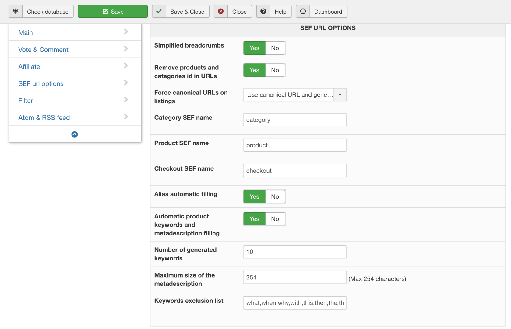

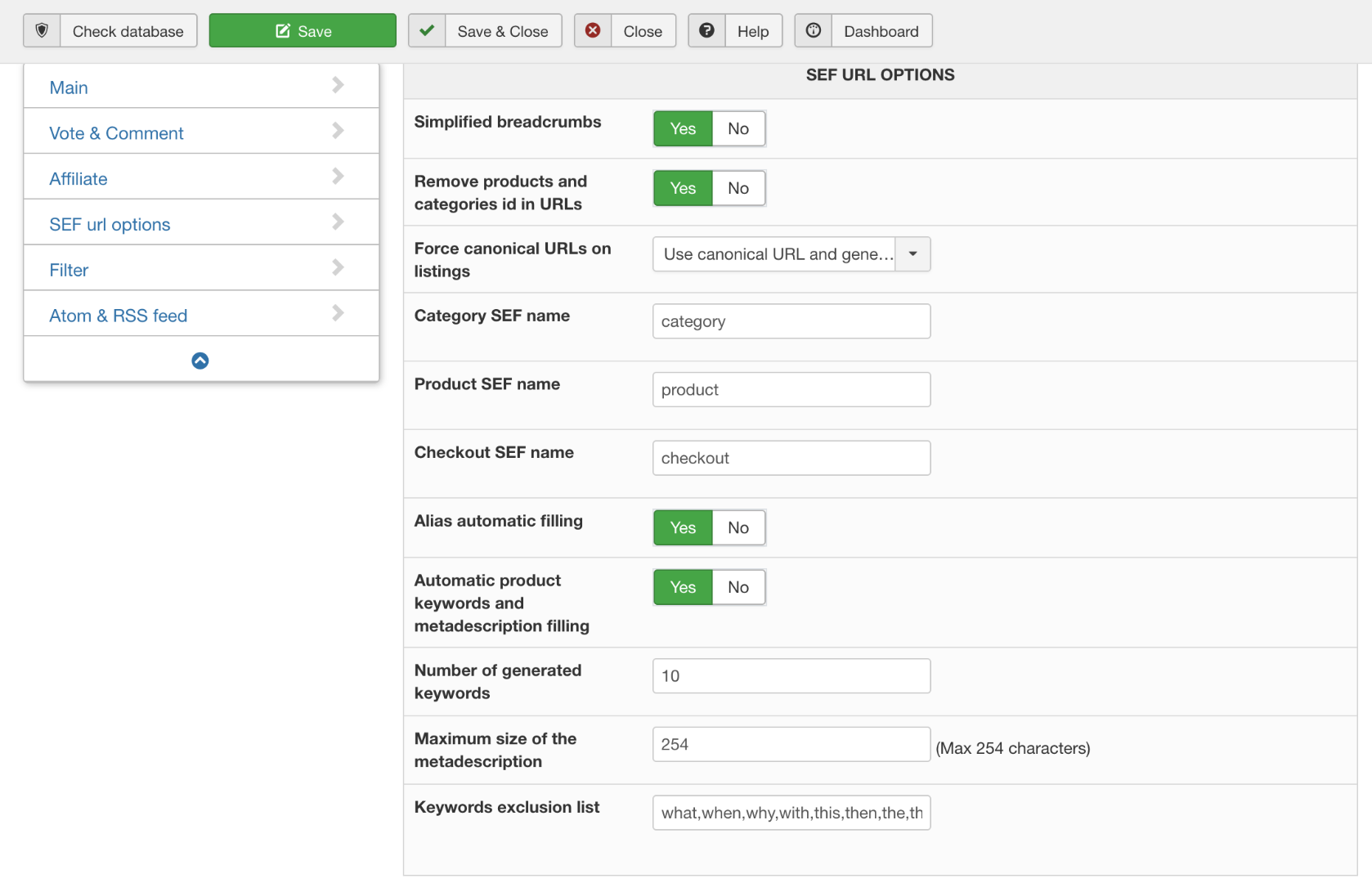

  • Posts: 38
1 year 3 months ago #365988
Hi Nicolas
I think you may have found the issue..
I do not think I have any SEF extension (at least not deliberately)
I have removed the canonical URLS as suggested and these changed items:
Category > sub-category > product. These now all work
I have attached the screen shot for the live site and for the local site.
Thanks for the quick reply
Tony

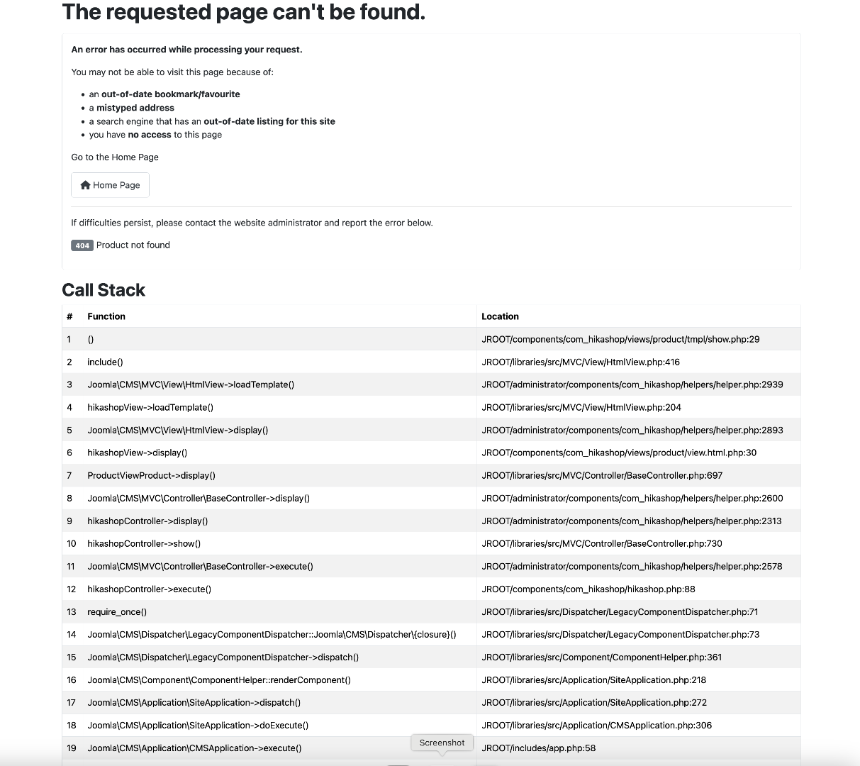

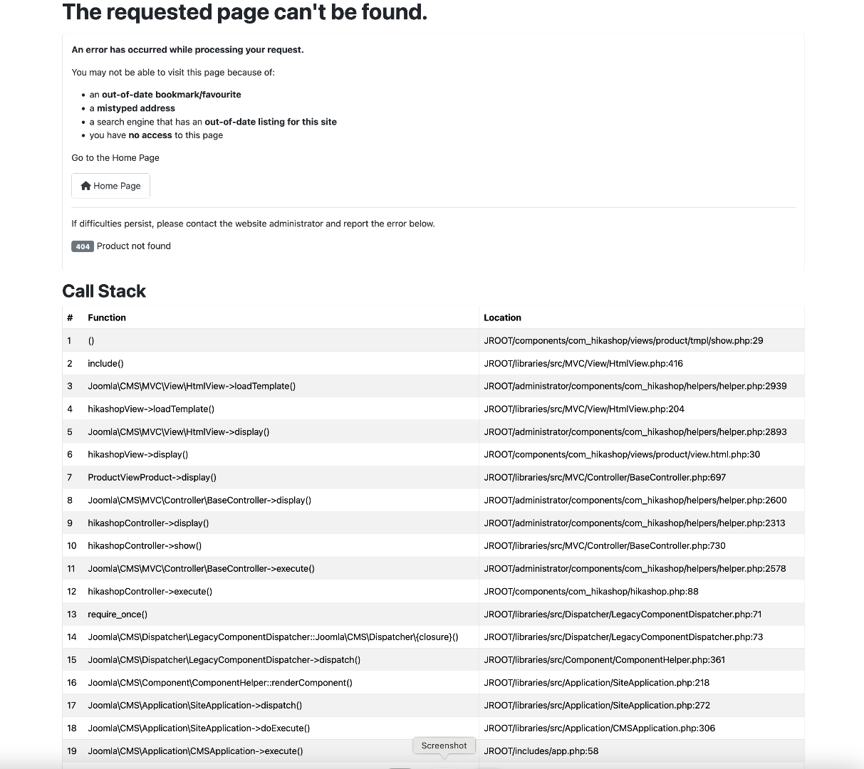

  • Posts: 38
1 year 3 months ago #365989
Hi Nicolas
I also included a screen shot of the local site
Product shop
> Product page.
error message.
Tony
  • Posts: 85796
  • Thank you received: 14090
1 year 3 months ago #365993
Great, we're moving forward.
For the product page, do you also have 404 errors for all the products ?
Do you have canonical URLs for all the products too ? If so, what if you empty the canonical URL of the product ? Does it help ?

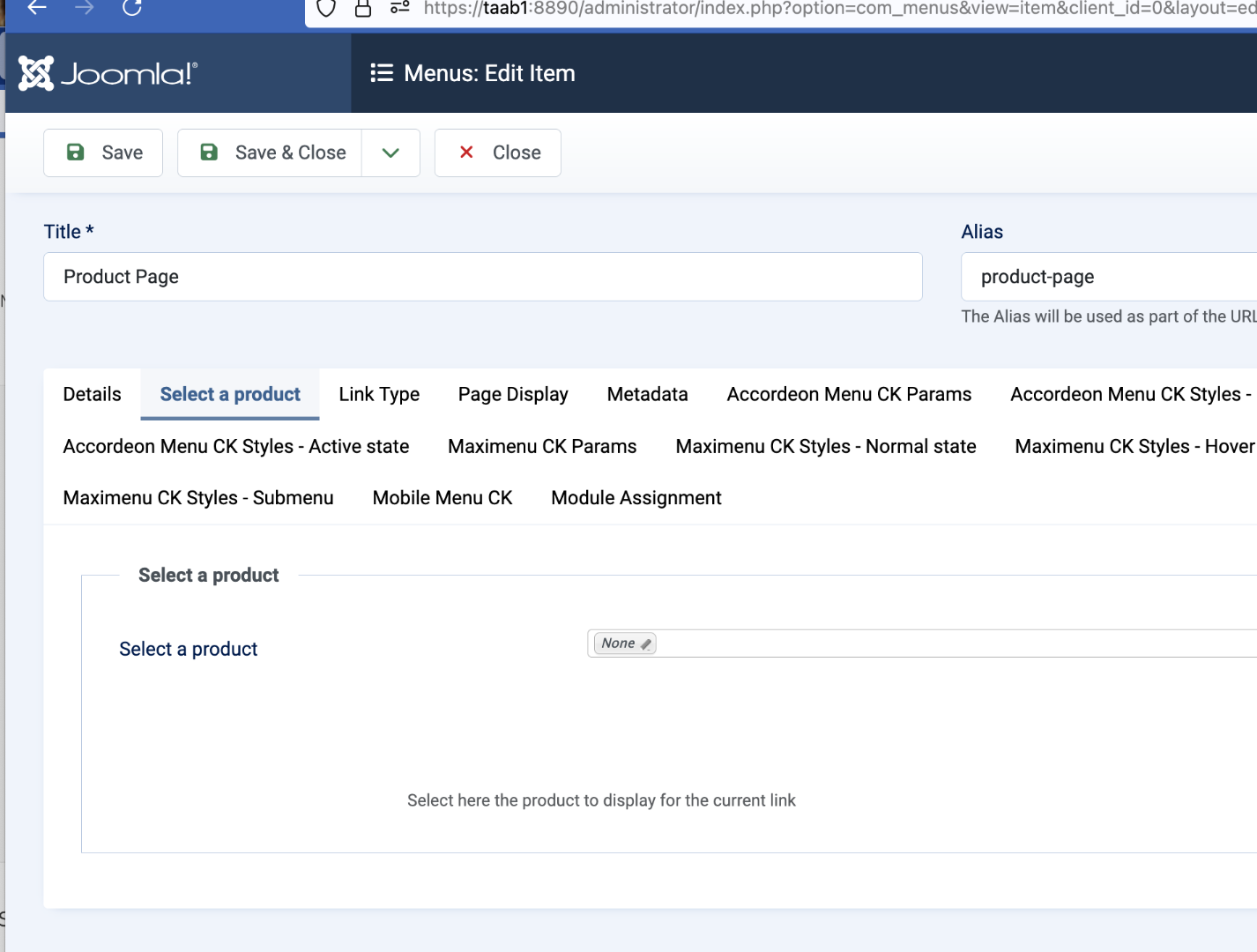

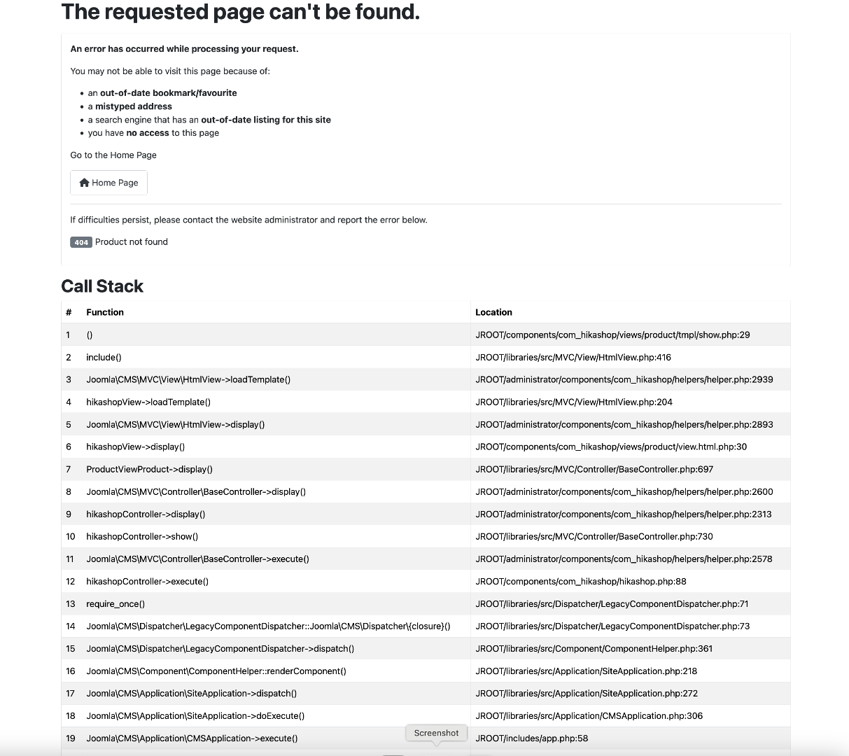

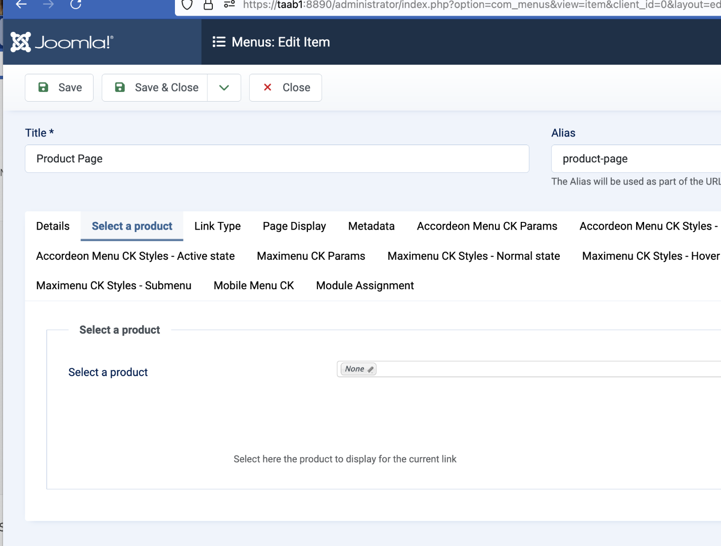

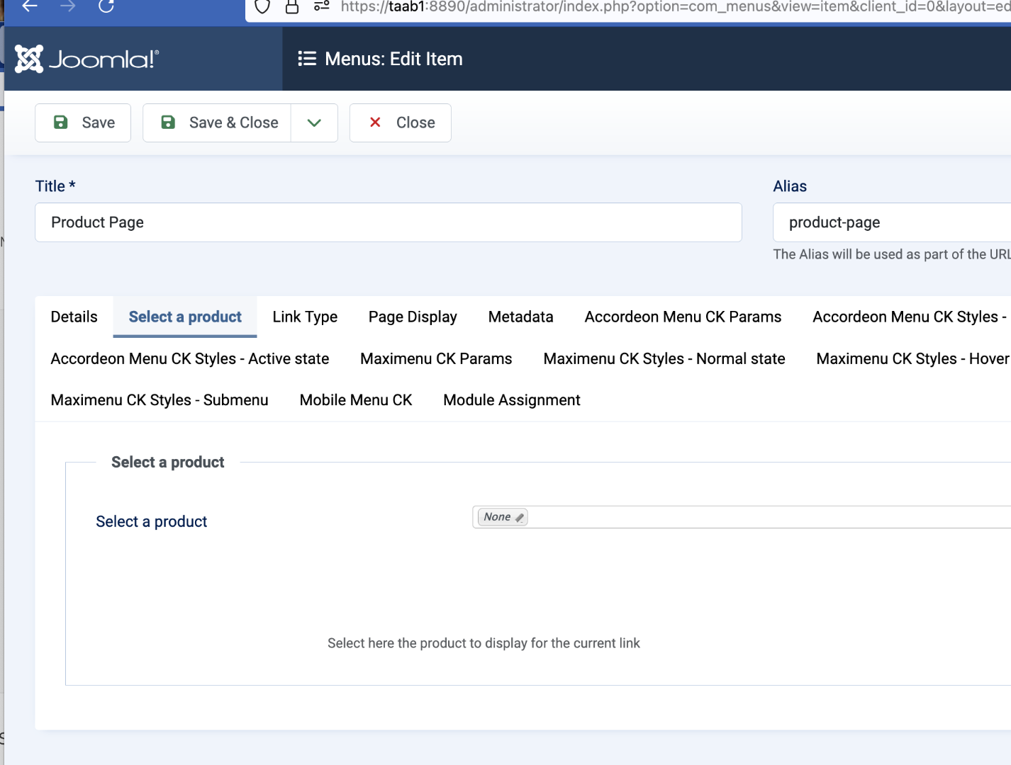

  • Posts: 38
1 year 3 months ago #365998
Thanks for the update.
The product-page is essentially the same as the product listing page.
It would seem that this "product-page" is miss-configured - image attached.
Its probably easier to delete this menu item?

  • Posts: 85796
1 year 3 months ago #365999
- Indeed, you need to select a product in the "select a product" setting. Without any product selected, it's normal that you get that error.-
You probably don't need this menu item. So yes, I think you can just delete it.
