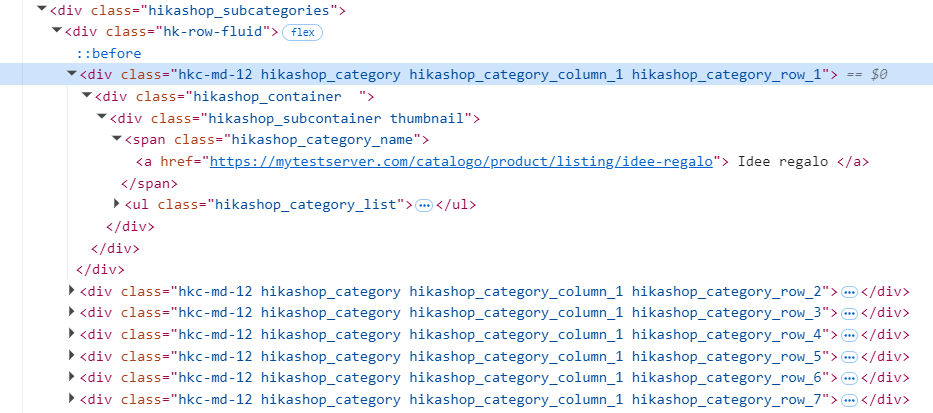

As far as I can see, active (or current) classes are missing for hikashop_category_name items too. They should be active when directly selecteded or when a child is selected.
Am I wrong?

I meant that there is no distinction between a selected parent category and an unselected one, whatever the class to distinguish them. The class is always just "hikashop_category_name" (please find attached pics).
The distinction is only between selected children categories and an unselected ones.

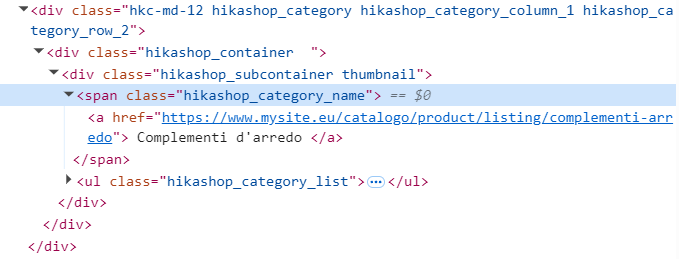

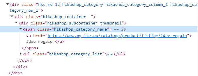

there's no div with hikashop_current_parent_category class in the page, event clicking on "Idee Regalo". Where did you get it from? :)
Please, delete the picture because it contains the url of my test server.
Thanks! ;)
