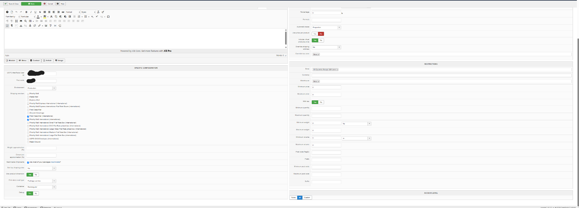

I have attached ma scrren shot of my international USPS settings, this is my only published international mail.
Let me know if you see a problem that would have jacked up the price or if there is a way to test. I can create
Attachment not found
orders and all looks good but I cant see wht the final paypal charges look like. Everything did and does look fine to me. But as I said the International order was charged over 100$ more than the 2 USPS options showed in my tests and inb the debug,
I also still;need to figure out the email stuff. Whatever I did last time really through my site for a loop.
If I can get these 2 things done I will be out of the woods and should be out of your hair.
Thanks for the time

2. Regarding the settings of the shipping method, note that if the "Automatic taxes" is not set to "no", HikaShop can potentially add taxes to the shipping cost returned by the shipping carrier based on how your tax rules are configured.
So, if you want to get the same shipping cost as what's returned by the shipping carrier, you want to set that setting to "no".
On your screenshot, I don't see the "price" setting. Make sure it is empty. If it's set to "100" for example, it would add 100 to all shipping costs returned by the carrier.
Also, if you check an order in your backend order manager, can you confirm that the extra 100$ you see is in the "shipping" fee, and not another extra fee (like for example a coupon with a negative percentage or negative value, which would effectively add cost to the order) ?
Besides these, I don't see what else it could be with the information you've provided so far.
