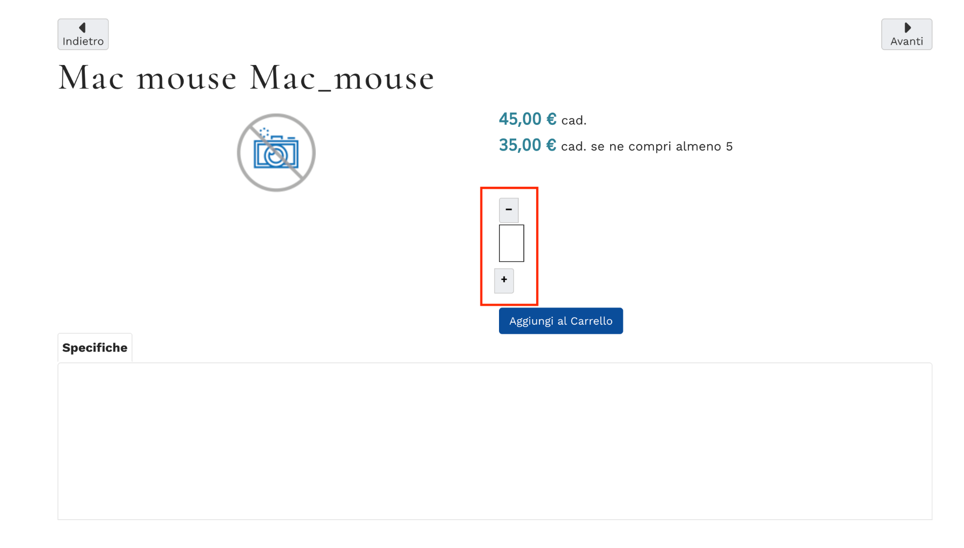

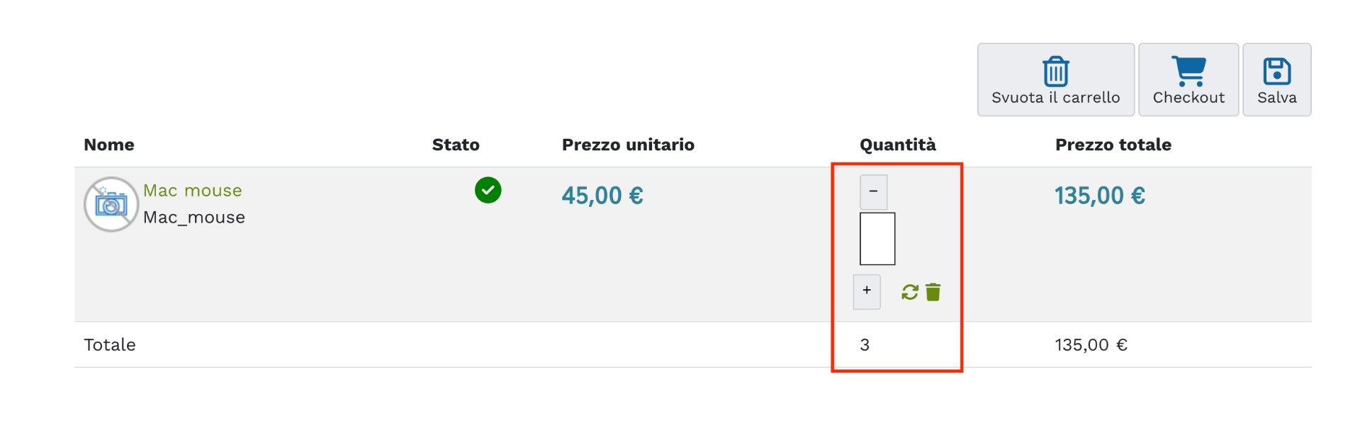

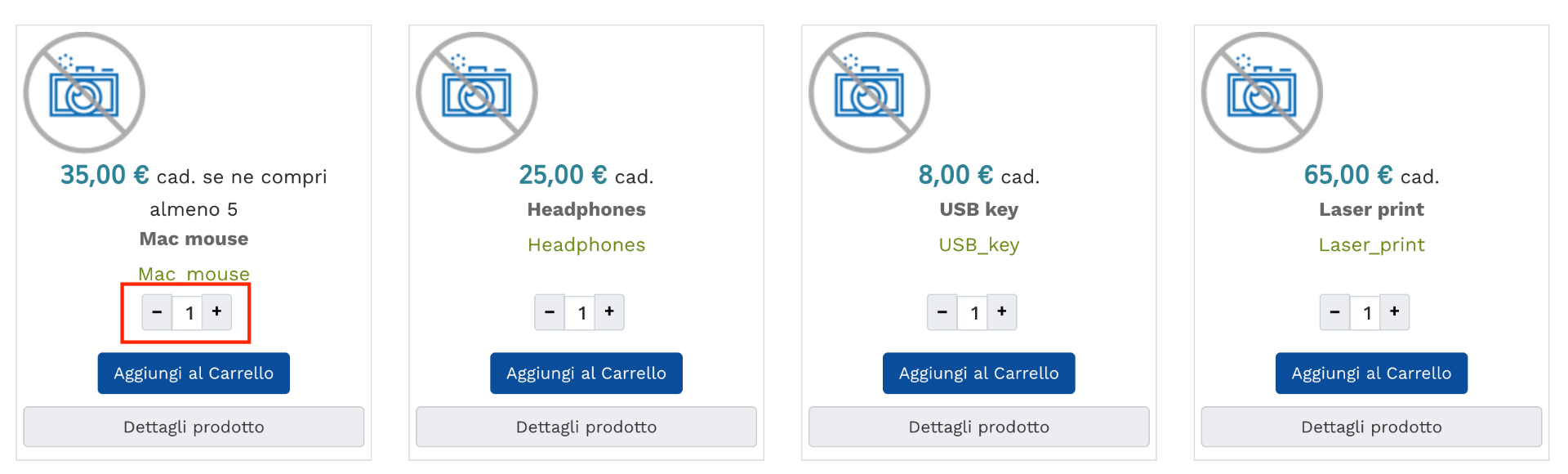

-- HikaShop version -- : 6.1.1
-- Joomla version -- : 5.4.7
-- PHP version -- : 8.2.3
The quantity field is visible correctly on the category page with product list. (Screen 1) But it is visible with the incorrect alignment of the -+ buttons on the product page and in the cart, and, above all, it does not include the number in the central field (screens 2 and 3).

8 months 2 weeks ago #369716
I stand corrected. The quantity selection doesn't work on the product page. I mean, you can select the quantity, but the price doesn't change.
However, if you add it to the cart, the price is correct there.
This is a problem, so please find a solution.
I repeat, it's not a CSS issue.
  • Posts: 86083
  • Thank you received: 14194
8 months 2 weeks ago #369714
I still think the problem is a CSS issue caused by the template.
It's common for template providers to add padding for input fields. However, with the width of the quantity input field being quite small, the padding can lead to the number in the input field not being visible.
You can try with Cassiopeia, the default template. It doesn't have padding on the input fields and the quantity input field will display fine there.

8 months 2 weeks ago #369720
Okay, I solved the display issue by removing the padding from the field where the number appears.
The issue with updating the price when the quantity is changed remains.
It doesn't change on the product page. Is this correct, or should the total price change?
It does, in fact, change in the cart. Let me know. Thanks.
