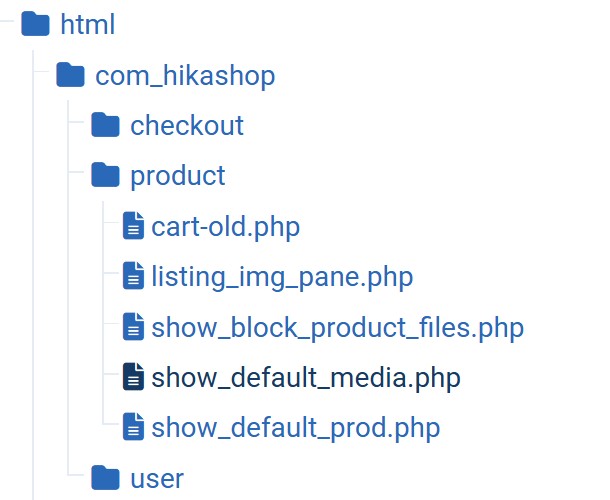

  • Posts: 431
  • Thank you received: 22
7 months 3 weeks ago #369920
I dont have that file in overrides. I have some overrides, but not using it with that product.

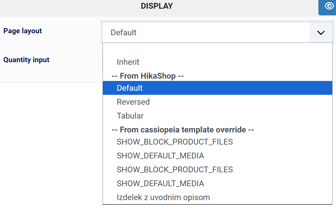

  • Posts: 431
7 months 3 weeks ago #369925
My template is just a fork from cassiopea. If I switch to original cassiopea, same problem.
No overrides in show_block_img.
