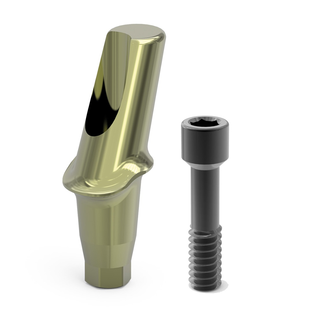

-- url of the page with the problem -- : nordicdental.dk
Hikashop cannot display this added picture in product.
Can you tell me why?
Br.
Peter
