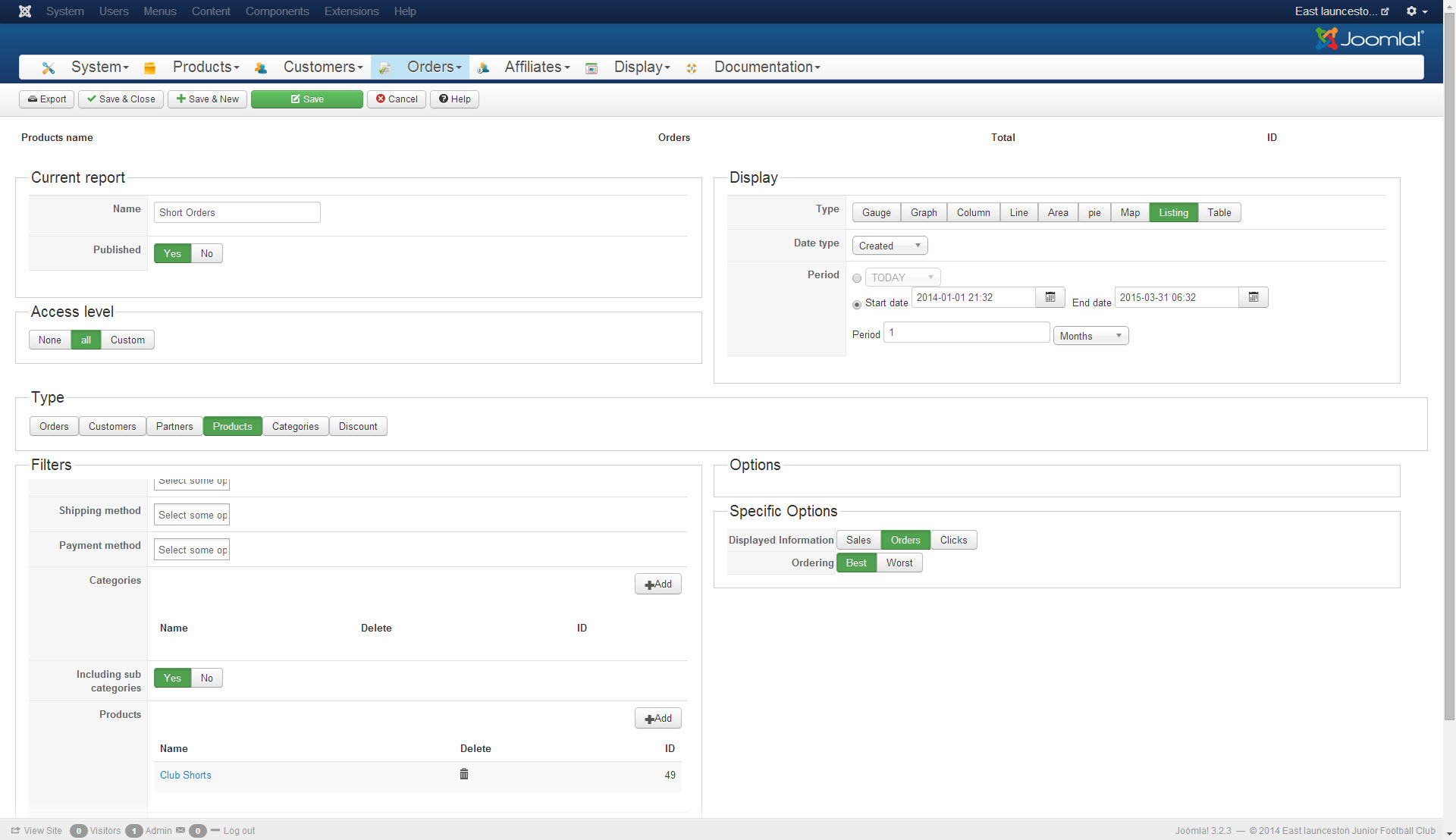

I have tried every combination and read the documentation and still a simple report showing amount of short sales is not working.
Check out the screen dump that shows the parameters I'm using in the back end.
Any ideas on what I'm doing wrong would be appreciated as I know we have had quite a few shorts orders already.

  • Posts: 86210
12 years 5 months ago #149413
It seems that Jerome didn't understand what you wanted to display.
From what I can see, there are two explanations for that result:
- there are no sales of the selected product in the period you selected.
- your product has characteristics. In that case, it's the variant which is registered in the order, not the main product and that's why the reporting doesn't find any product.
If you want to see the number of sales of all your products, it would be easier to create a mass action via the menu System>Mass actions on the product data with an action "Display the results" and the "product_sales" and "product_name" columns selected.

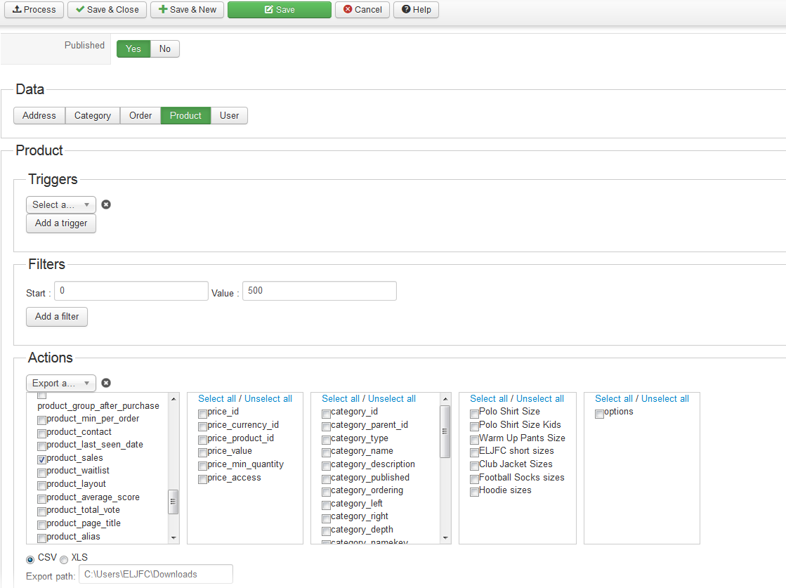

Ok so the mass action sounds like the solution as indeed we do have variants on the shorts i.e. short size.
So read documentation on mass actions and I can't understand how we actually get the parameters you describe added. When I type "Display the results" nothing matches?
  • Posts: 6
12 years 5 months ago #149532
Ok worked out plugin wasn't enabled.
But still having issues exporting CSV to PC place path in and process but not working?
Last edit: 12 years 5 months ago by eljfc.
  • Posts: 86210
12 years 5 months ago #149573
If you enter a path, the system will try to save the CSV file there.
Just don't enter any path and the system will then send you the file directly instead.

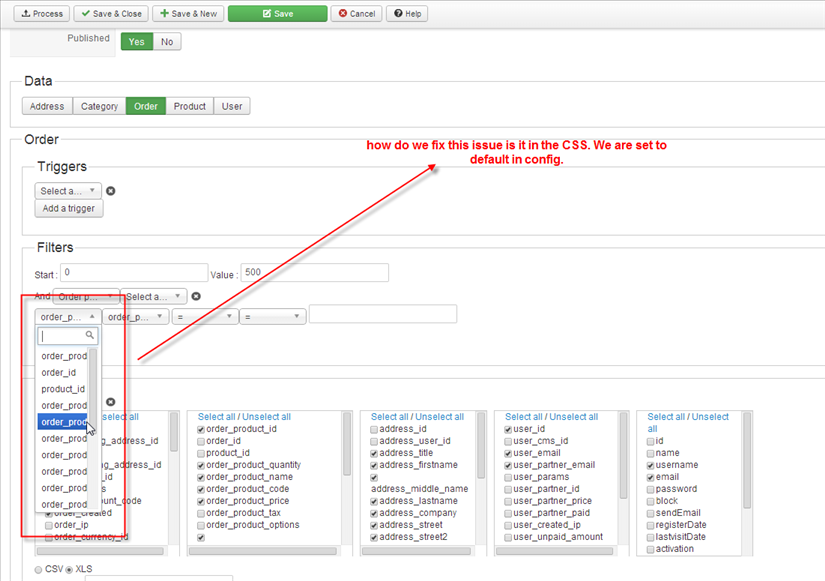

Ok so that works the only issue I have now that I'm learning how to use this feature is I appear to have a CSS issue as per below. Any ideas for a quick fix?
12 years 5 months ago #149935
More than a css issue, you have the elements twice.
What happen if you remove the current filter, and then add it again ? Are the following fields duplicated ?
If yes, thanks to try to install again HikaShop over the current installation.
There was maybe a problem during the first installation.
