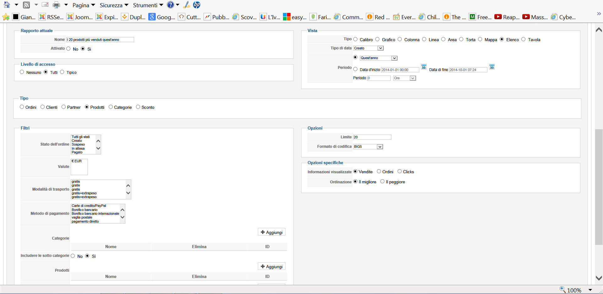

Thanks to give us a screenshot of you report configuration in order to try to reproduce the issue on our end.

here you are the screenshot.

11 years 11 months ago #173934
In the filter of this report you don't have selected an order status, so all the products of all the orders statuses are displayed.
Even products in cancelled, or created orders, so as you said it don't represent the sol products.
You just have to add more conditions in the filters.

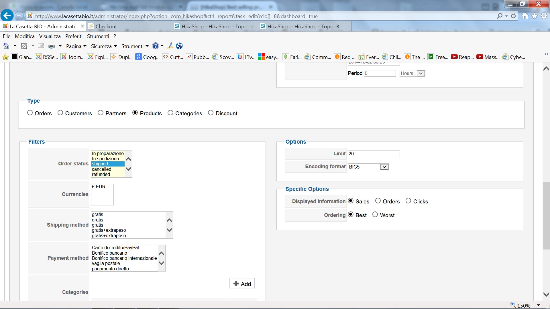

  • Posts: 719
11 years 11 months ago #174014
it was setted on shipped.
On the screenshot i did not scroll down the menù.
my site with Hikashop
www.lacasettabio.it

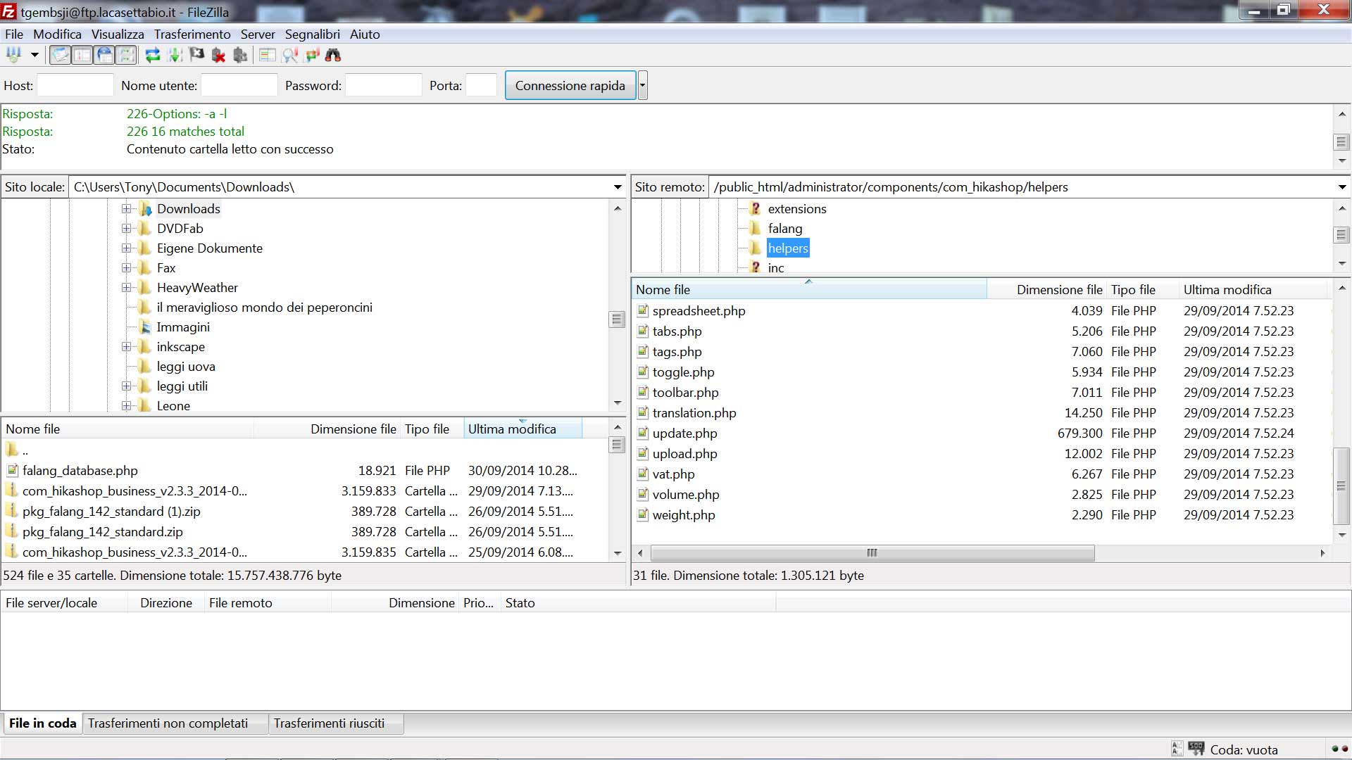

i'm sorry but i don't have that file, as you can see on the screenshot attached here.

11 years 11 months ago #174201
Jérome was talking about the file "administrator/components/com_hikashop/classes/widget.php"
