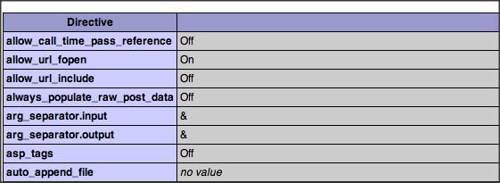

10 years 7 months ago #229784
it is turned on. I checked again with phpinfo (see image)
allow_url_fopen On
