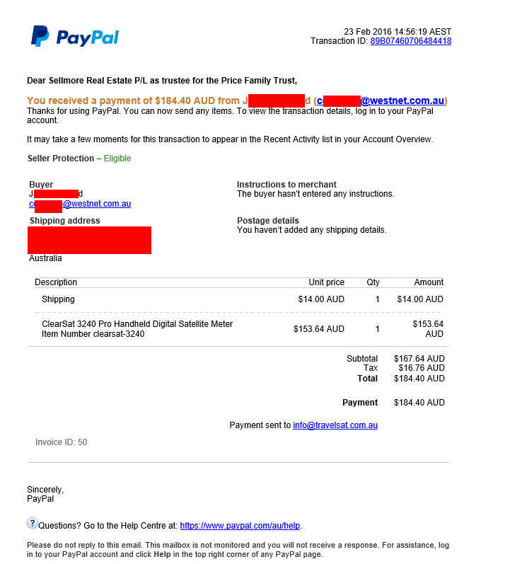

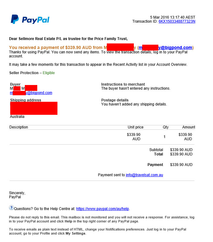

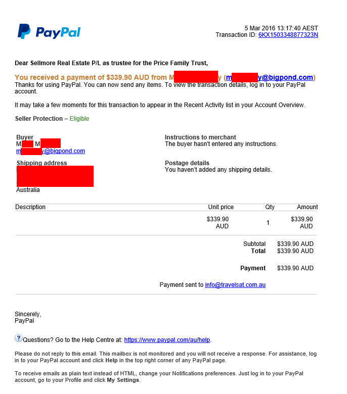

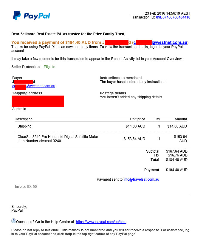

For some reason, on most transactions, the item description is missing from the PayPal receipt. The only order where is has actually displayed the product name in the description section is order number 50. In every other order there has been no information in the description section where the product name should be displayed. I have attached a copy of the receipt for order 50 and 1 another order where description is missing.

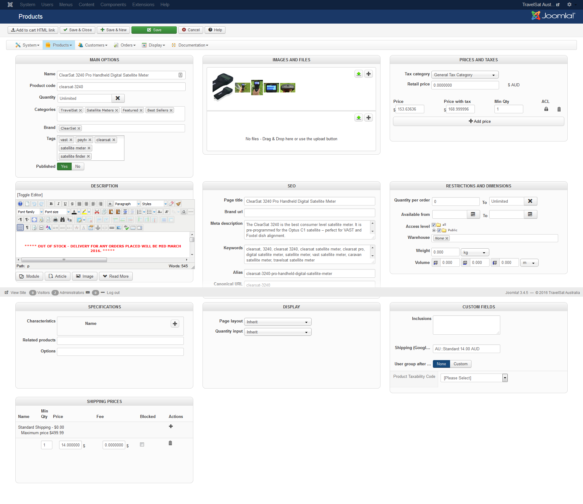

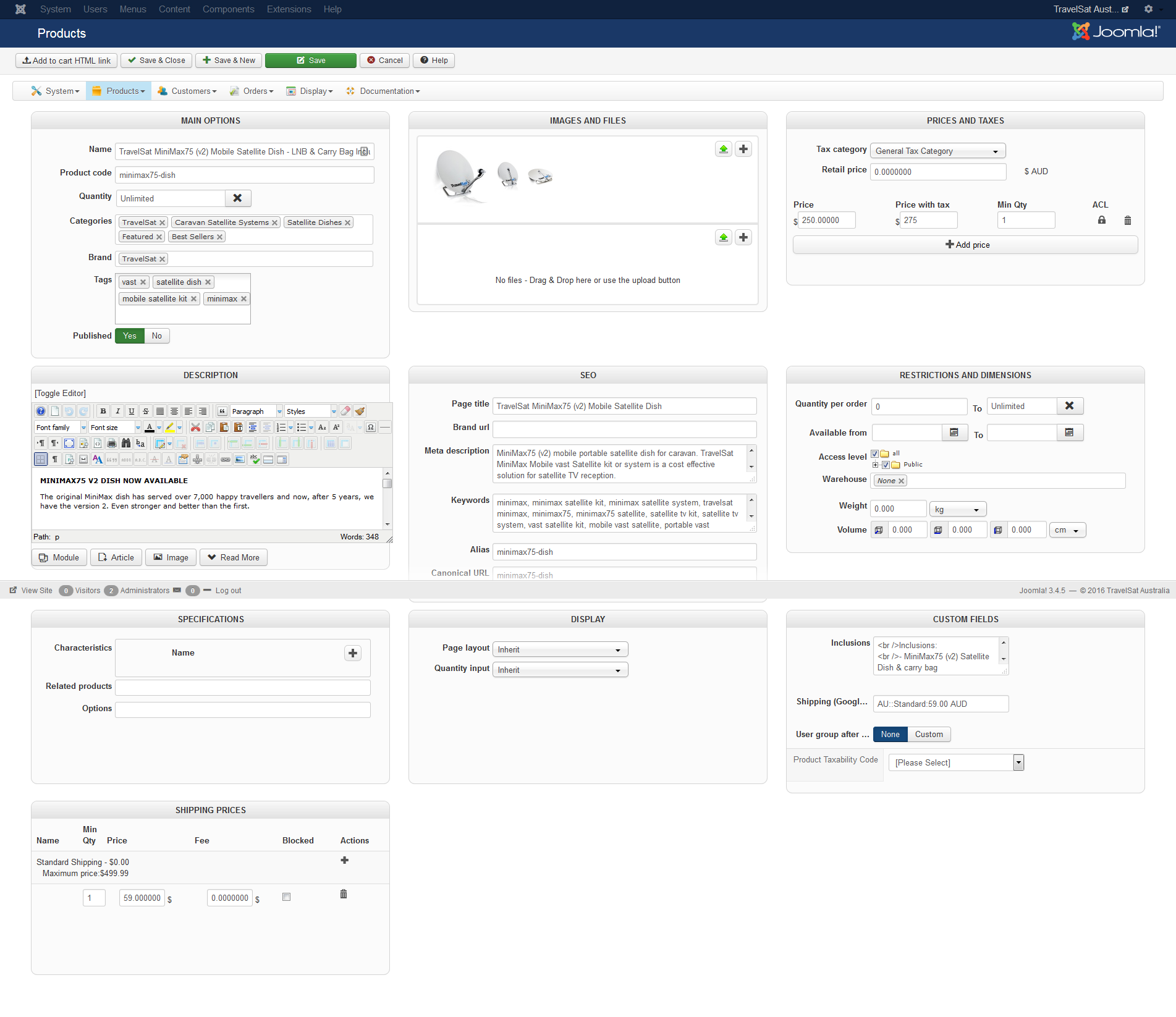

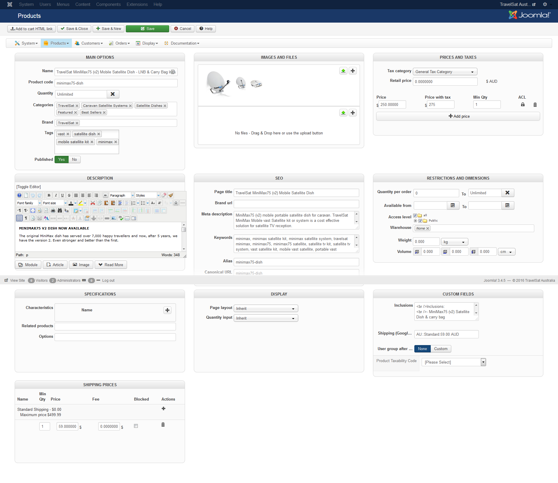

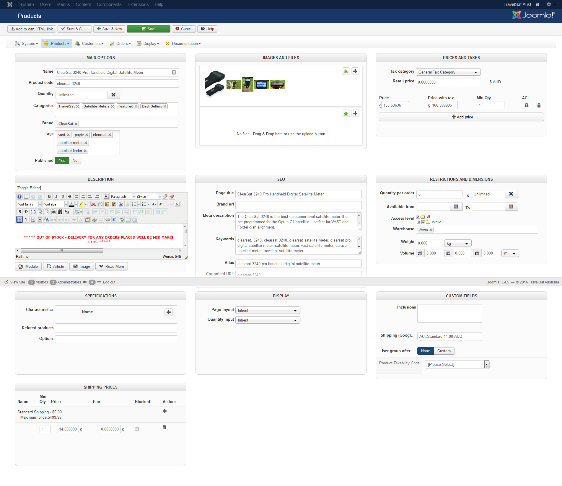

Have a look, here is screenshots
PayPal showed description for ClearSat but didn't show description for the other product in another order listed in previous post.
  • Posts: 86187
10 years 6 months ago #232275
I don't see anything particular in the products.

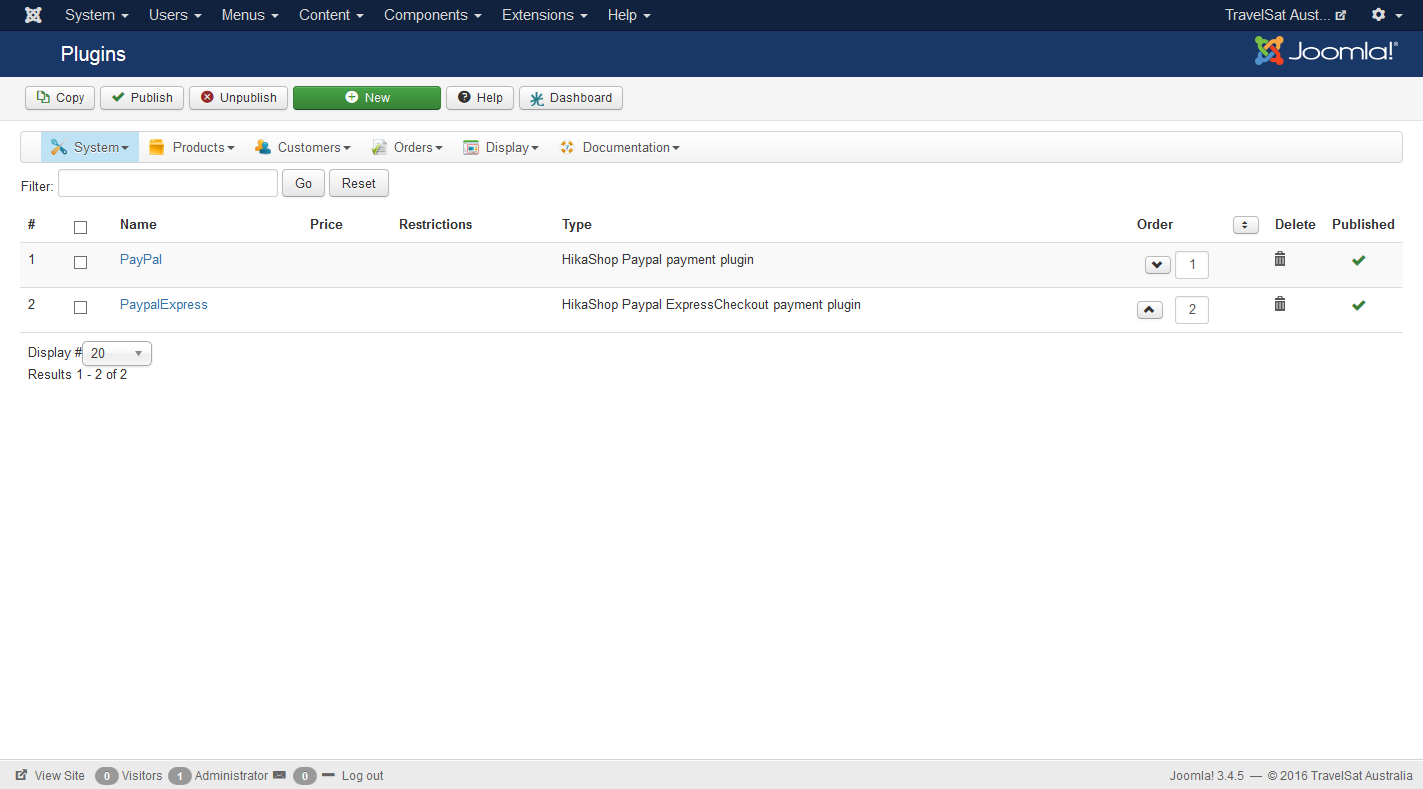

So I've checked your website. And I can see that you're actually using both PayPal and PayPal Express Checkout.
However, only the PayPal payment plugin as a check on the length of the product name and only sends the first 127 characters of the product name.
The PayPal Express Checkout plugin doesn't have such check, but I can see in the PayPal Express Checkout documentation that they have the same restriction on the length of the product name.
So I'm thinking that the payment without the product name was made with PayPal Express Checkout and as the name exceeded the length PayPal accepts, they rejected the whole name.

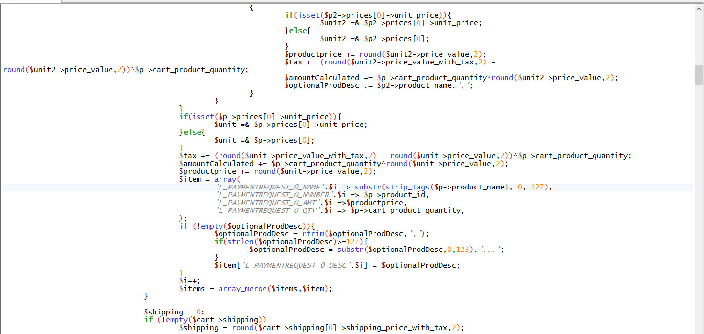

  • Posts: 73
10 years 6 months ago #232574
Unfortunately I recieved today new notification from PayPal with empty description section (user paid via PayPal Express).

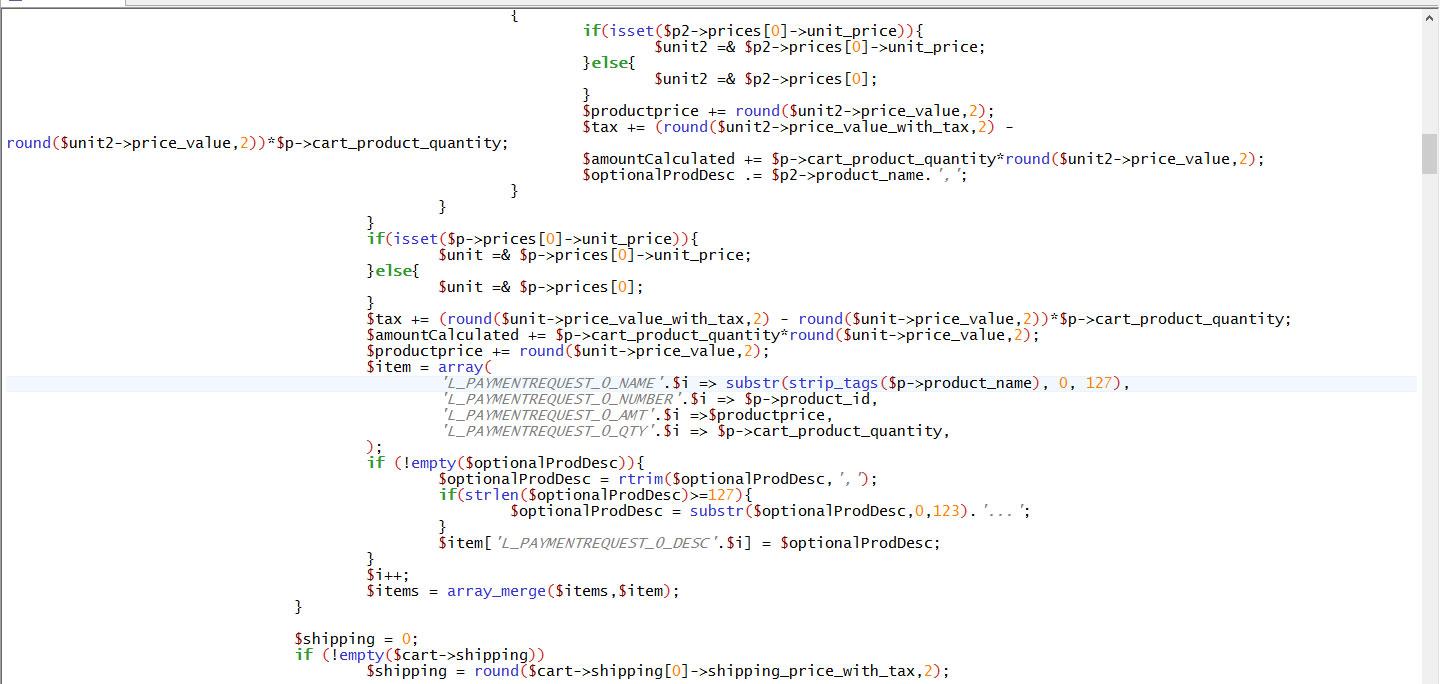

Screenshot of the file I've modified is attached.
  • Posts: 86187
10 years 6 months ago #232584
Can you try with:
'L_PAYMENTREQUEST_0_NAME'.$i => substr(strip_tags($p->product_name), 0, 126),
Maybe the 0 character makes it go over the limit.
Also, could you try with a short product name ? Do you have the problem ?
Is it only with PayPal Express, not PayPal normal ?

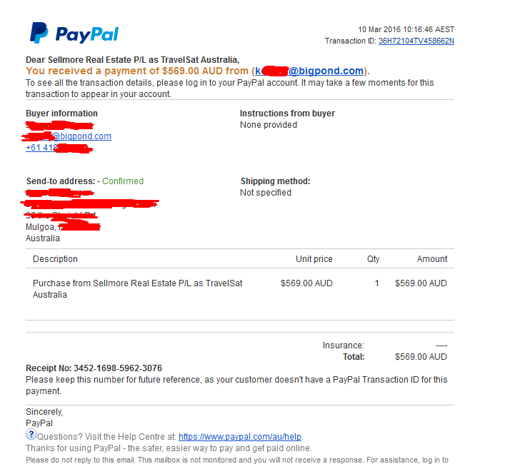

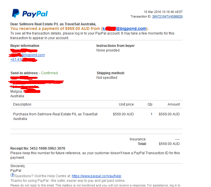

  • Posts: 73
10 years 6 months ago #232838
Changed. After that I recieved 1 more order from PayPal Express. In the description it says “Purchase from Sellmore Real Estate P/L as TravelSat Australia”

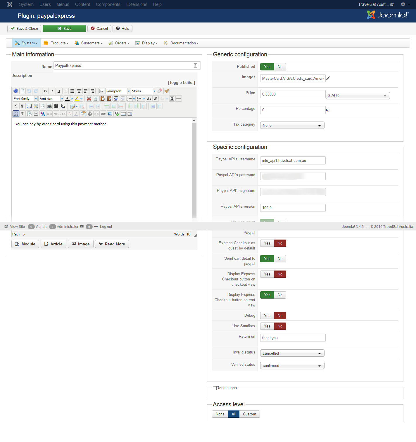

  • Posts: 86187
10 years 6 months ago #233114
Well, the only reason HikaShop wouldn't send the product name to PayPal with PayPal Express would be that the "send order details" option of the payment method is turned off.

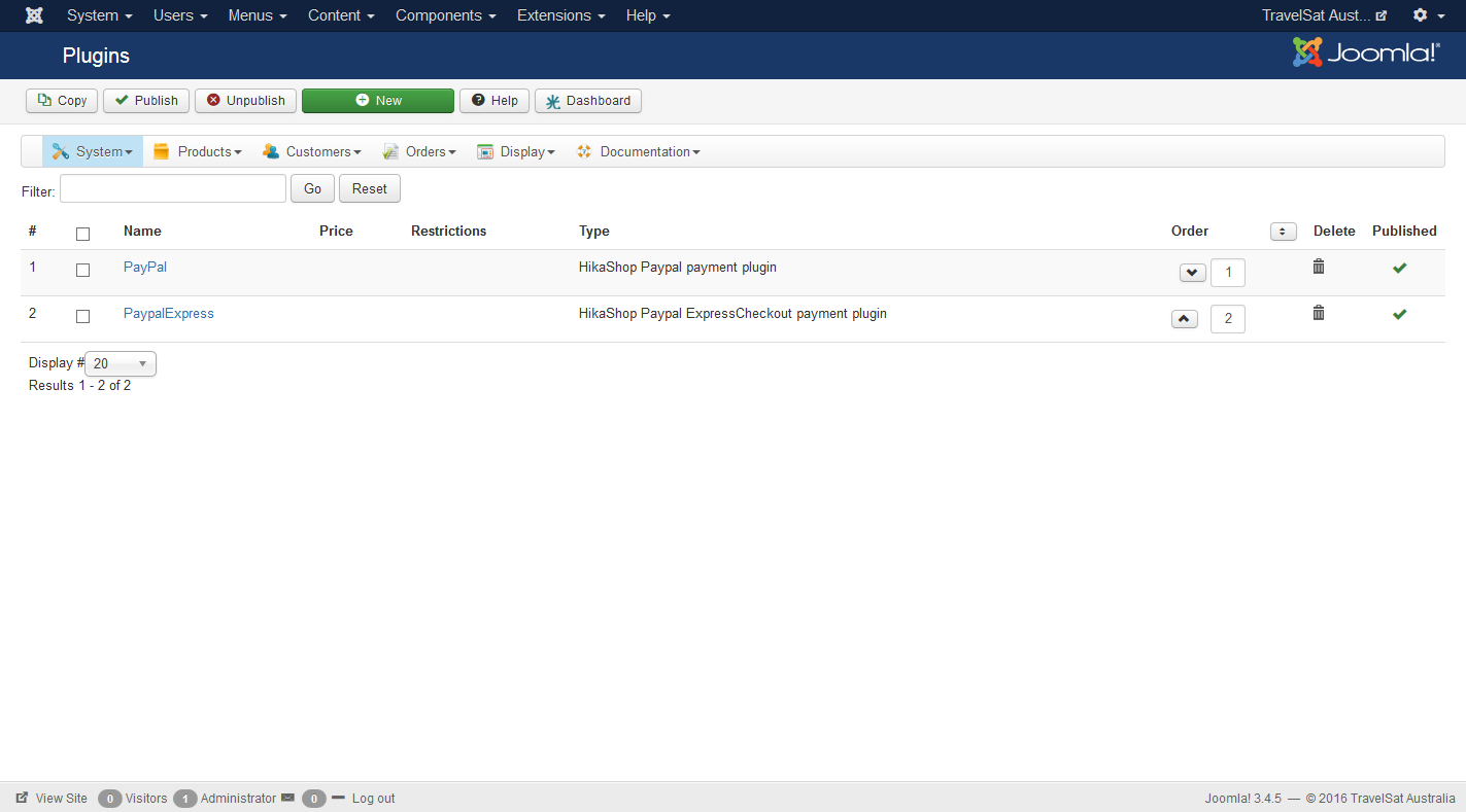

Also, you should normally only have one instance of that payment plugin.
If you have several ones, make sure that they all have the "send order details" option activated.
I don't see anything else on HikaShop's end.

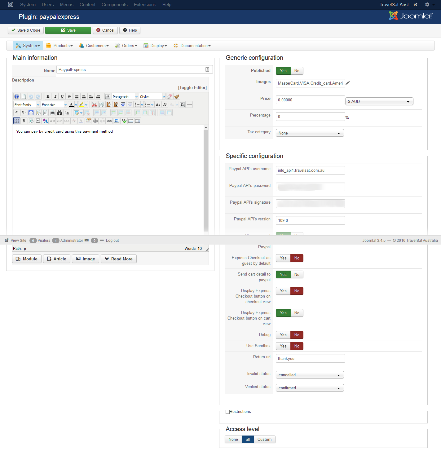

  • Posts: 73
10 years 6 months ago #233169
I have the only 1 paypal express plugin and option "set order details" is enabled. See attachments.

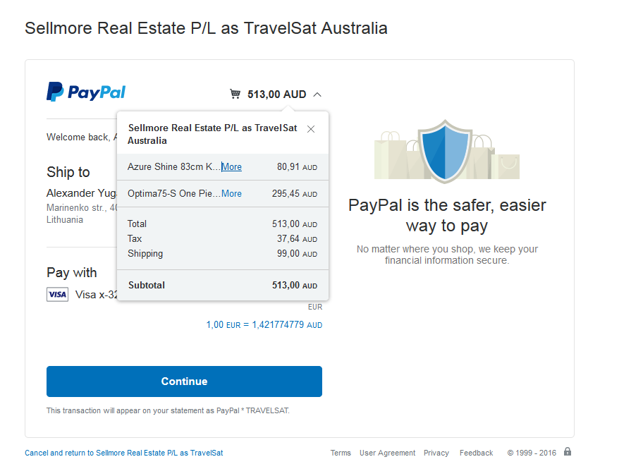

And do you see the item name when you are redirected to PayPal ? Or is the problem only in the payment receipt of PayPal ?
What if you have several items in the cart ? What do you get ?

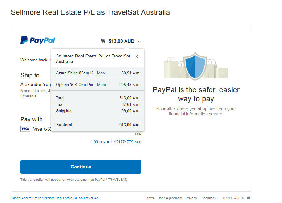

  • Posts: 73
10 years 6 months ago #233402
Yes, I see item names after I redirected to paypal and the problem is in receipt of PayPal.
When I have several items in the cart I still see them in PayPal when paying but I see empty description in PayPal receipt (after I've modified code as you suggested I see "Purchase from Sellmore Real Estate P/L as TravelSat Australia" instead of empty description)
