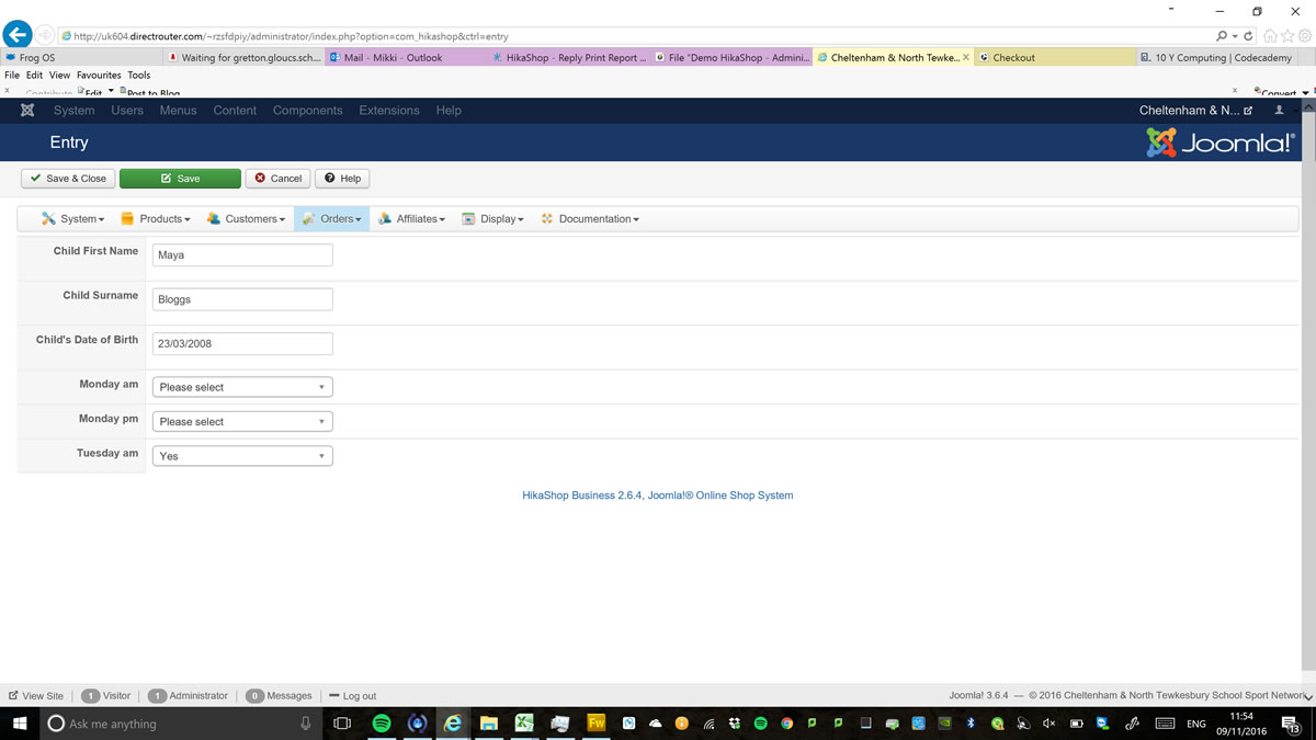

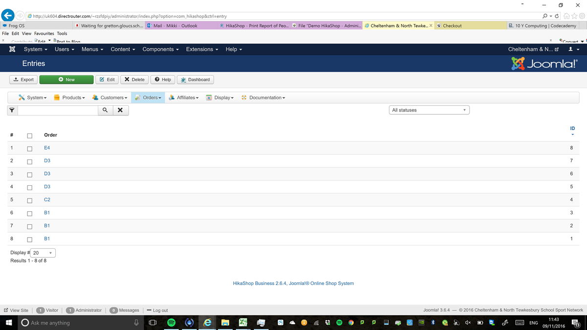

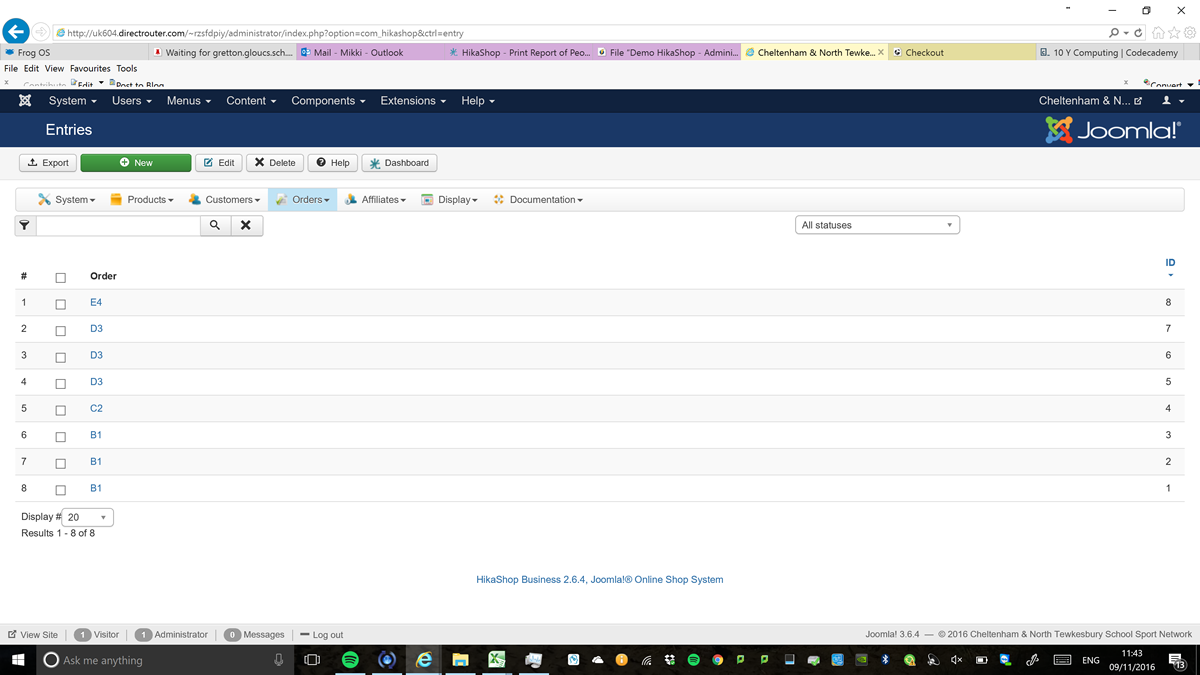

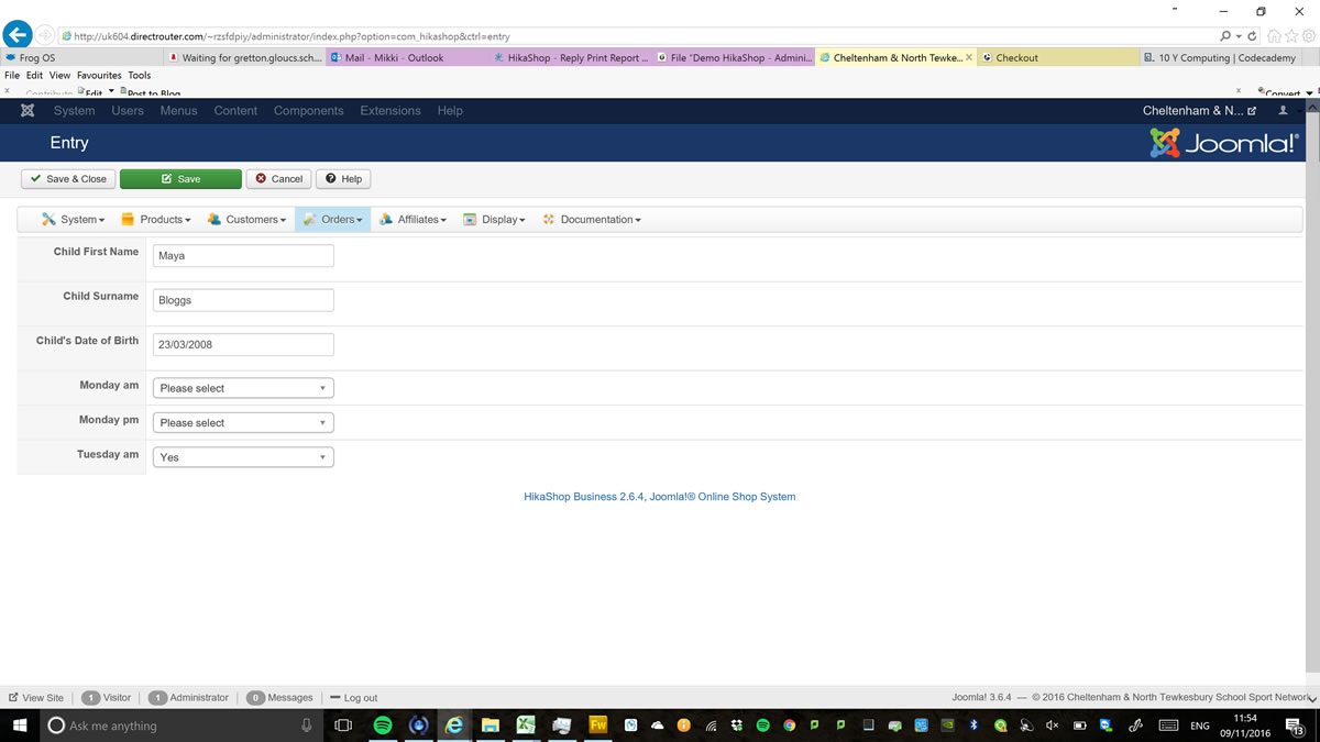

  • Posts: 7
9 years 10 months ago #254837
Thanks for the reply.
I went and looked at that view, but I only see the list of order IDs - please see the screenshot:
When I select one of the items, I do see the details:
Can you help me to work out why I don't get the same view as you?
Many thanks
Mikki
  • Posts: 86187
9 years 10 months ago #254839
You don't see the details of the entries on the listing because you turned off the "backend listing" setting of the custom fields.
Turn that on and it should display them there.
