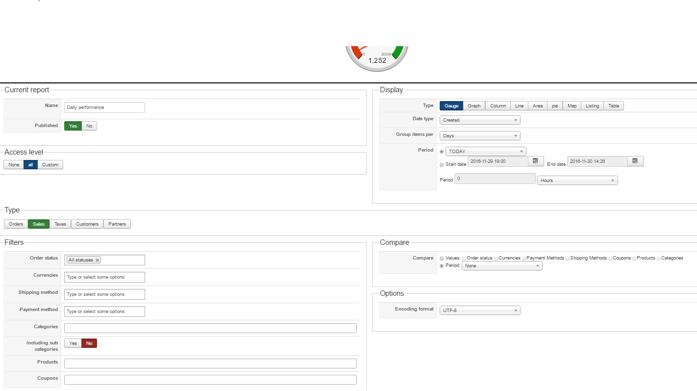

Thank you for the response. Here is the screenshot of the settings.

For example, you've set the statuses setting to all statuses, meaning that even cancelled, refunded and created orders will be taken into account while you might only want to take into account confirmed and shipped orders.
It could also be something relative to your timezone. The report system uses this code to calculate "today at 00:00":
$start= mktime(0, 0, 0, $dayBeginning[0], $dayBeginning[1], $dayBeginning[2]);
This takes into account the timezone of your server. But it doesn't take into account the timezone of your user in Joomla nor the timezone of the Joomla configuration. So it might be why you think that it does the same as "the last 24h" because the time difference you have between your server and your user fill in the gap between "the last 24h" and "today".
