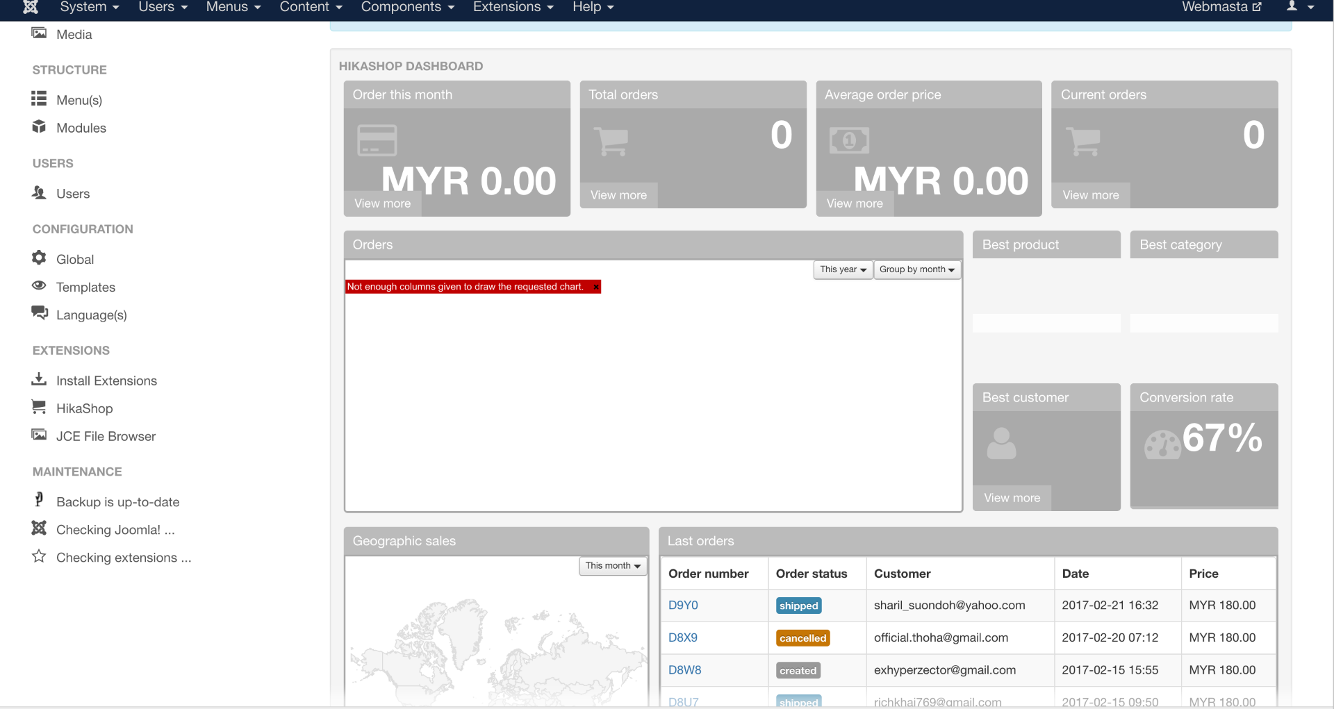

hai, i try to enable hikashop plugin for backend dashboard. but the report didnt show any data.. the report not syc as shown on dashboard inside hikashop extension. please refer to the attachment for more understanding

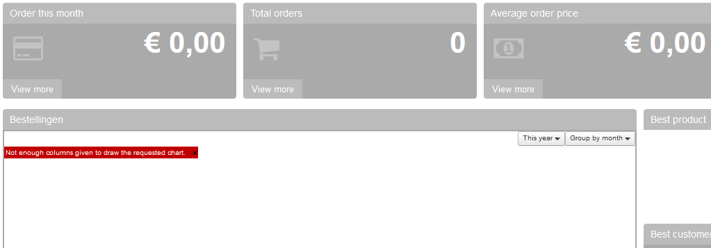

I was following this thread since I have the same issue (also update ftom 2.64. to 3.0.0). You can create any report you want in Orders/Reports. the all come up with a nice table, list or graph. Only in the Dashboard nothing changes. The message "not enough collumns" remains and the other stats still display zero.

Just updated to HikaShop Business 3.0.0 [1702261535] but i see no changes. Still get the Table has no columns." and "Not enough colomns" errors......

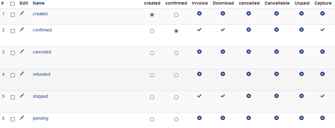

I changed the order statuses ( /administrator/index.php?option=com_hikashop&ctrl=orderstatus ) to create the invoice when a order is confirmed and shipped...... see current table:
No the stats are being displayed in the new dashboard and this topic can be closed.

Hai, i already install the Latest 3.0.1 but as you can see in the image attachment there is no data for total order, average order, best product, best customer, best category and geographical sale. For order, it still show Not enough columns given to draw the requested chart.
it only show the conversion rate and last order data. How to make it display the data?
Pleas guide step by step to solve this problem as im so damn noob. tq
  • Posts: 86187
9 years 6 months ago #264333
As we said earlier, you need to make sure that the "statistics" settings in the menu System>Order statuses correspond to what you want to display.
So if your orders are created and not confirmed, you want to activate "created" there. If your orders are confirmed, you want to activate "confirmed" there. Etc.
