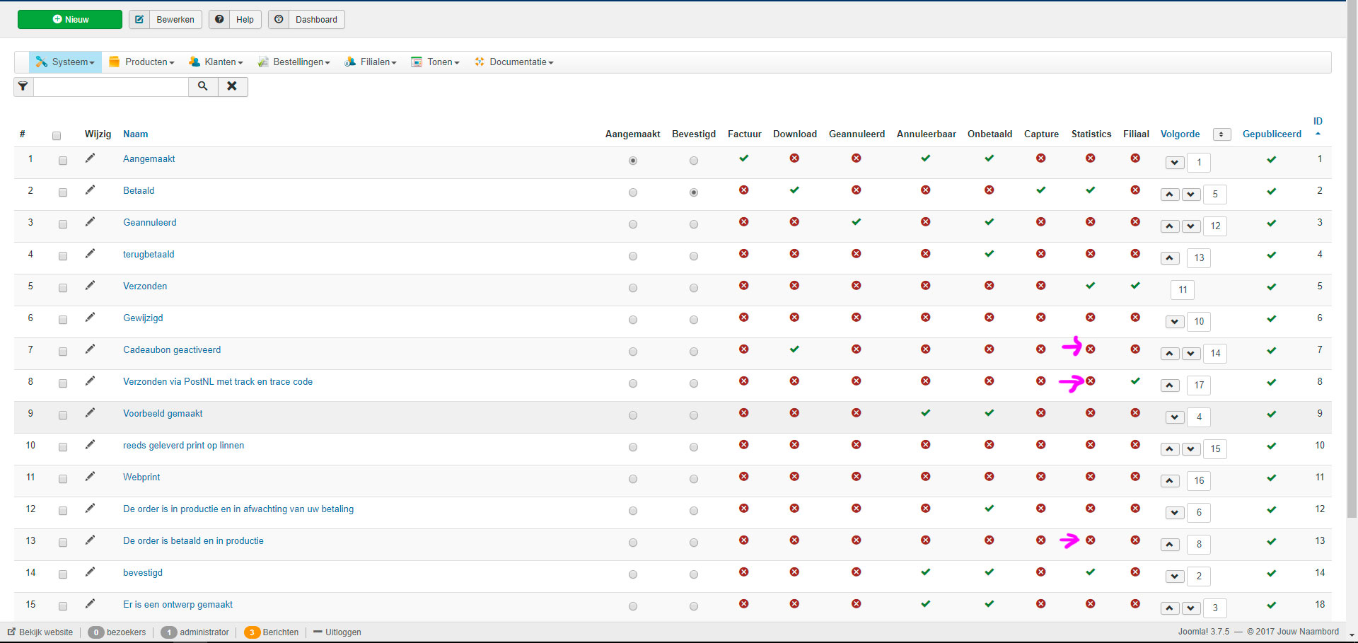

When I check the colomn charasteristics for several order statuses (custom statuses, not default), the activated check is undone after viewing the dashboard. See screenshot (the arrows point to the checked status), as you can see they are unchecked again.

8 years 10 months ago #279256
We were able to login and check on the issue.
Apparently, this only happens when you have a special characters in order statuses, including spaces as the filtering is too restrictive for the security.
Change the line:
$completeTask = hikaInput::get()->getCmd('task');
to:
$completeTask = hikaInput::get()->getVar('task');
in the file administrator/components/com_hikashop/controllers/toggle.php and that should work with your statuses.
