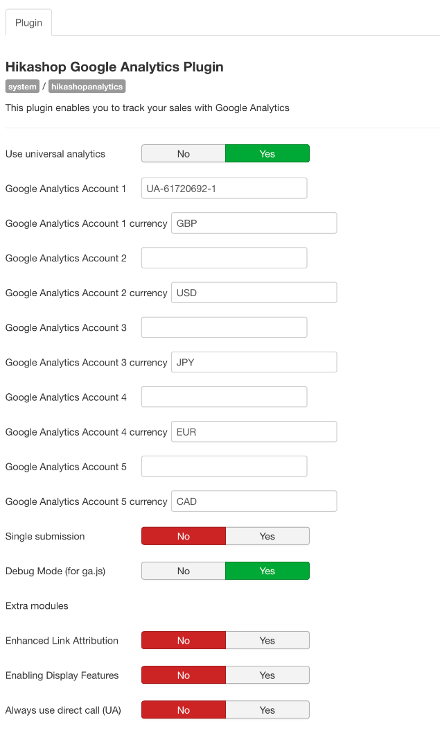

  • Posts: 100
8 years 10 months ago #282580
Sure, I've attached a screenshot. Could it be an issue with the settings?
Thanks again.
  • Posts: 86187
8 years 10 months ago #282585
Try activating the "Always use direct call" setting.
Sometimes, based on how your shop is configured, the data cannot be sent to GA with that option turned off.

  • Posts: 100
8 years 10 months ago #282634
nicolas wrote: Hi,
Something based on how your shop is configured, the data cannot be sent to GA with that option turned off.
Thanks. I've turned this setting on so will wait a few days to see if it starts tracking data.
  • Posts: 100
8 years 10 months ago #282673
It worked. Many thanks.
