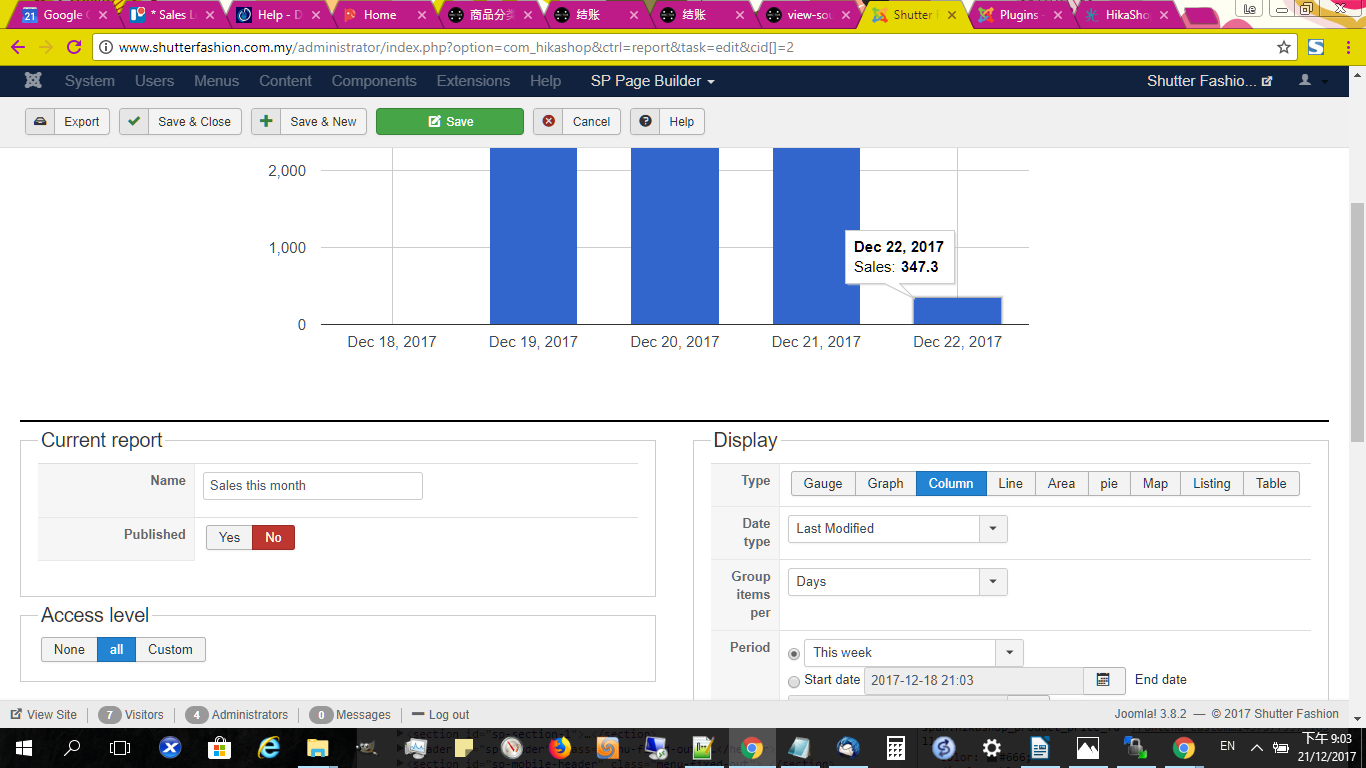

We found some abnormalities after upgraded to the latest version
Our Global Configuration are using MYT time zone as well as the server Date is MYT
All the order date are display and created nicely
For example, currently we have 1 confirmed order on 15/12 and 14 confirmed order on 14/12
However, when we run the sales this month report or the dashboard report
System capture 7 sales on 15/12 instead of 1 sales
Is it some reconfiguration of us ? we also notice that there is an invoice_created date in order sql table, is it the cause?

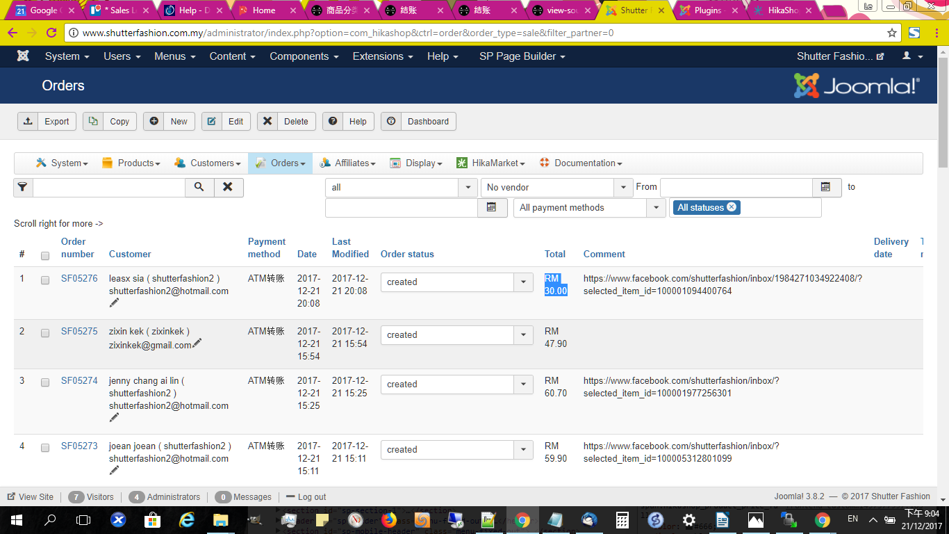

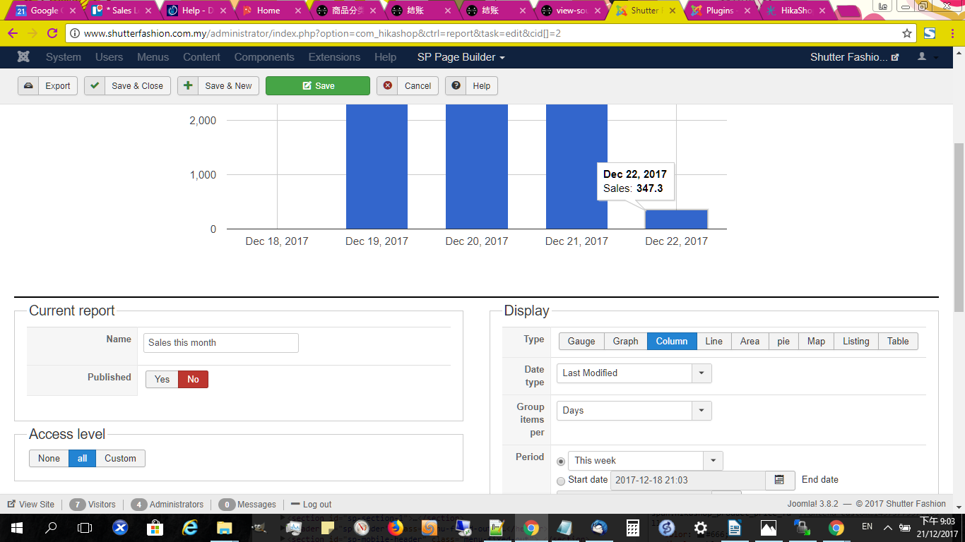

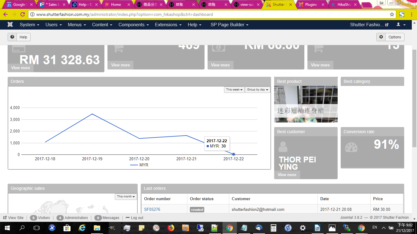

I would like to highlight, this problem only occur after ugprade to 3.2.1
date on Order listing (administrator) page is correct, however, dashboard and report can not calculate sales bases on the date

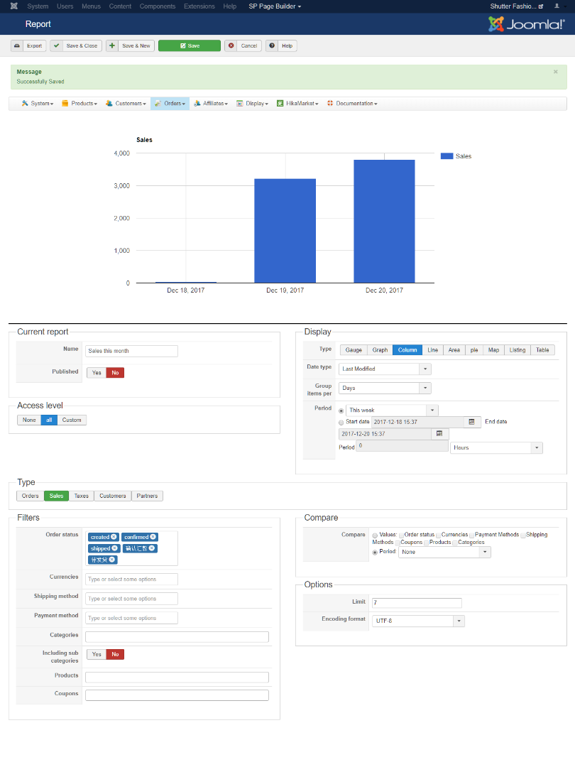

I've been looking in our SVN for changes to the reports system regarding the dates and I've been up to 2 years and a half in the past and didn't see any change which would affect the date restrictions.
Also, how did you configure the report? Could you provide a screenshot ? Could you also tell us how you configure your timezone in your Joomla configuration and in your user account in Joomla ?

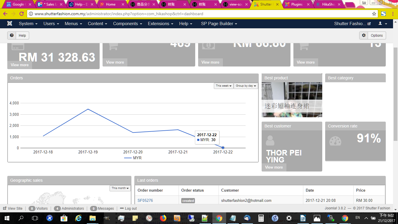

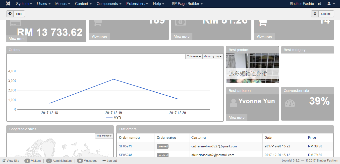

Let me provide a screen shot for better understanding

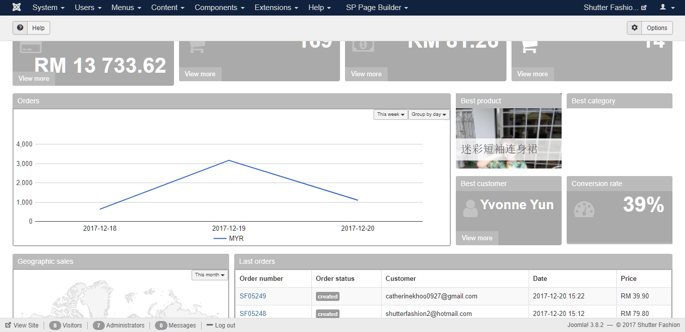

Joomla & Server timezone are using +8:00 Kuala Lumpur/Singapore
As you can see in screenshot, there is a big difference of amount between two report, we do not know which is correct when the transaction is big

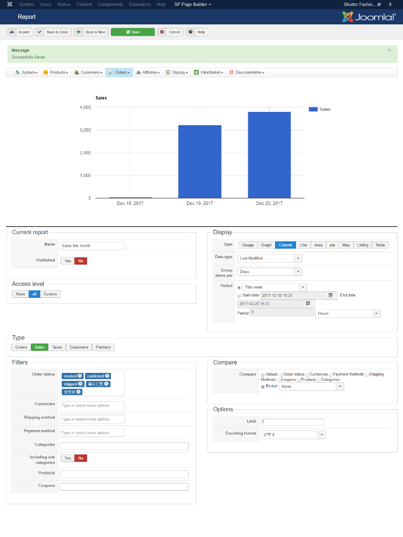

Well, you're not comparing the same data on both screenshots.
On the report, you have many order statuses selected but on the new dashboard, only the "statistics" statuses from the System>Order statuses menu are taken into account. Also, if the "created" order status is enabled as a "statistics" status, then it's the order creation date of orders that is used for the dashboard, and if not, it's the invoice creation date of orders that is used, while in your report, you're using the "last modified" date which is again another date.
The order creation date is the date the order was created in the shop.
The invoice creation date is the date the order was paid.
The last modified date is the date the last time something was changed in th order.
Normally, a customer will pay the order directly after it is created and you won't edit the order afterwards, so all these dates would be almost identical. But it's possible that the order was created two weeks ago, paid last week and that you modified it yesterday.
So because of these, it's totally possible to get results way off between the reports and the dashboard because you're not necessarily comparing the same things and it's highly likely that both are correct for what they are trying to display.

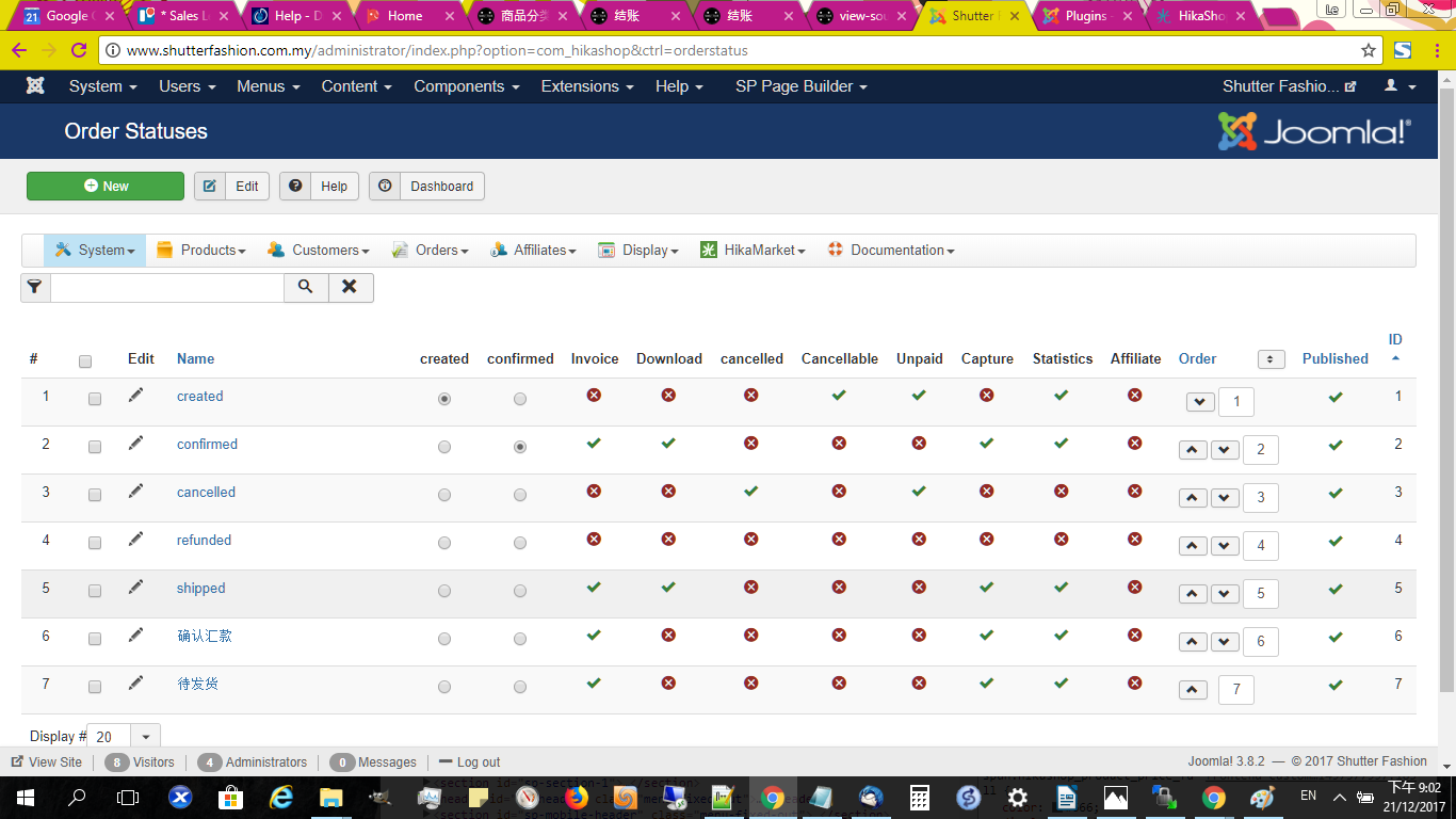

8 years 9 months ago #284866

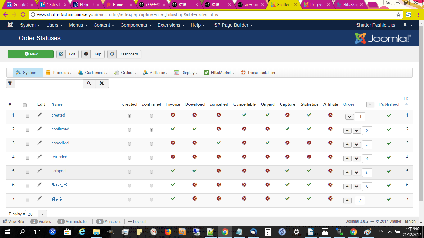

i still found problem, i had changed the statistic with created status , here is the screen shot for reference
  • Posts: 86187
8 years 8 months ago #284868
Well, first if you want the same data as on the reports, you might want to deactivate the "dashboard legacy" setting of the HikaShop configuration.
Otherwise, regarding the new dashboard, as I said in my previous message, if you enable the "created" status in the "statistic" column of the menu System>Order statuses, it will be the order creation date that will be used.

8 years 8 months ago #284901
Dear Nicolas
We had already checked the created status as per in the screen shot in the statistic (you can see it from the screen shot)
However, the data for the order list, report, dashboard are still different (you can see from the screen shot, dash board record the last on the next day date which is not even logic with the order or invoice date)

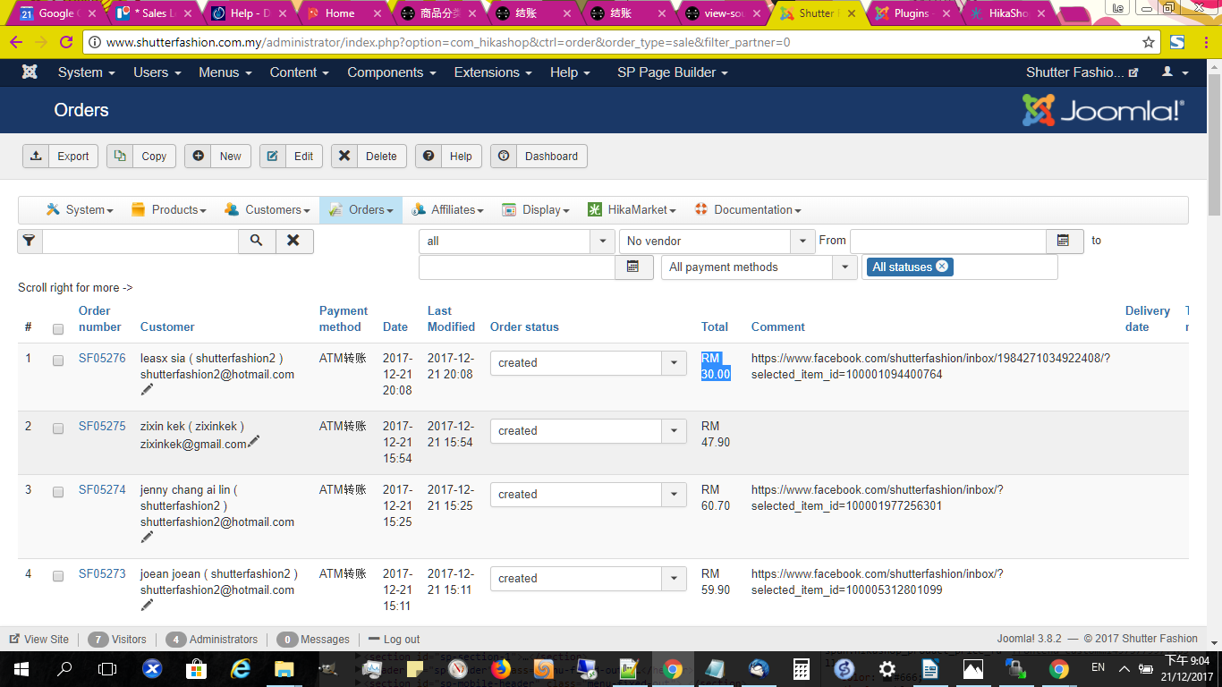

For the order_created & invoice created in the screen shot order list
SF05273 - 1513840307 - 0
SF05274 - 1513841158 - 1514009010
SF05275 - 1513842841 - 1513911458
SF05276 - 1513858081 - 0
