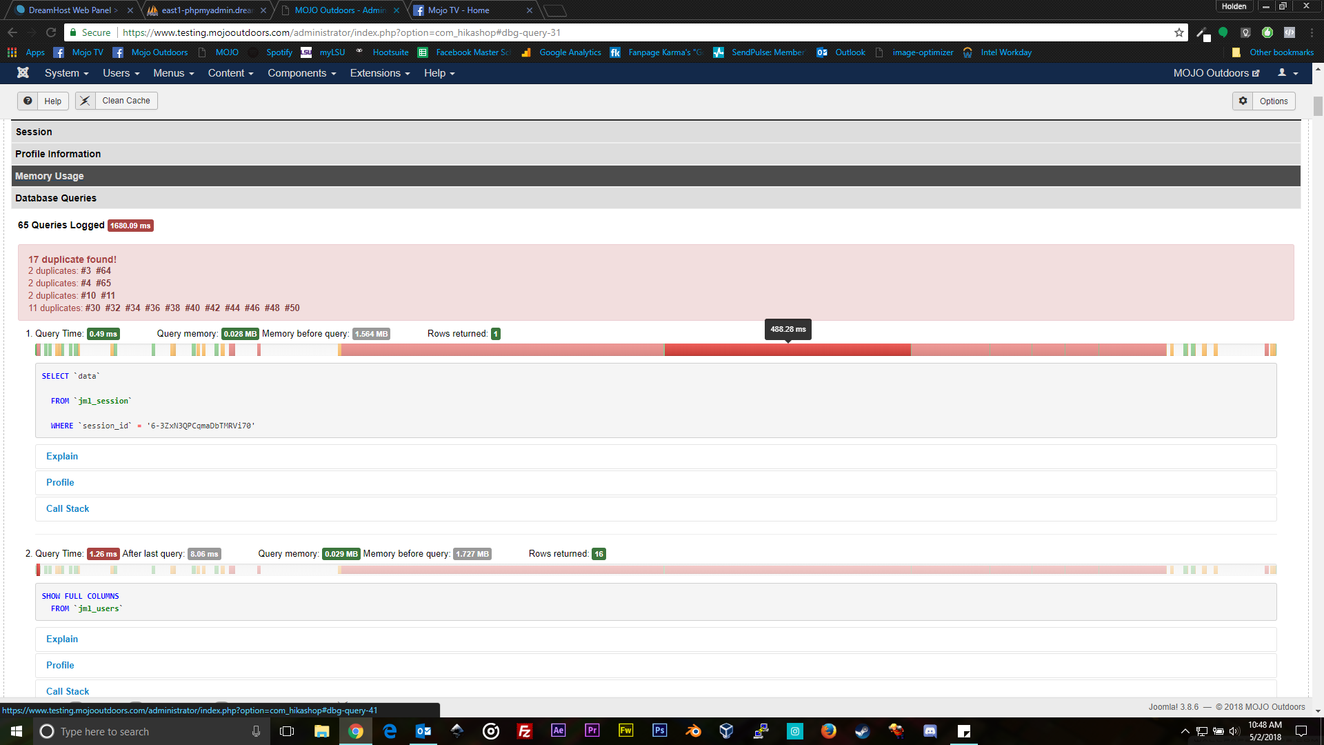

8 years 4 months ago #291961

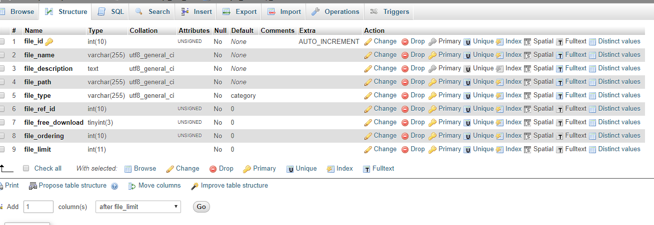

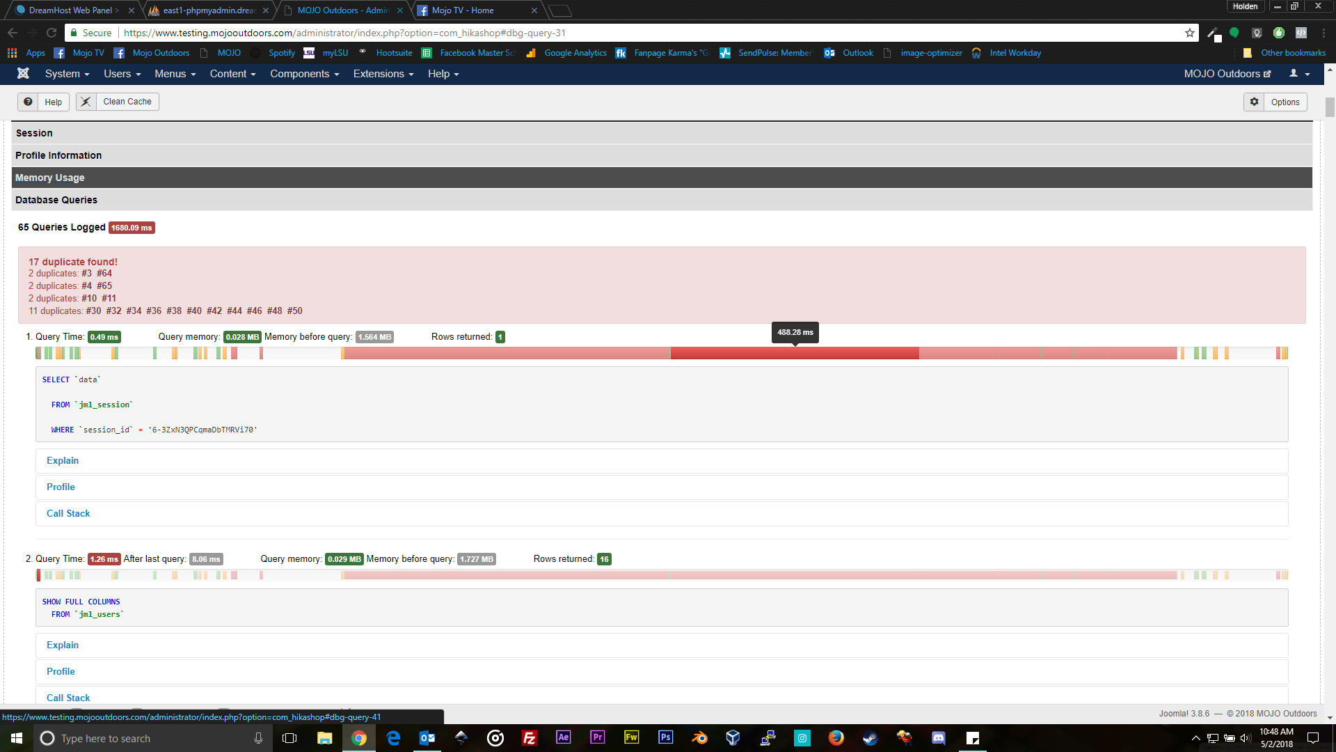

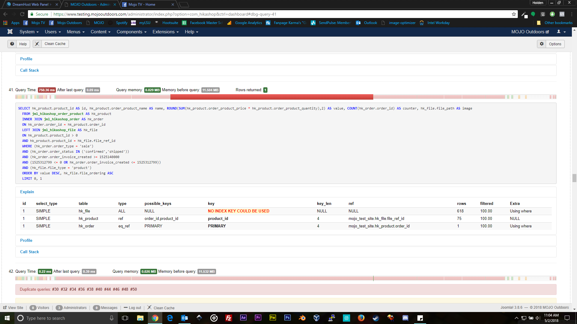

I turned on the debugging option and i see several duplicate entries and a few calls that are taking the majority of the load time. Here is an example:
However, i'm unsure how to resolve the errors. Seems to be related to the hikashop tables though. Not sure what the "NO INDEX KEY COULD BE USED" error is, but it seems that it forces the entire table to be indexed which takes a ton of time. Any ways to quickly resolve this? Surely it's a common problem?
  • Posts: 86187
8 years 4 months ago #292009
For some reasons it looks like it's not able to use the index available on the file_type column of the hikashop_file table. Can you check that you have that index ?

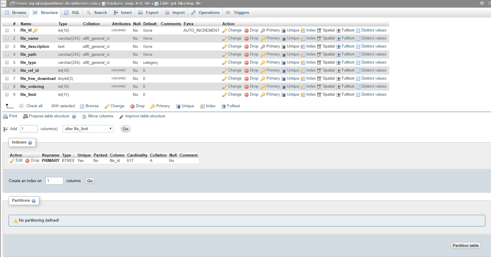

  • Posts: 303
  • Thank you received: 18
8 years 4 months ago #292044

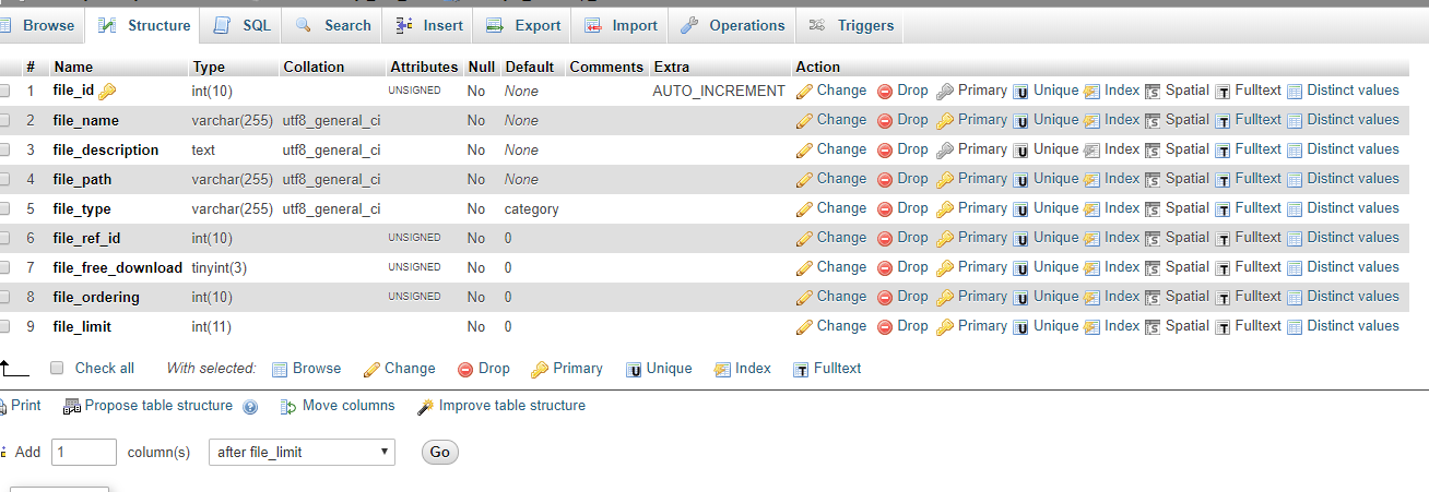

Here's the structure for that table:
Also, the legacy checkout option is turned off. However, it is also slow with it turned on as well.

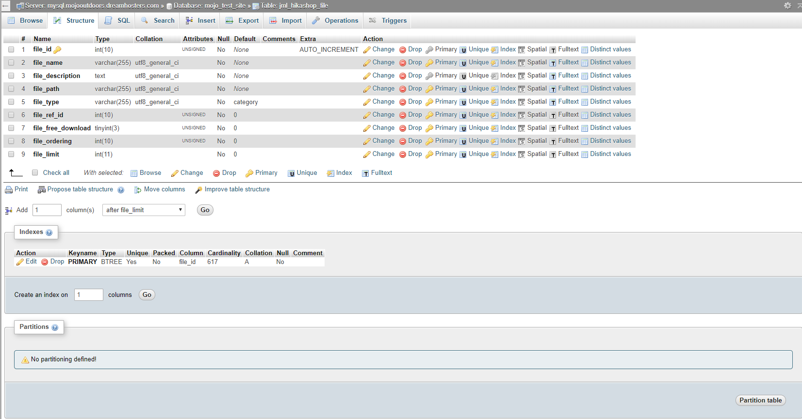

Regarding the table structure, just below the area of your screenshot, you must have an "index" link you can click on and it will then expand to display the indexes on that table:
monosnap.com/file/PVtqs7dhl3Yu0gqw5b4V54kEbu8VGc
  • Posts: 303

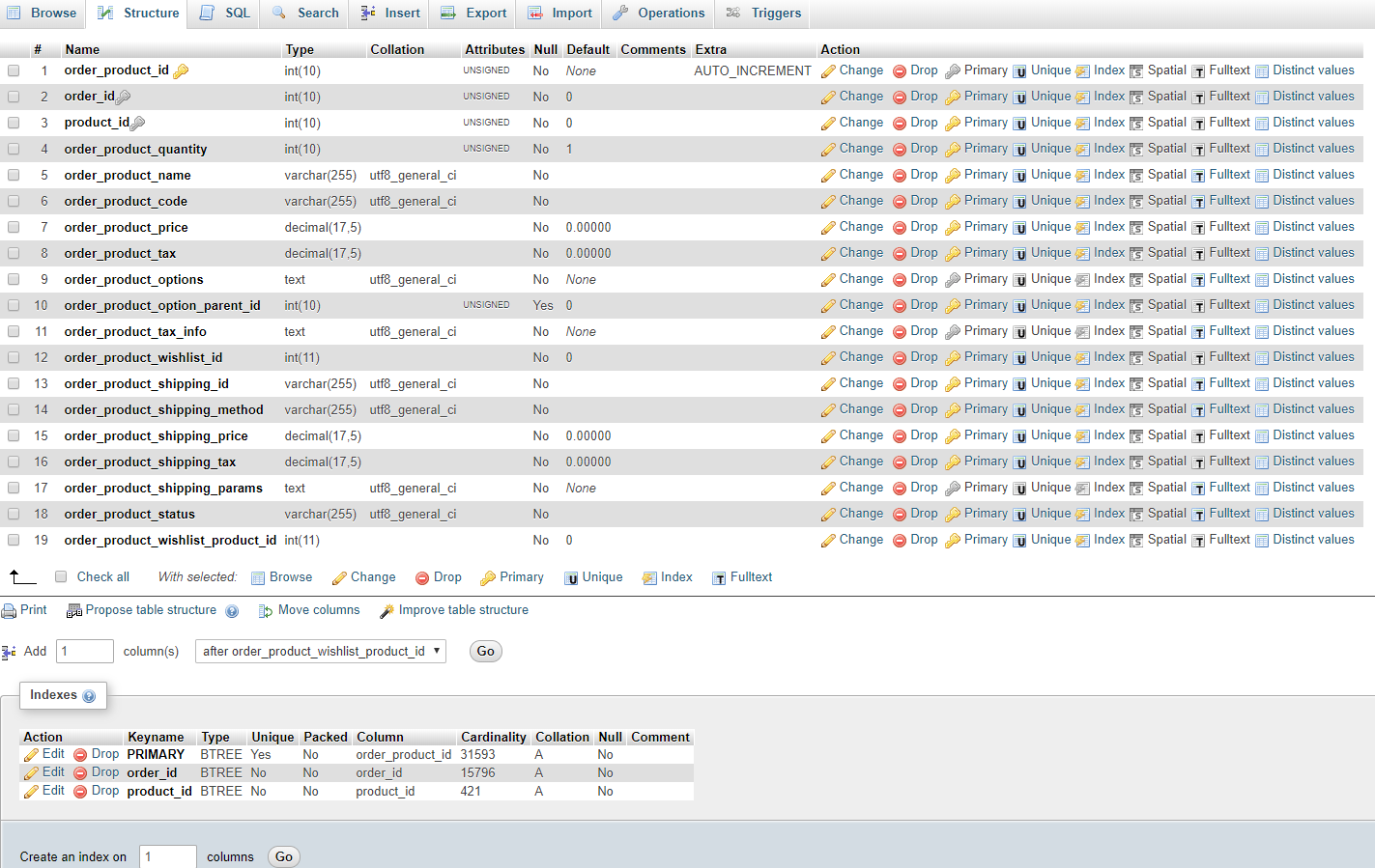

8 years 4 months ago #292113
Woops. Meant same behavior whether dashboard legacy is turned on or off.
As for the index, here's the expanded screenshot.
Seems that there is only one index. Your screenshot shows two. Is there any easy way to add this in to correct the issue?
  • Posts: 26386
  • Thank you received: 4078
8 years 4 months ago #292118
Regarding the query details, it looks like the "order product" table is right now the element to optimize.
It might be interesting to add an index on the "product_id" to speed up some queries ; you have a very high number of entries in that table in your side.
The "generic" query to add the index is :
ALTER TABLE `#__hikashop_order_product` ADD INDEX `product_id` (`product_id`);
But you have to replace the "#_" by your database price ; which will be in your case
ALTER TABLE `jml_hikashop_order_product` ADD INDEX `product_id` (`product_id`);
Please let us know if it improve the query and you can give us a new screenshot of the debug so we can compare values.

8 years 4 months ago #292184

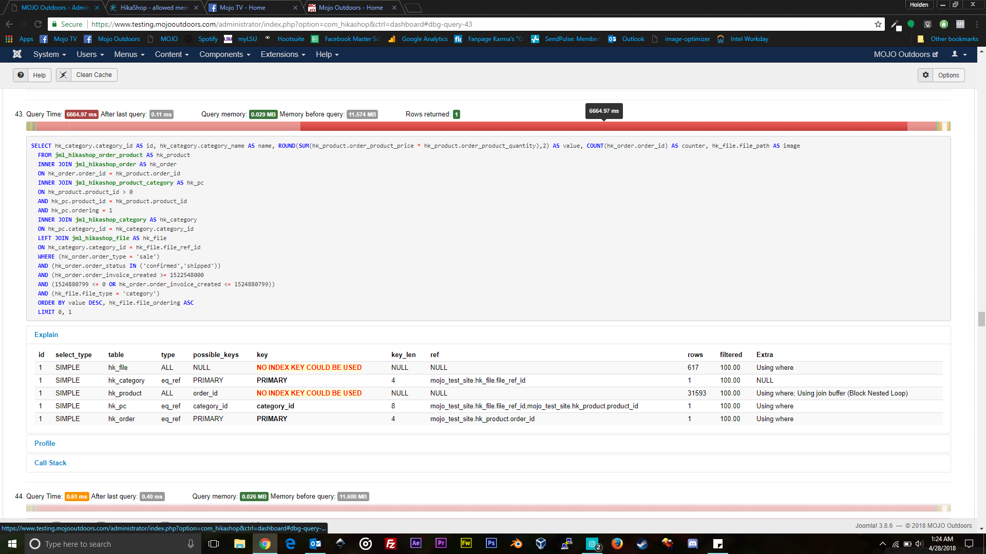

Also, here is the database call that is taking the most time:
  • Posts: 26386
8 years 4 months ago #292185
I don't remember in which version exactly but we added an index in the hikashop_file table ; but just in the database definition and not via the update system.
So, it could explain why you do not have the index for that.
ALTER TABLE `#__hikashop_file` ADD INDEX `file_type` (`file_type`);
Afterwards, the index could be more optimized by using a combination of file_type + file_ref_id.
