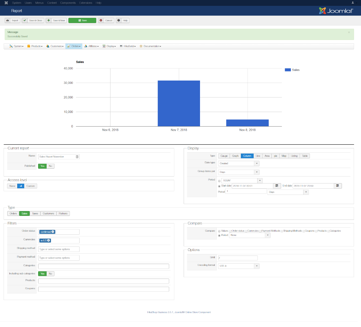

7 years 10 months ago #300368
Hello Nicolas,
I've made several attempts and managed to understand the issue on our end. I'm trying to generate a sales report for a single day. No matter what I select from the settings, the day is broken into two days. This causes disorder when we try to generate a report for several days or a week report.
Please see attached screen shot.
Much appreciated,
Guy.
  • Posts: 86187
7 years 10 months ago #300394
This indicates an issue with the timezones. Can you check that the timezone of your server, in your Joomla configuration and in your Joomla user account all match up ?
