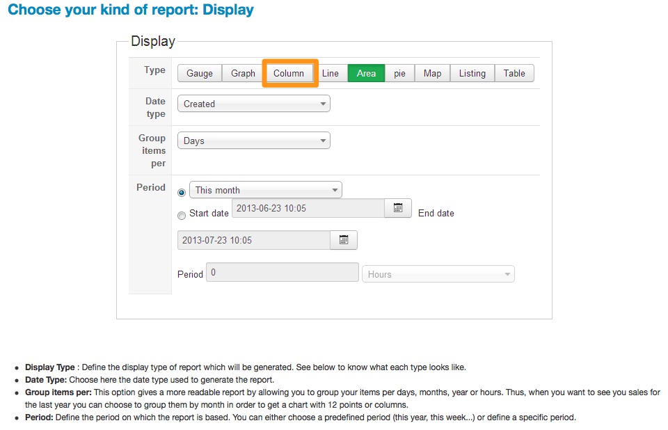

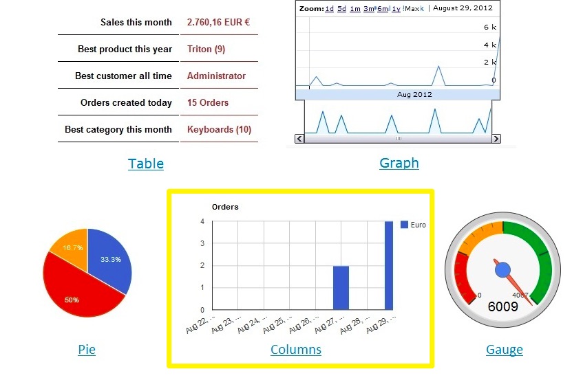

I'm very surprised by your answer :
We never had a "column" type
The "Reports Edition" Hikashop page clearly shows the column type display. I've used it for years.
9 types of display were possible and now only 8 remain. Please have a look to the attached pics.
  • Posts: 86187
7 years 7 months ago #303421
My bad, I wasn't looking at the same thing.
We indeed did remove that type to have less of them since it was redundant with other types like lines or area which display basically the same information.
