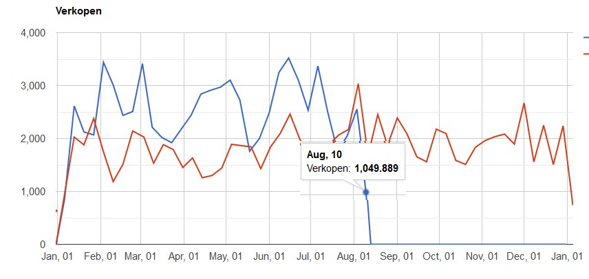

Strange things are happening in the statistic reports.
When daily or weekly figures are displayed, the associated dates are correct.
But after switching to monthly statistic suddenly a gap has arisen between the associated date and the actual period to which the statistic shown refers.
It's all about a line chart with start date 2020-01-01 and end date 2020-12-31.
Two screenshots are attached to make clear what happens.
In screenshot 1 the items are grouped per week.
The X-axis displays the correct dates: Jan 01 unto Jan 01.
An example of the statistics: on Aug. 10 the sales of the previous week are displayed.

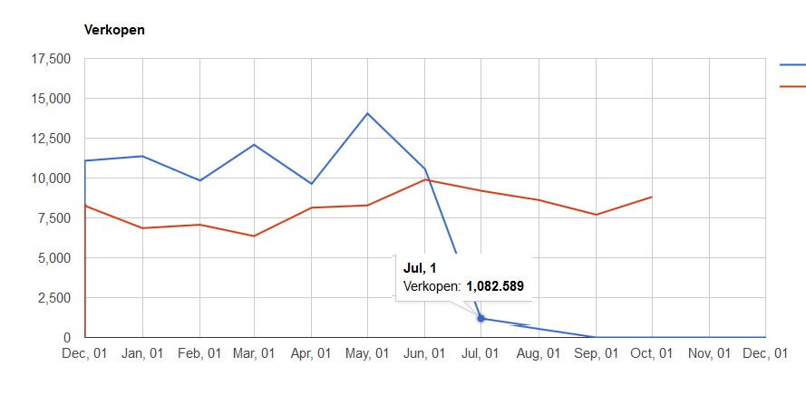

In screenshot 2 the items are grouped per month Start date and end date are unchanged.
Now the dates on the X-axis haven been moved forward a month: Dec. 01 untill Dec. 01
Remarkable: on Jul. 1 the sales of August are displayed., on Jun. 1 the sales of July and so on.
This is very confusing and incorrect.
The red lines in the charts are sales in the same period last year.
Please advice.

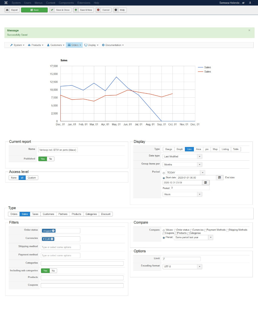

Can you please provide a screenshot of your "report" configuration ?
  • Posts: 220
  • Thank you received: 8
5 years 11 months ago #323358
Attached is a screenshot of the configuration of the monthly sales report.
Before updating to Hikashop 4.3.0 I used the columns display type. That was working fine.
Alas that display type is removed.
Udo
