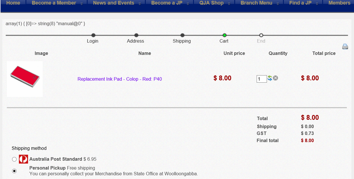

12 years 10 months ago #120313
While this patch has solved the checkout problem I have noticed an erroneous message appearing during the checkout process: See attached screenshot.

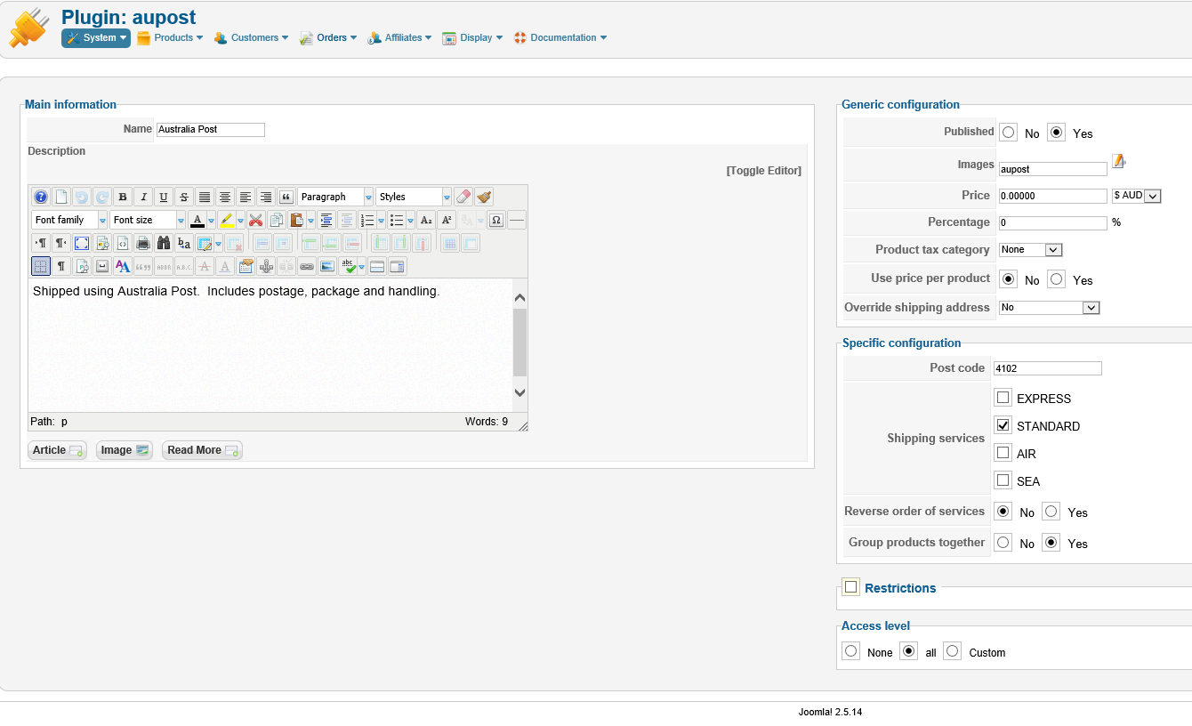

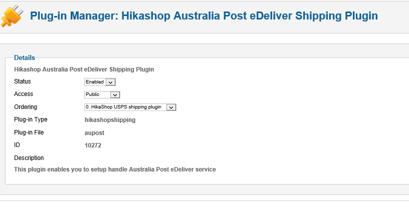

  • Posts: 22
12 years 9 months ago #125316
I have reinstalled 2.2.1 again - no change to the way the Aus Post plug in behaves. Attached are snapshots of the plug in and configuration screen where you can see there is no "Additional Charge" field.

  • Posts: 26366
  • Thank you received: 4069
12 years 9 months ago #125404
I am not the specialist of the plugin Australia Post, but in order to add some additional fees, you have to use the field "price" in the generic configuration of the shipping plugin.
The plugin base price will be this price and it will add the price return by the Australia Post API.
