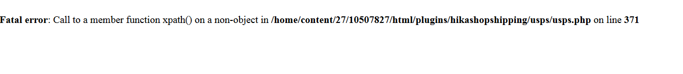

-- Error-message(debug-mod must be tuned on) -- : error: Call to a member function xpath() on a non-object in /home3/gravest3/public_html/plugins/hikashopshipping/usps/usps.php on line 371
[09-Nov-2013 05:48:27 America/Denver] PHP Fatal
I have a weird problem that has suddenly occurred since going live with my new site.When trying to access the USPS shipping plugin I get a 500 error. I have a weight restriction of 3.25 oz under restrictions so anything under that weight will trigger FREE shipping (manual shipping).
As I said, this was working until today so I'm not sure what the problem could be or what might have changed. I went live yesterday afternoon and it was working. Two orders came in overnight (the customers chose Priority Mail) -- so it must have been working then.
I'm stumped -- any help would be greatly appreciated.

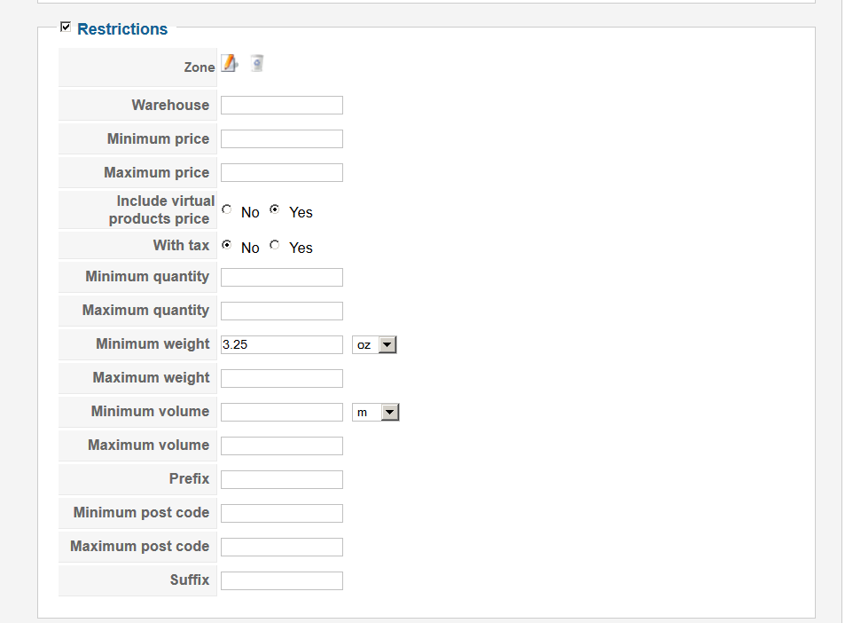

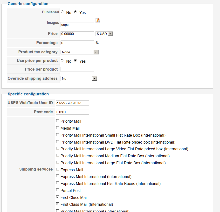

I also just tried:
  • disabling and re-enabling the USPS plugin.
  • removing the weight restriction
I also discovered one of my other web sites running Hikashop Business and using the USPS plugin is showing the exact error when trying to purchase a product. Could something have changed on the USPS servers?
