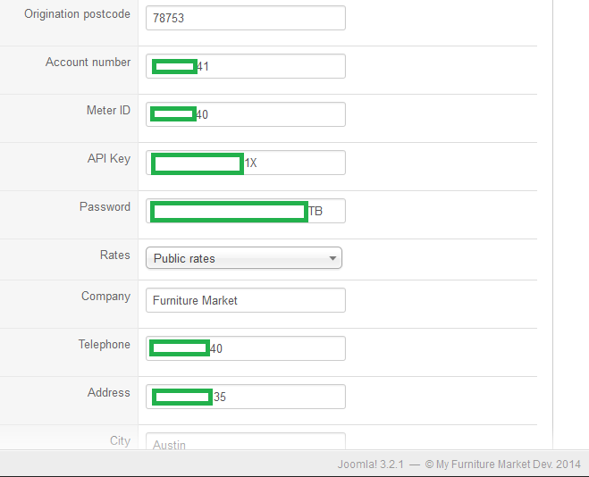

I am trying to set up development site and I am getting this error "FEDEX Authentication Failed No shipping method found".

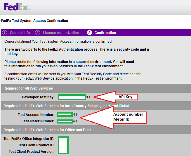

I registered at FedEx and created test account using Develop and Test tab. After I filled all necessary details I got to the confirmation page(Image #2 in the attachments). I used those details in the HikaShop FedEx plugin(Image #1).
For the password field I used "Test password" from the email that FedEx send to me after confirmation(Image #3).
I set everything correctly and I am still having this error. Can you please tell me what did I do wrong if anything.

This looks correct. I would recommend you to contact FedEx support in order to make sure that the credentials that you're using are activated properly on their end.
