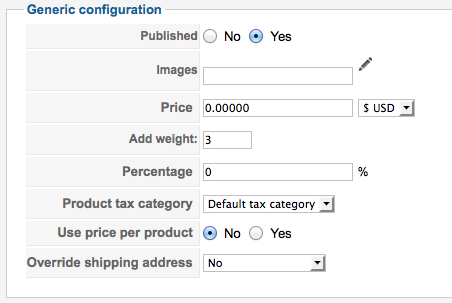

You need to add the code:
<td class="key">
Add weight:
</td>
<td>
<input size="5" type="text" name="data[shipping][shipping_params][weight_approximation]" value="<?php echo @$this->element->shipping_params->weight_approximation; ?>" />
</td>
</tr>
in the file "form" of the view "plugins" via the menu Display>Views before the code:
<tr id="hikashop_shipping_per_product_1"<?php if($this->element->shipping_params->shipping_per_product == false) { echo ' style="display:none;"';}?>>
					<td class="key">
						<label for="data[shipping][shipping_price_per_product]"><?php
							echo JText::_( 'PRICE_PER_PRODUCT' );
						?></label>
					</td>
					<td>
						<input type="text" name="data[shipping][shipping_params][shipping_price_per_product]" value="<?php echo @$this->element->shipping_params->shipping_price_per_product; ?>" />
					</td>
				</tr>
and then change the line:
$parcel->Weight=$package_weight;
to:
$parcel->Weight=$package_weight+$rate->shipping_params->weight_approximation;
at the end of the file plugins/hikashopshipping/usps/usps.php
  • Posts: 9
12 years 2 months ago #153307
Thank you for the clarification. Worked perfectly.
