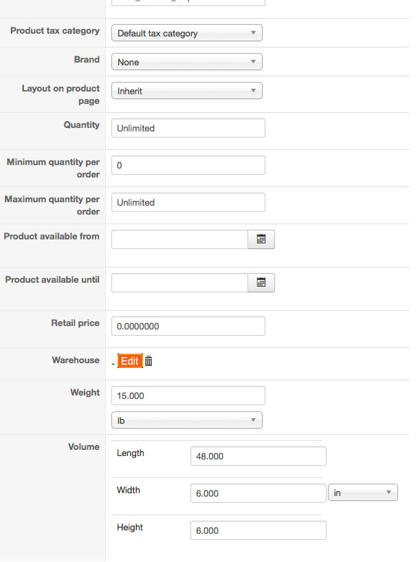

Product Info:
- Weight : 15 lbs
- Dimensions: 48 x 6 x 6 inches

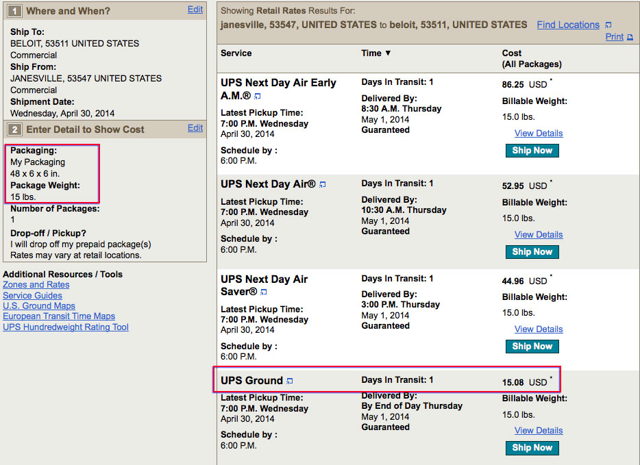

The UPS Calculator says:
UPS Ground - $15.08

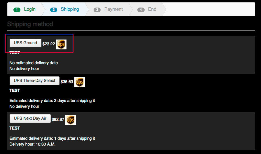

Hikashop says:
UPS Ground - $23.22

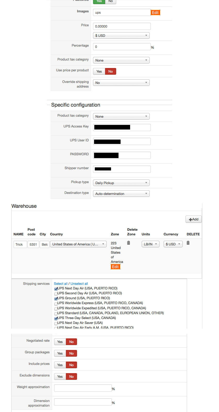

I've done my best to troubleshoot the issue using the points from the post below, but no luck.
- www.hikashop.com/forum/2-general-talk-ab...-ups-rate-sheet.html
I've also attached a few pics of the Prodcut settings and the UPS Shipping Plugin settings.

There are several options of the UPS plugin which can change the rates calculated by UPS besides the warehouse information:
The pickup type, the destination type, the negotiated rates, the include prices, the exclude dimensions and the group packages option can all generate a different price.
From your screenshot of the UPS calculator, it seems that you selected a different pickup type than what you have configured in the plugin. And you configured a "commercial desitination" in the UPS calculator but not in the UPS plugin.
The rates are given back by UPS themselves. If they say it should be $23.22, it means that with the way the plugin is configured that's this price which should be paid. If you see a difference in the calculator, it means that something is different in your plugin settings and in the calculator settings. If you have trouble with the settings, I would recommend to contact UPS for help to understand what options should be used to get the same result, they know better than us their calculator settings.
