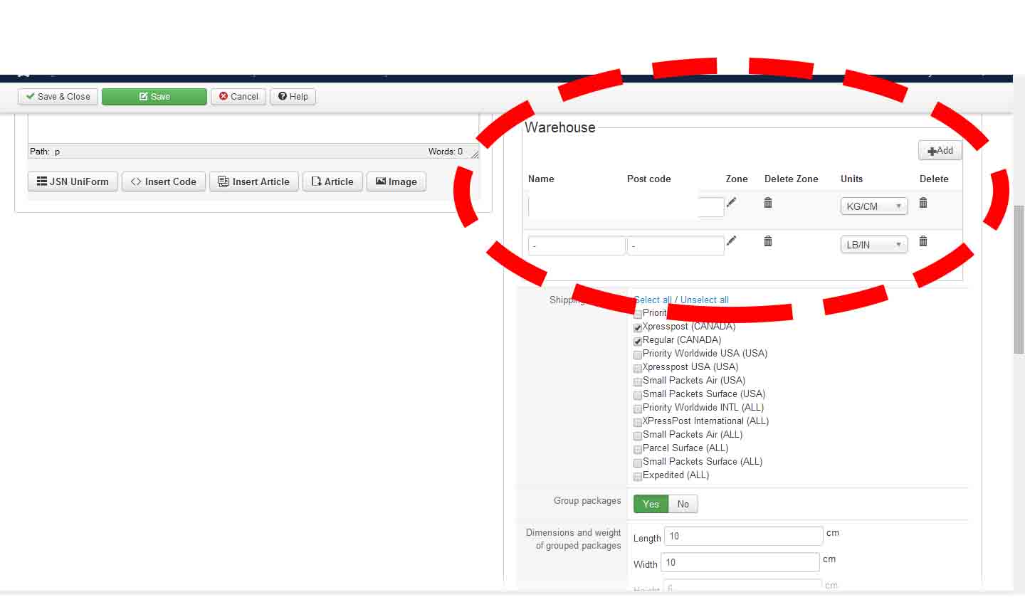

I recently upgraded hikashop to the latest version. All of a sudden i get this:
Error while sending XML to CANADA POST. Error code: -3000. Message: Origin Postal Code is illegal.
Not sure what is causing it. I have verified the Canadian postal code as 6 characters with no space in them bu that did not help.
I also noticed that the ware house keep duplicating it as shown in the image attached here. I have attempted to delete thee second option but it keeps poping up.
is there something i am doing wrong? please help.

12 years 2 months ago #163215
Can you check that you correctly removed the "-" through your warehouse Name and Post code ?
  • Posts: 16
12 years 2 months ago #163309
I did that already!! Problem is that the second warehouse option does not go away. It keeps re-appearing after saving the settings.

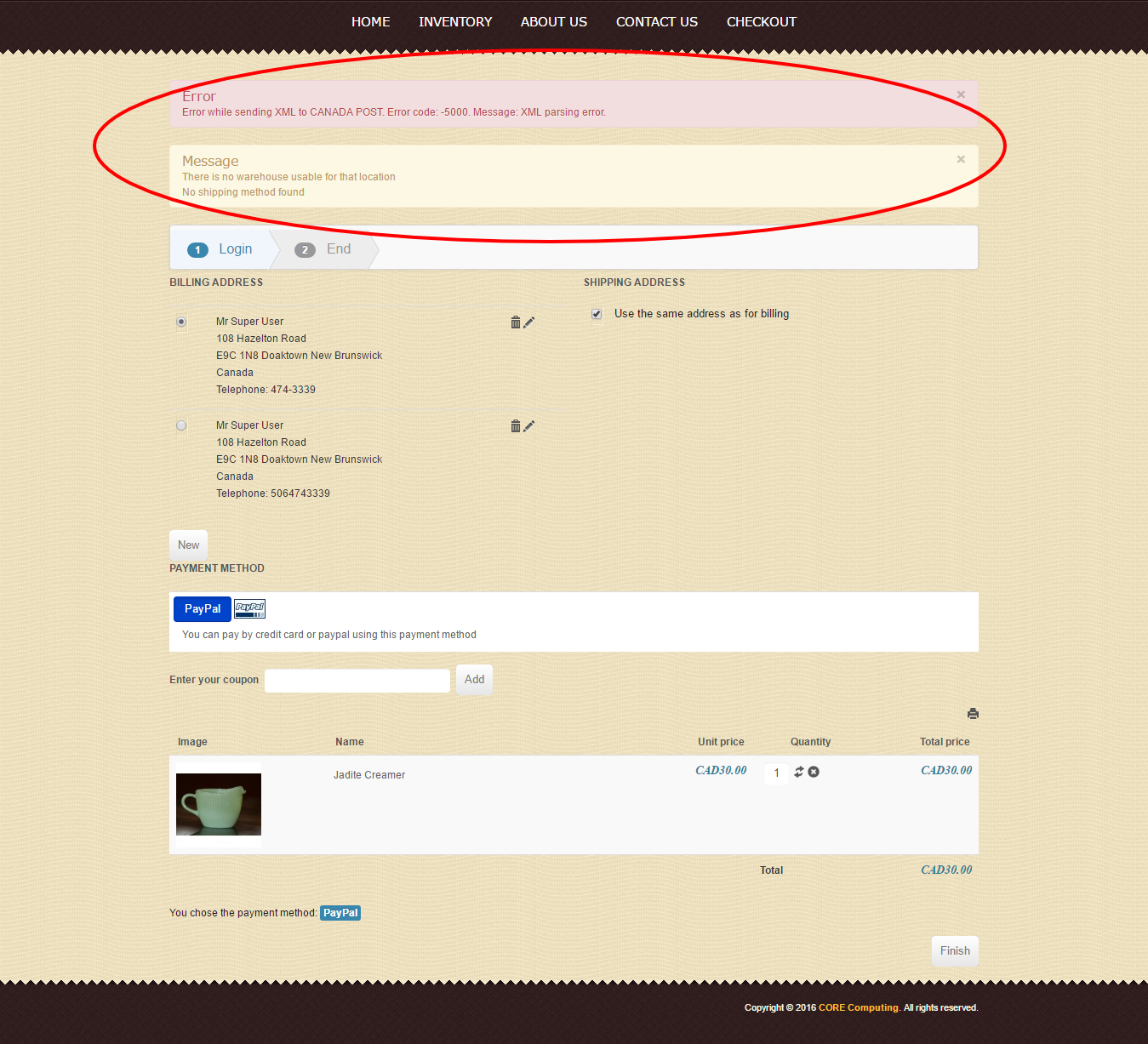

I'm having multiple warnings and errors when testing our Hikashop checkout.
Here's our website URL: highwheelerantiques.com/
Screenshot attached.
I've already gone through the FAQ page about setting up the shipping plugin, I've already made sure the item had a weight associated with item being ordered, I've checked to make sure that I had the correct Merchant ID and configured the shipping profile on the Canada Post website and I created a warehouse in both recommended places, the plugin and in the module configuration section. Kind of at a loss now. Can someone please help.
10 years 5 months ago #234661
Can you show me some screenshots of how you configured :
- Your Canada Post shipping method
- The products weight/dimensions that are on your cart
So that I can understand and reproduce it on my end.

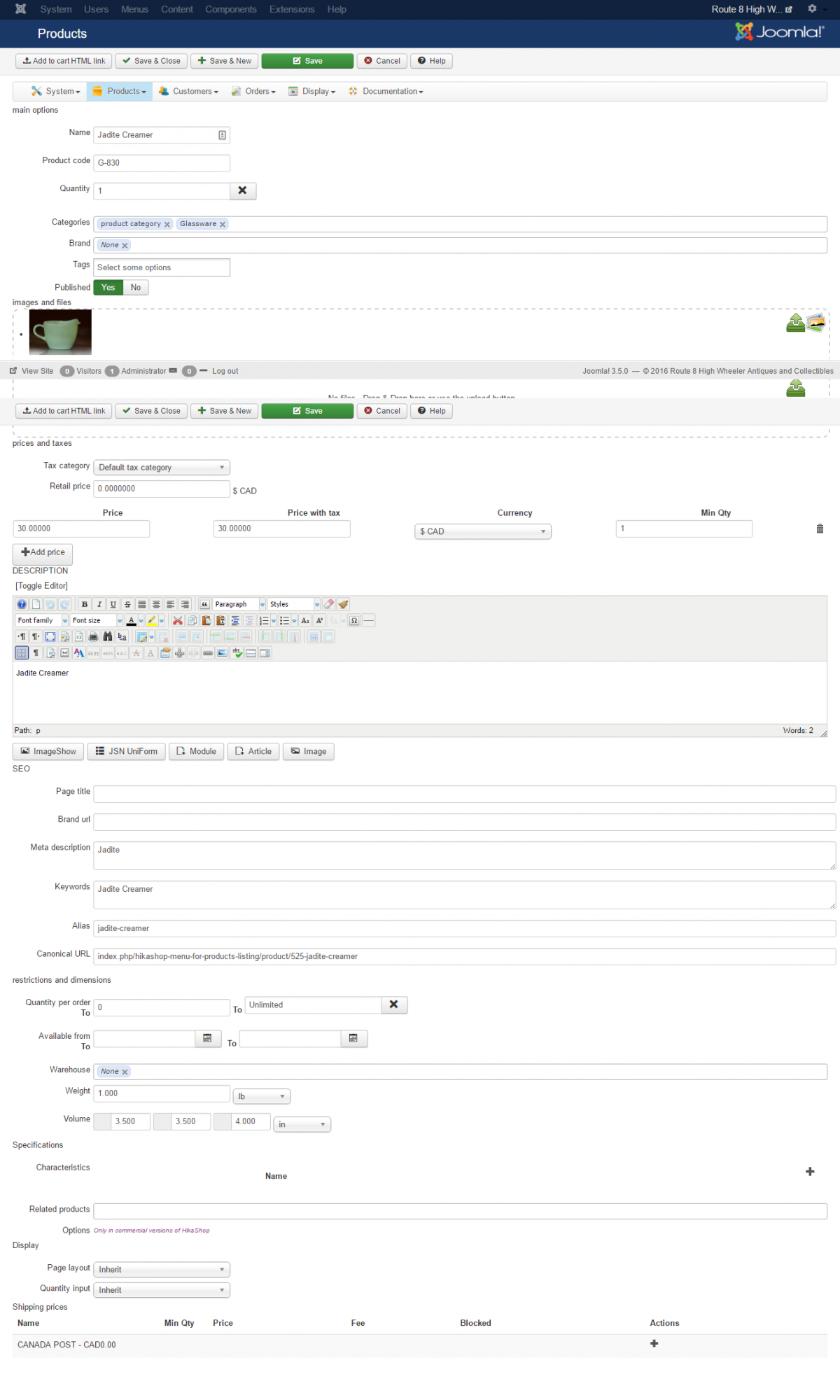

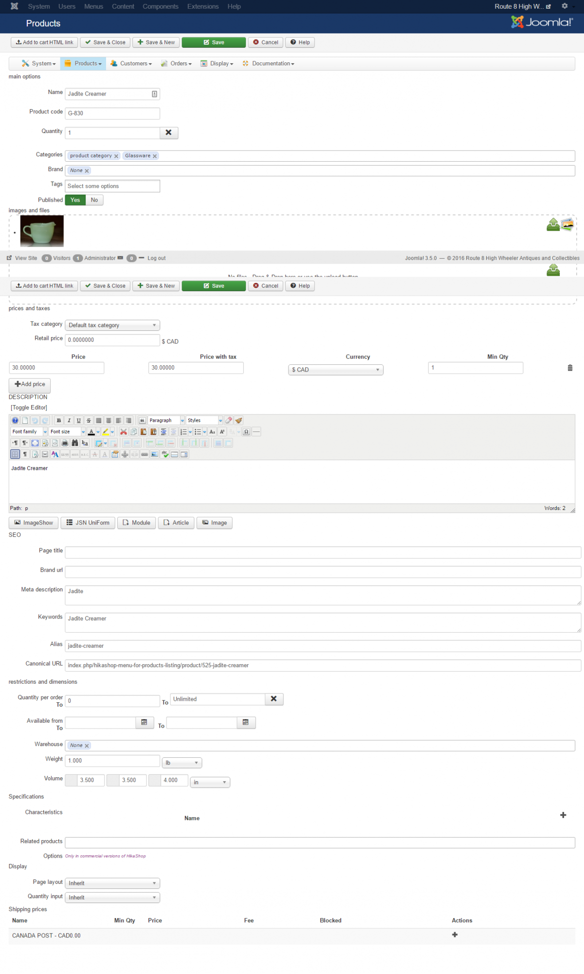

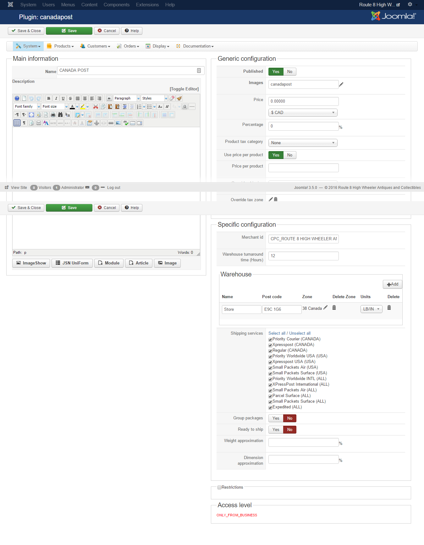

  • Posts: 19
10 years 5 months ago #234781
Screenshots attached.
Thank you
10 years 5 months ago #234825
I just tested it with :
- Your configuration
- a Canadian shipping address
And it worked fine with my credentials, can you give us a temporary access to your back-end so that we can directly test it ?
