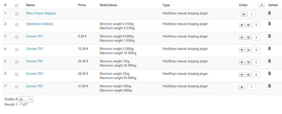

I have set some manual shipping method (img 1):
1 - pick up in shop address for free
2 - free shipping for products with weight 0.010
3 - 8 € for products with weight from 0.020 to 1.900
4 - 12.40 € for products with weight from 2 to 14.900
5 - 20 € for products with weight from 15 to 34.900
6 - 28 € for products with weight from 35 to 99.900
7 - 41 € for products with weight from 100 to 999
vat is 22%

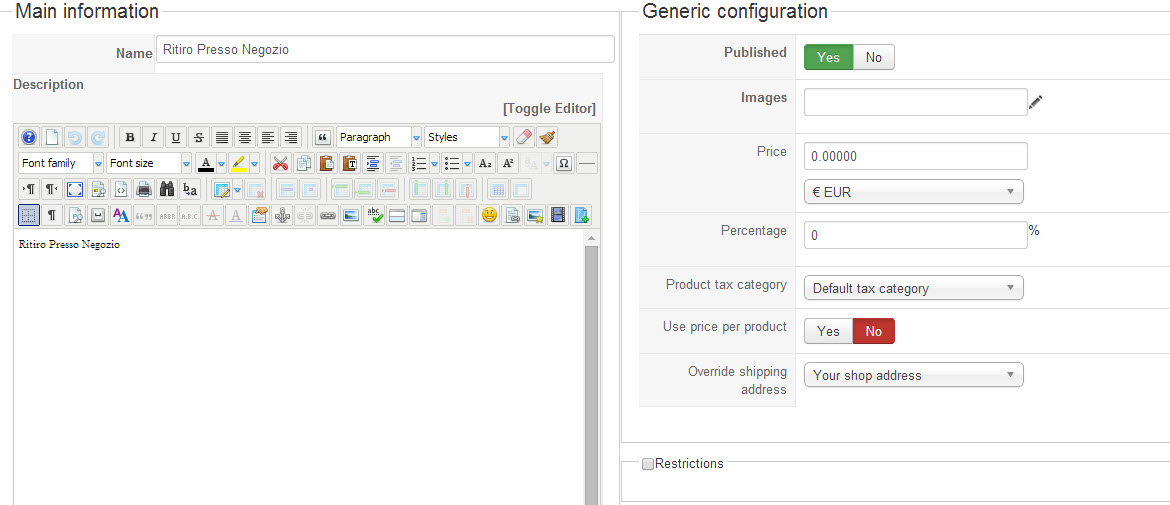

the method 1 is set to "override shipping address" -> your shop address (img 2)

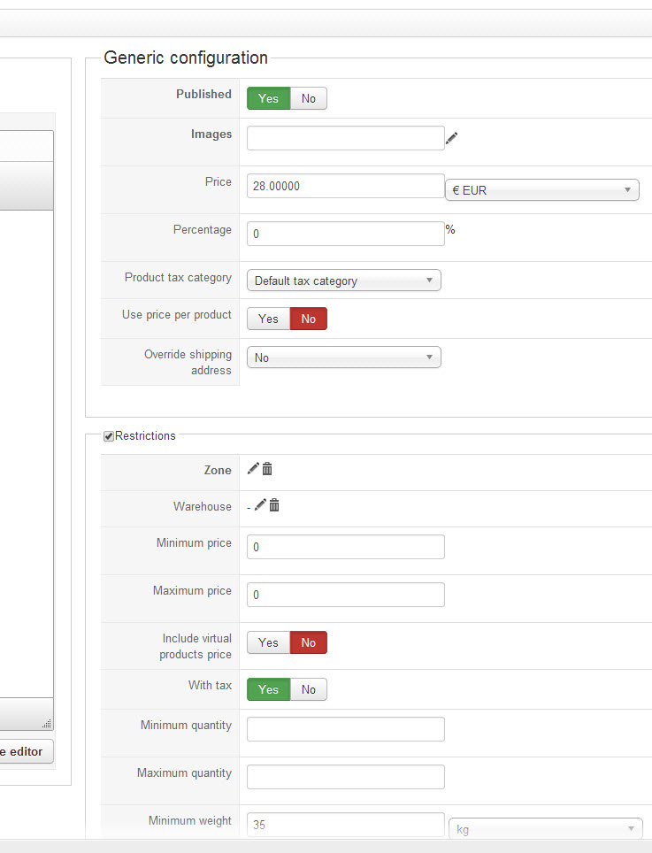

all the other methods are set to "override shipping address" -> your shop address and restrictions by minimun/maximus weight (img 3)

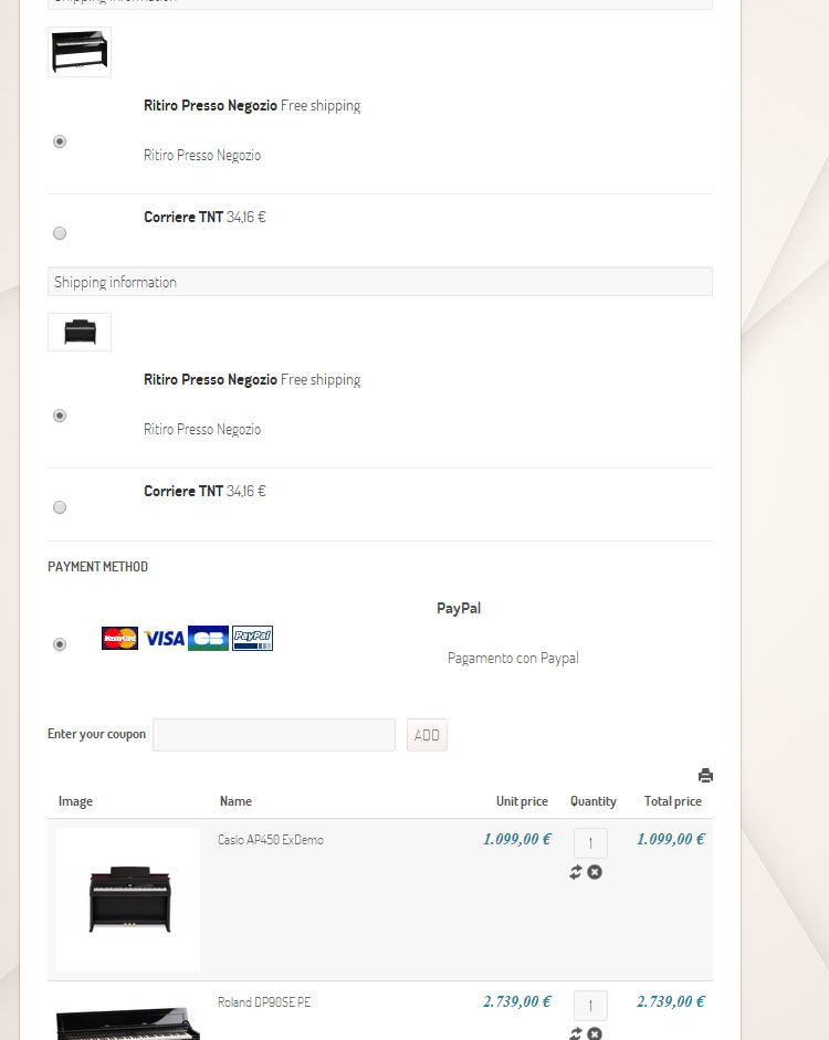

It is all OK if I buy 1 product, I can select pick up to my shop or shipping by courier and the calculation is correct.
It is OK if I change the quantities to 2 or more, the calculation is correct: the price for shipping changes to new rate for new weight
The problem is when I buy 2 products.

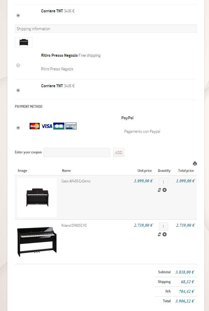

I can select for each product the method of shipping and it is OK (img 4) but if I select the shipping by courier for both products the price for shipping is wrong (img 5). Shipping is 34,16x2 -> 68,32 (wrong)
the correct price must be 50,02 (method 7) because the total weight is 55 kg for 1 product + 65 kg for the other product = 120 kg total weight

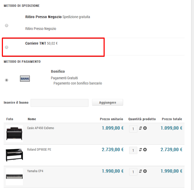

11 years 11 months ago #165667
I just tested it and it seems to be working fine for me the shipping method 7 is showing :
The following user(s) said Thank You: brownie
  • Posts: 23
11 years 11 months ago #165670
:blink: I am happy to see it works even though I don't understand ... In my previous tests I have observed that anomaly otherwise I would not have requested your help .... Anyway I am happy and thanks for your support!
