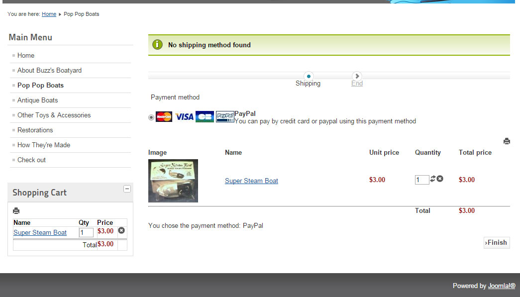

No Shipping method found
  • Posts: 6
11 years 10 months ago #176299
-- Joomla version -- : 2.5.14
-- PHP version -- : 5.4.29
-- Error-message(debug-mod must be tuned on) -- : No shipping method found
Updated to 2.3.3 (was not working on previous version either).
Product has a weight and all demensions
No restrictions on product
Only using USPS plugin, and I have input the USPS API user ID in Hikashop setup
Works if I set it to virtual goods
Last edit: 11 years 10 months ago by turbo4door.

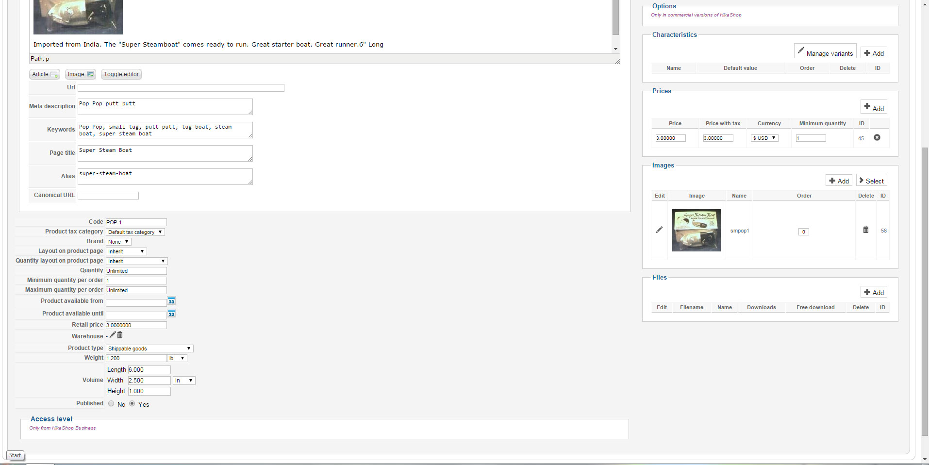

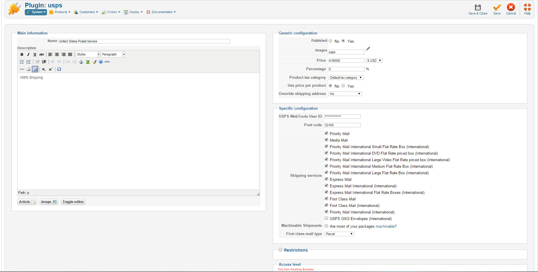

11 years 10 months ago #176325
Can you show me through some screenshots how did you configured your USPS shipping method and the product that you have added to your cart so that I can directly test it ?
Thanks ?
  • Posts: 6
11 years 10 months ago #176423
Attached screen shots as requested. If you need other information please let me know and I will get it.
11 years 10 months ago #176439
Did you add the "Address" action through one of the step of your checkout workflow ("Hikashop->System->Configuration->Checkout") ?
Did you use the options of the "Restrictions" tab of your shipping method configuration page ?
  • Posts: 6
11 years 10 months ago #176547
Mohamed Thelji wrote: Did you add the "Address" action through one of the step of your checkout workflow ("Hikashop->System->Configuration->Checkout") ?
No to the "Address" action. I'm using paypal as a payment source which, if i understand correctly, means I shouldn't need to the Address action through Hikashop since that is all handled through paypal?
I did not use restrictions tab as you can see in the screen shot.
  • Posts: 6
11 years 10 months ago #176549
If I set a manual shipping method, it will work, but not with USPS shipping method.
  • Posts: 6
11 years 10 months ago #176551
Looks like its because I didn't have registration set up for the joomla site. Is there a way around this or the ability to check out as a guest to get the shipping quotes? I do not want my clients to have to register but would like to use the USPS plugin?
11 years 10 months ago #176584
No, the USPS shipping address will be collected through the "Address" action of your checkout workflow, so you'll NEED it.
