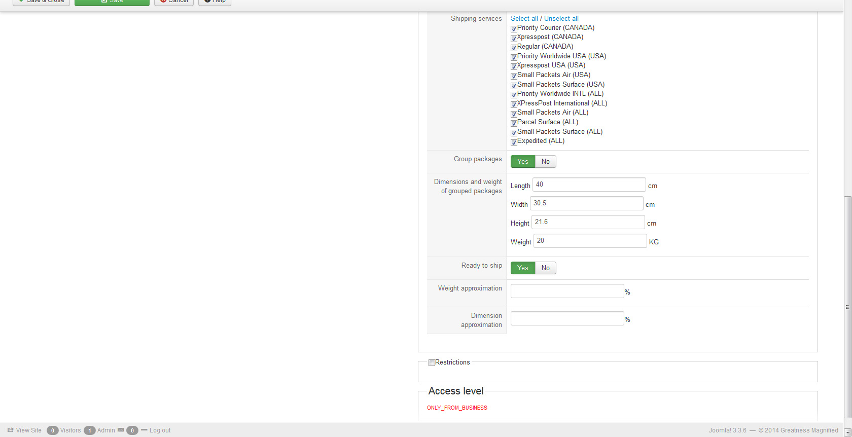

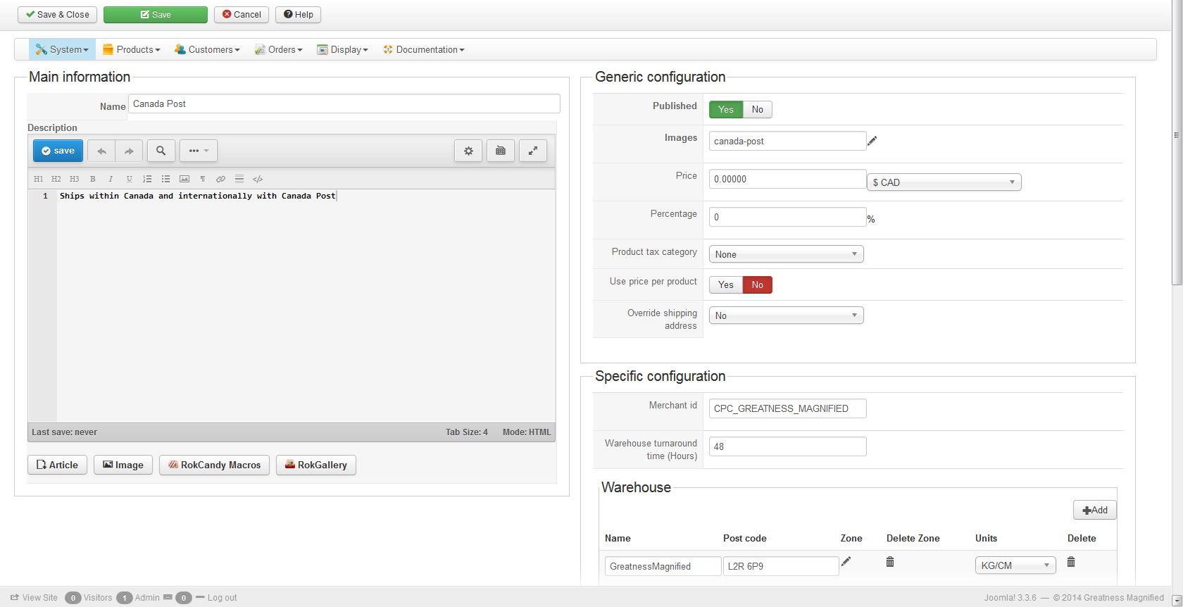

11 years 9 months ago #179973
Firstly, can you show me some screenshots of how did you configured your Canada Post shipping plugin ?
  • Posts: 12
11 years 9 months ago #180047

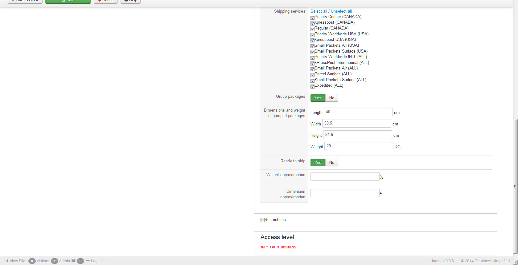

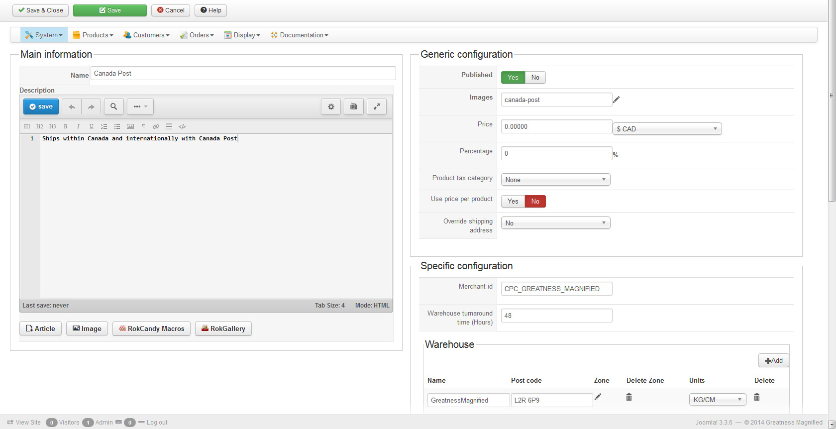

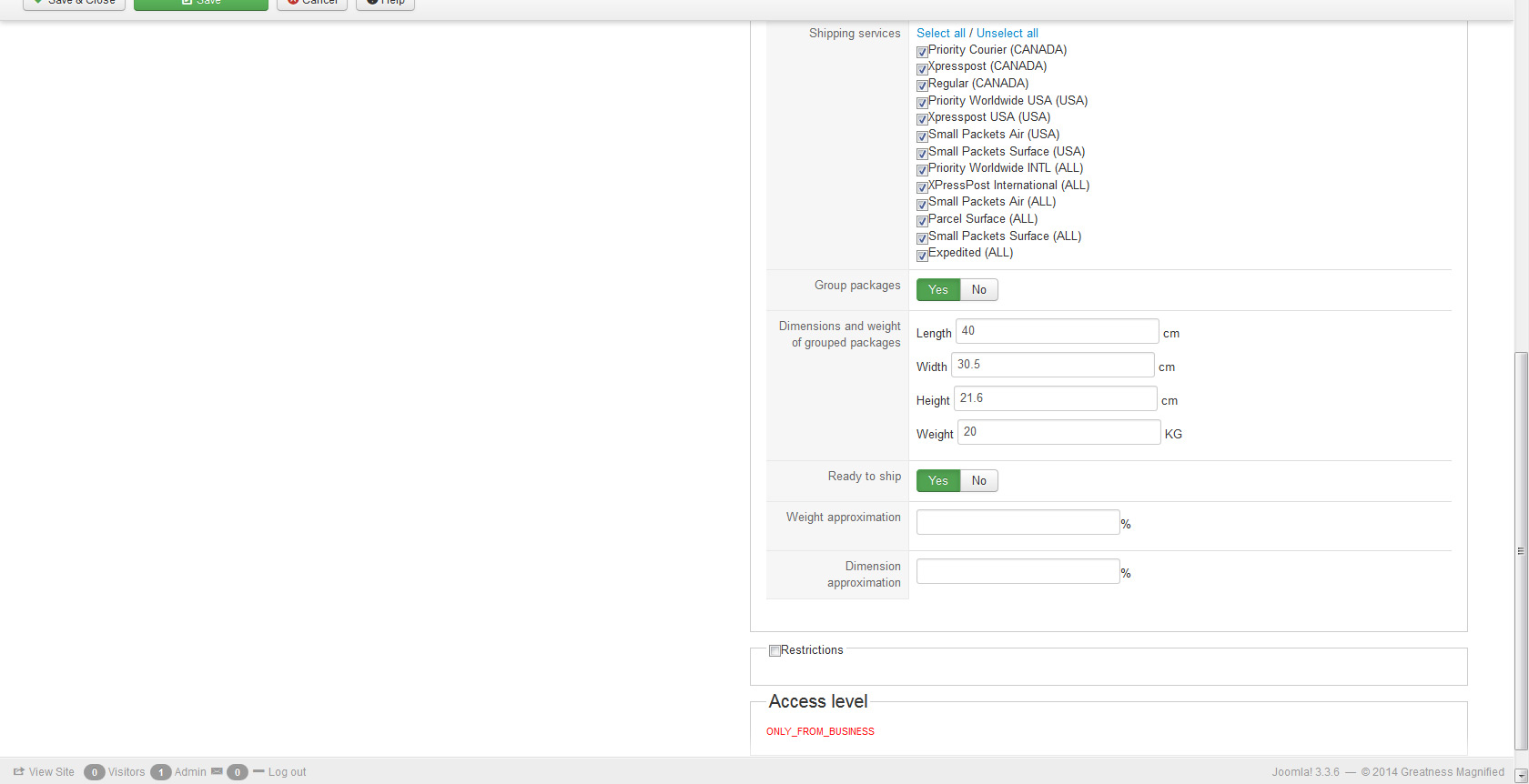

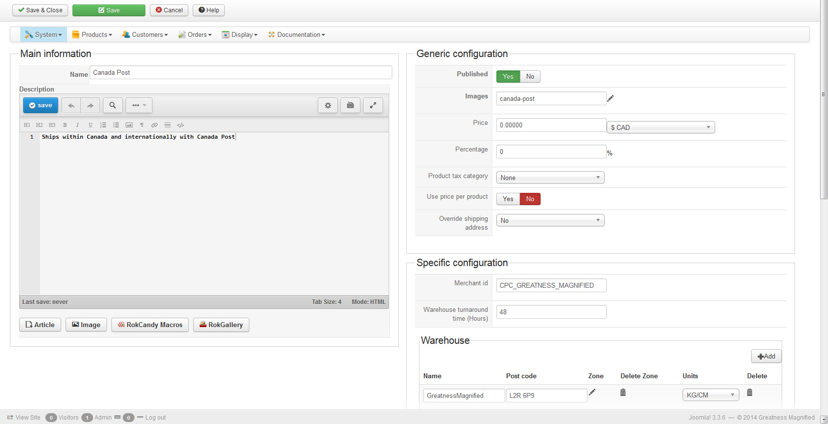

Here they are below.
11 years 9 months ago #180176
1.
In you case you have set the "Group packages" option to YES and the "Dimensions and weight of grouped packages" option, so your products will be grouped on 40 x 30.5 x 21.6 cm packages which will weight less than 20 KG. Note that these option can make your shipping price vary.
Modifying the handling fee in the Canada Post SellOnline site has no effect on shipping price
You should probably just use the price option of the shipping plugin.
2.
Playing around with the product sizes, shipping 5 products
Anywhere between 1x1x2 and 15x10x2 calculates $8.90
16x10x2 and over makes it back to 5 packages at $38.50, even at as high as 30x17x2.
Changing the weight between 0.490 and 0.010kg has no effect on the price.
You should maybe test it with bigger difference on weights.
Also, note that the when the group packages is ON, the packages dimensions will be set to :
- The 2 bigger dimensions of all products
- The total of the smaller dimension of all products.

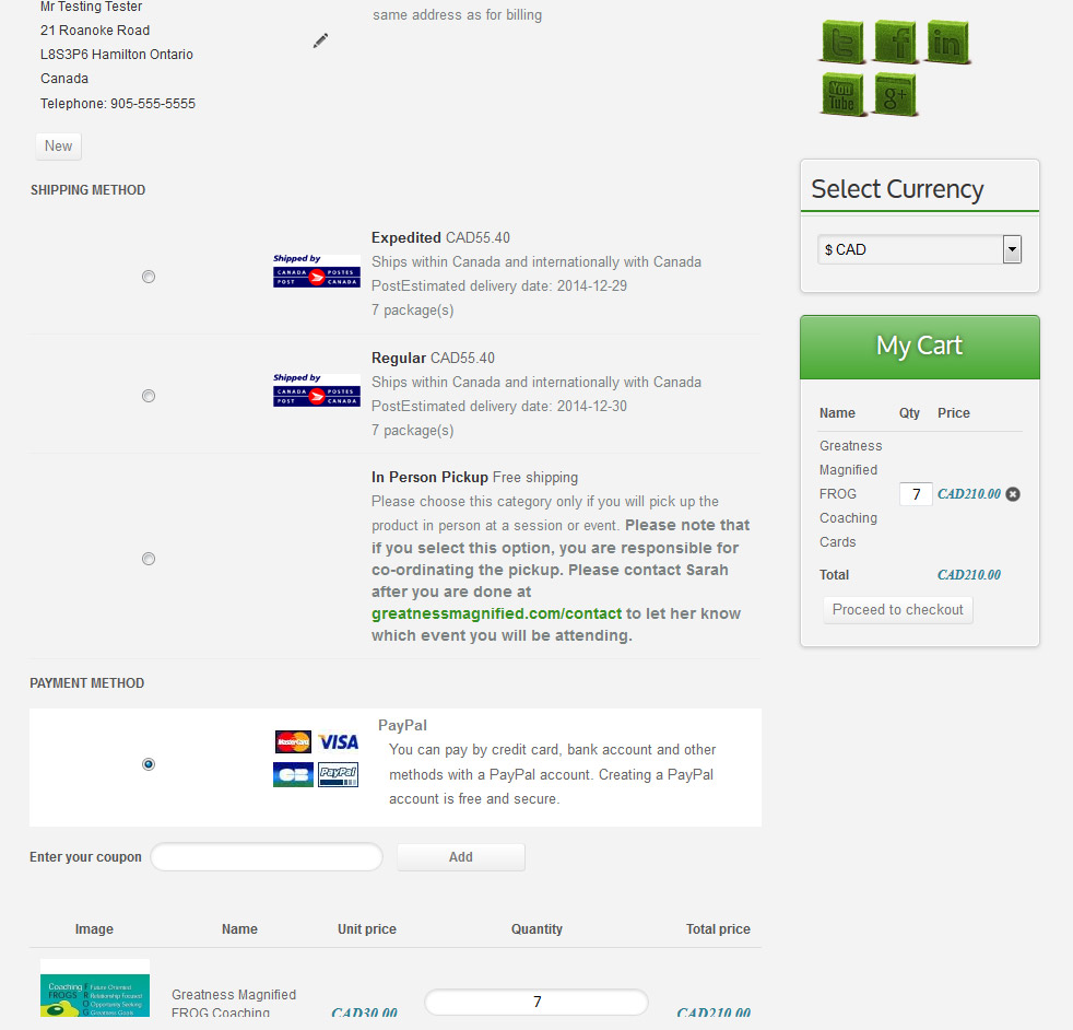

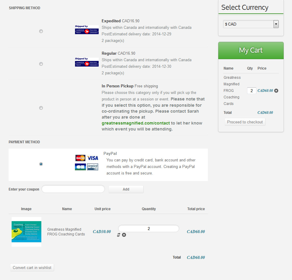

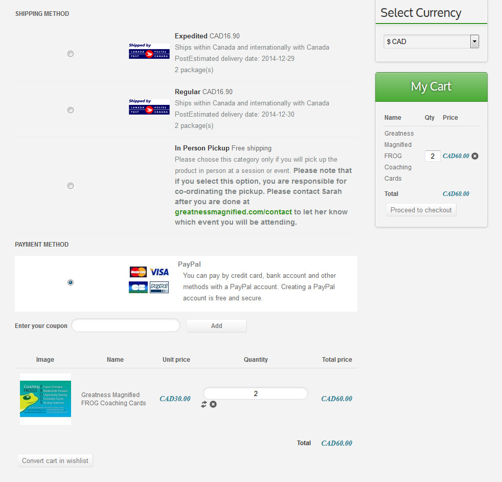

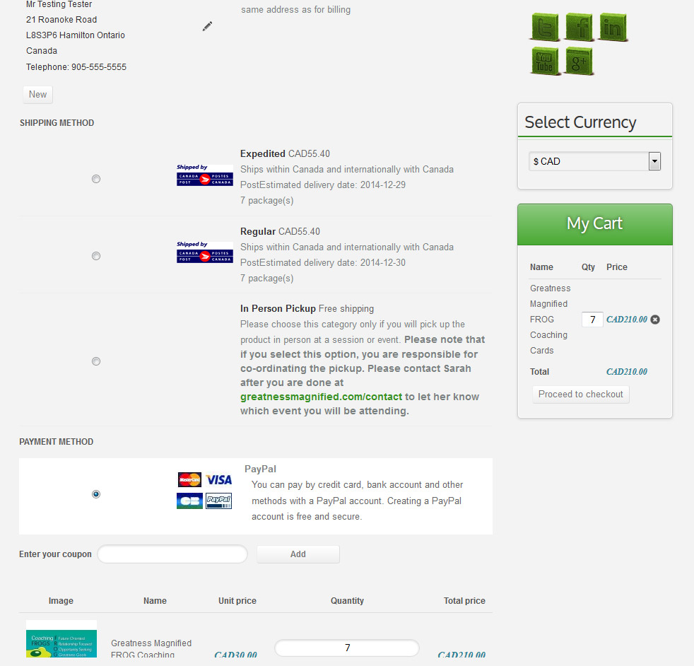

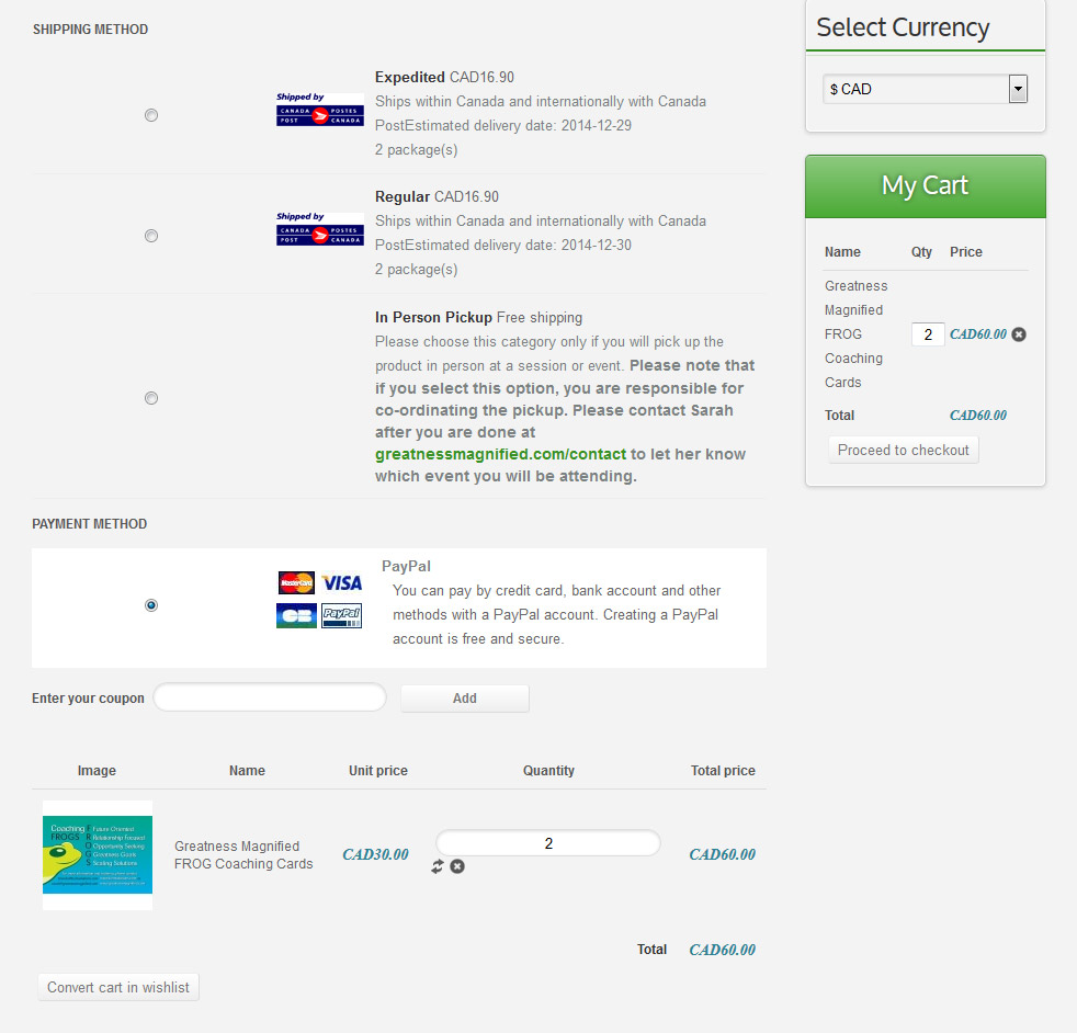

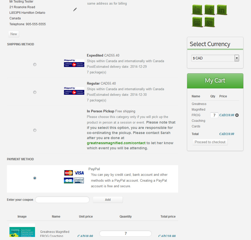

  • Posts: 12
11 years 8 months ago #184085
Thanks for your suggestion with the handling fee, that seems to work well.
I'm still having issues with the group package shipping. As you mentioned, the shipping module should calculate the two bigger dimensions of all products (in my case 30cm and 17cm) and the total of the smallest dimension of all products (in my case 2cm). For 7 products that would mean a package larger than 30x17x14 would be required. Even at a smaller group package size of 31.1x23.5x13.3 cm that should fit 6 products and therefor only require two packages.
I have tried with more substantial changes to the weight but it does not seem to help. This particular store at the moment has only one product and it is quite small. Therefor the group shipping option is very important to get working.
Below are a couple more screenshots of the front end checkout. Let me know if you need any more information as I really need to get this working.
