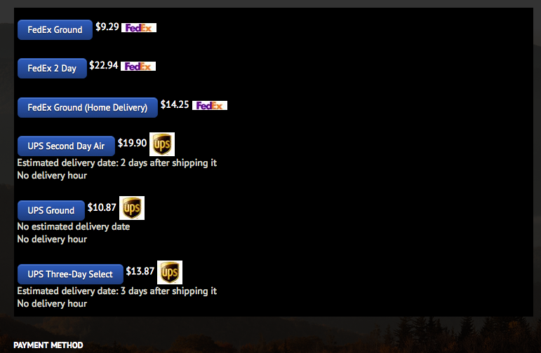

Where do I control the estimated delivery date information for UPS? I see there is an option in the Fedex plugin but I cannot locate in the UPS plugin. I searched the forums with no success.

I downloaded and installed the plugin and turned ETA option to yes. However I'm still getting "No estimated delivery date
No delivery hour"
