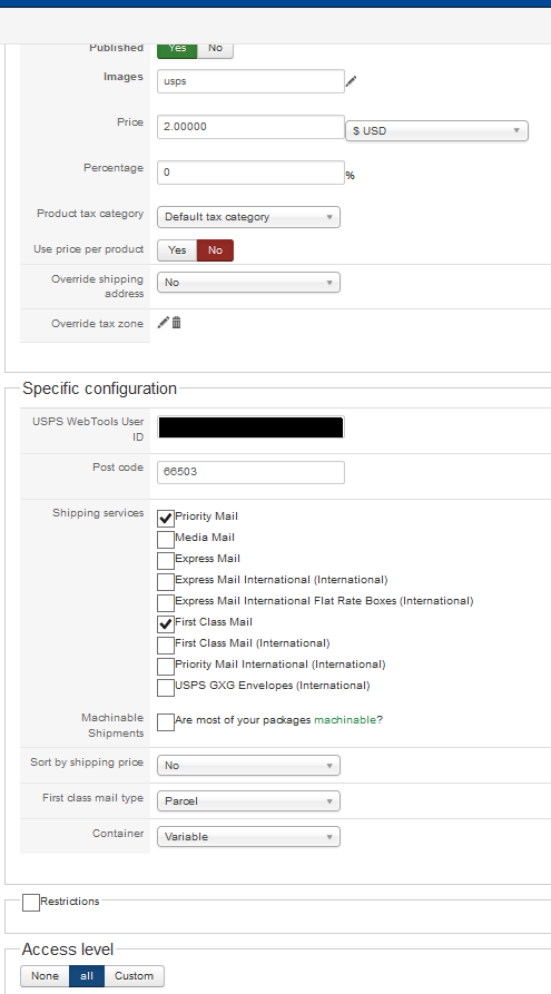

Can you give me more information through some screensthos for example about :
- the issue that you are having when using the last version
- the way you configured you shipping method / product

No error is displayed. It just displays the same rate for every order regardless of the destination, products, weight, quantity, etc.
It is always returning $4.54 for First Class Mail. I'm not sure where it is getting the number.
All other methods work fine.
