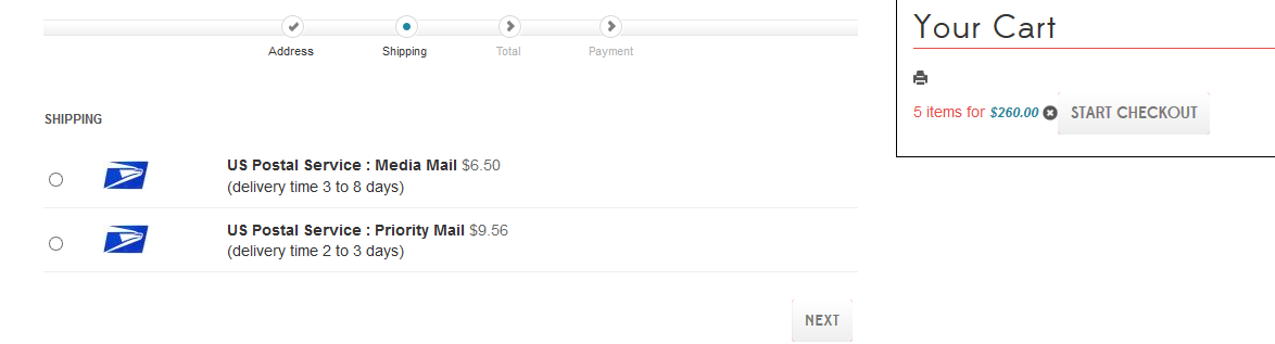

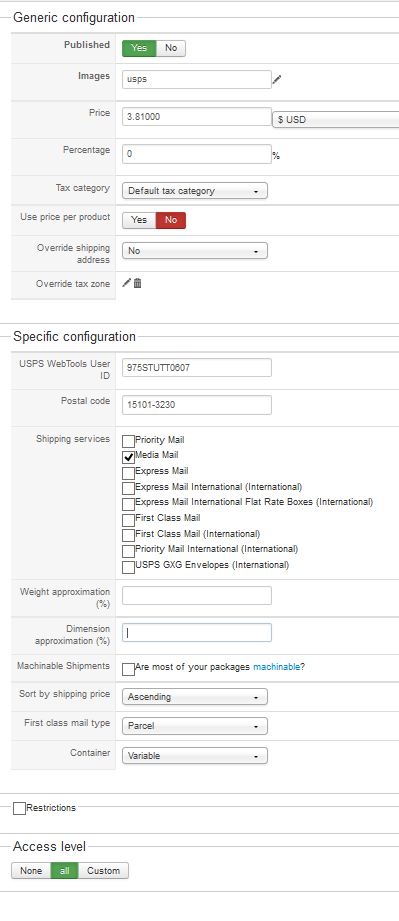

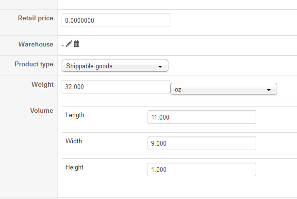

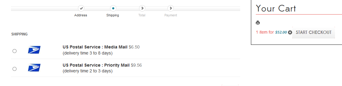

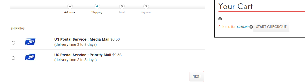

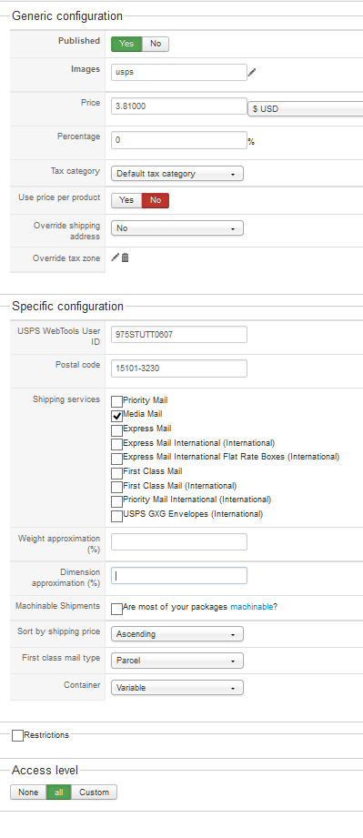

Sure. I have attached 4 screen shots:
1) USPS setup for media mail entry - i have not changed this, so it is the same as the configuration that worked perfectly (and has worked for over a year) until the update yesterday. Note that I have priority set up as a separate plug-in for reasons that I can't currently recall, but it has worked perfectly this way.

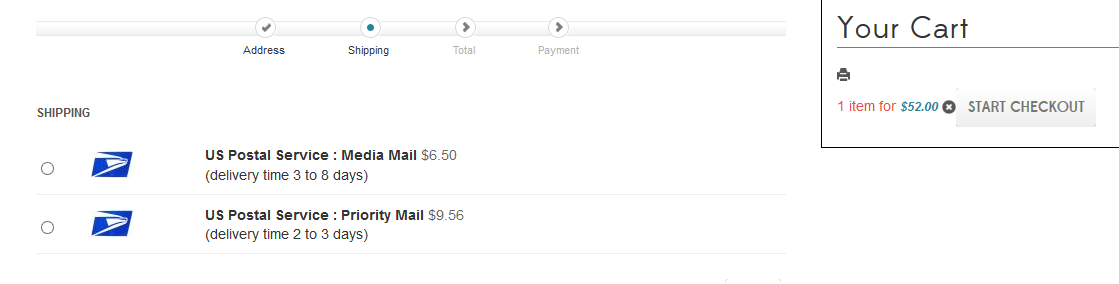

2) shipping options from front-end with 1 item in cart (showing $6.50 for media mail and $9.56 for priority)
3) shipping options from front-end with 5 items in cart (still showing $6.50 for media mail and $9.56 for priority) - before yesterday, it would have calculated a higher shipping cost based on the weight.

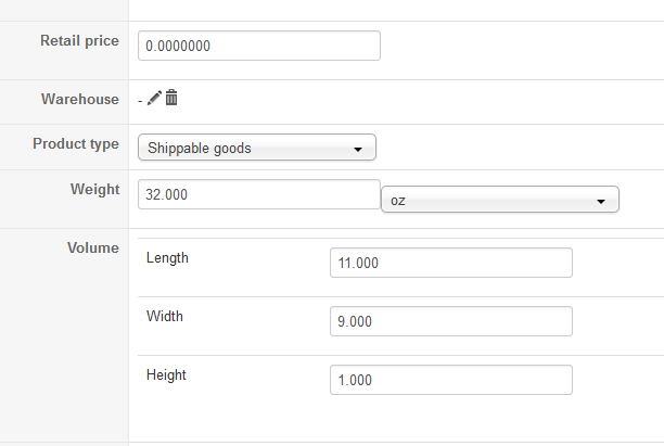

4) the product setup-page for that product demonstrating that I do indeed have the weight entered.
