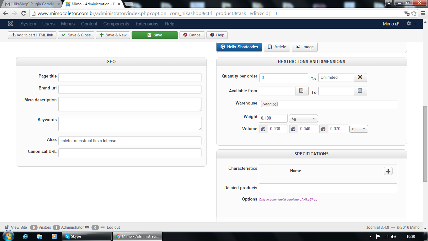

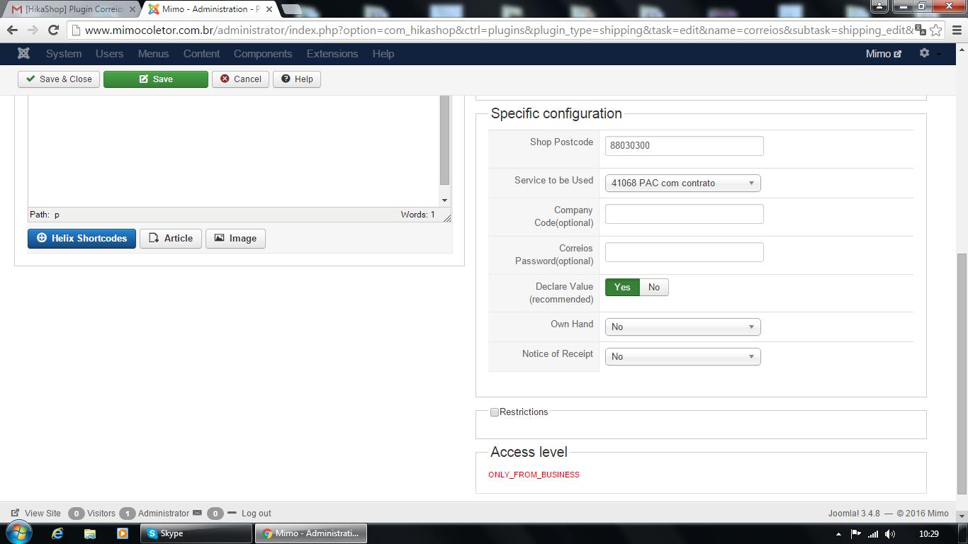

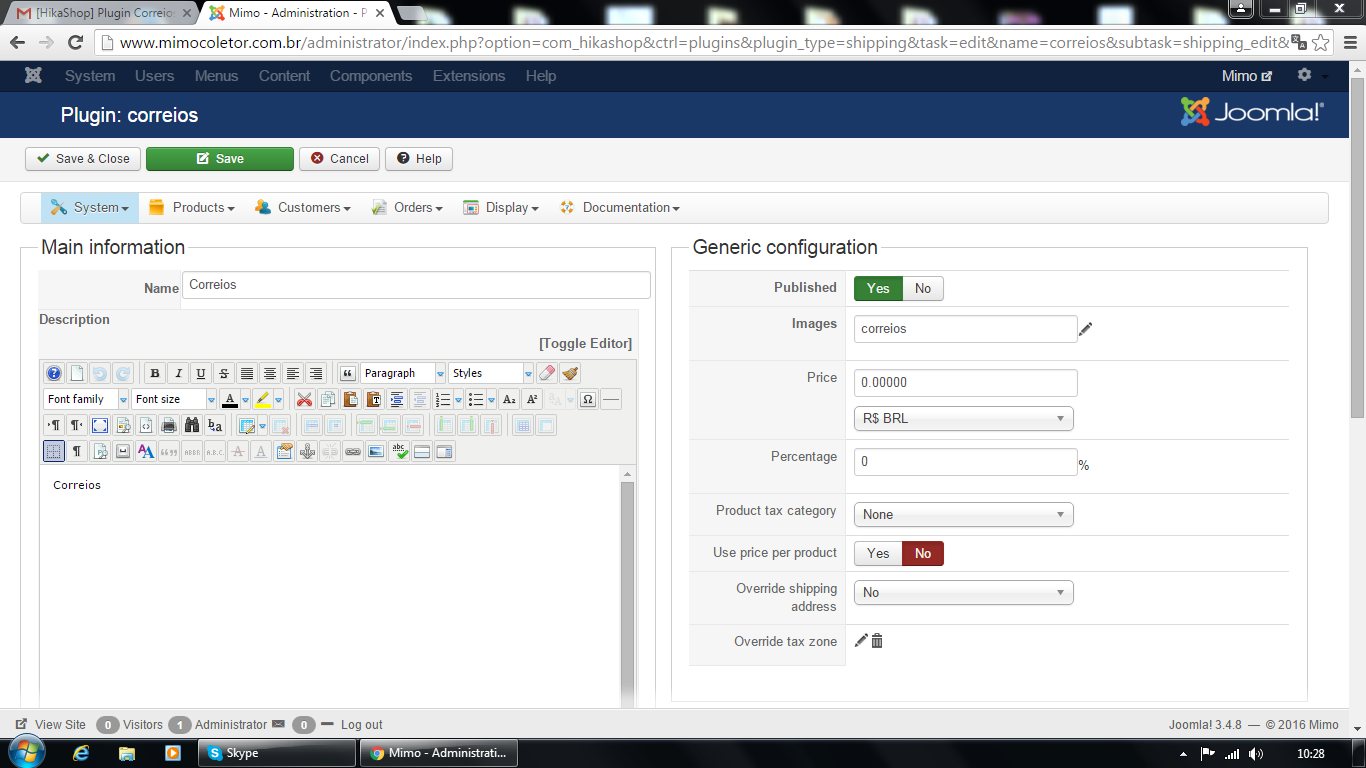

Can you show me some screenshots of how you configured your Correios shipping method and the dimensions/weight of the product in your cart ?

  • Posts: 5
10 years 7 months ago #228900
Please find attached the screenshots.
Thank you
10 years 7 months ago #228924
Note that it's working fine on my end with your configuration, did you :
- Use a Brazilian shipping address
- Set some of the "Restriction" options through your shipping method configuration page ?

10 years 7 months ago #229638
Hello Pedro,
To do that you'll have to directly use the "image" option of your Correios configuration page.

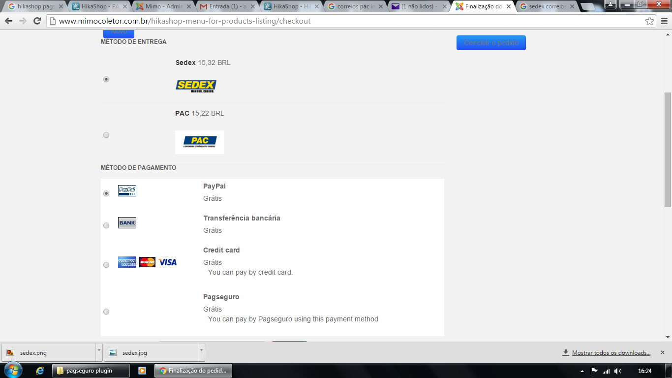

  • Posts: 5
10 years 7 months ago #229860
please see screenshot of my check out page.
I would like to have the images aligned with PayPal, Bank transfer, credit card...
Is it possible?
thanks
Pedro
  • Posts: 5
10 years 7 months ago #229863
I found the answer on how to have the images avaiable on the "Pagseguro payment method documentation".
However, (if it is not too much to ask) what would be the step-by-step of "If you want to add additional images, you can upload them via FTP into the folder media/com_hikashop/images/payment/ of your website and you will then be able to select them in that option."
Thank you again. :)
Pedro
10 years 7 months ago #230041
Hello Pedro,
In your case your should upload it to the folder media/com_hikashop/images/shipping and then you'll be able to select that image through the image option of your shipping method.
