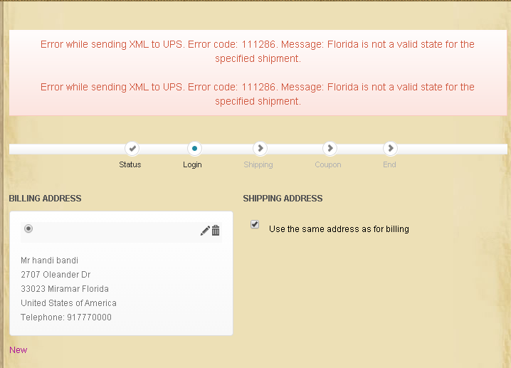

-- Error-message(debug-mod must be tuned on) -- : Error while sending XML to UPS. Error code: 111286. Message: Florida is not a valid state for the specified shipment.
Id there a way to make this work ?? to get the XML to have the 2 letter code instead of the full state name?
That's the only problem I see here from the XML error.

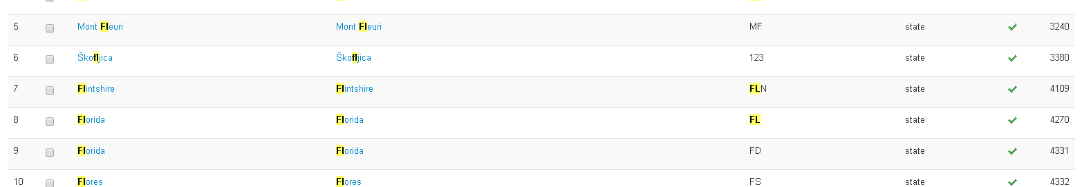

I just tested it with an address from Florida and it worked fine, can you show me how did you configured your Florida State zone via "Hikahsop->System->Zones->'Florida'" ?
Thanks.

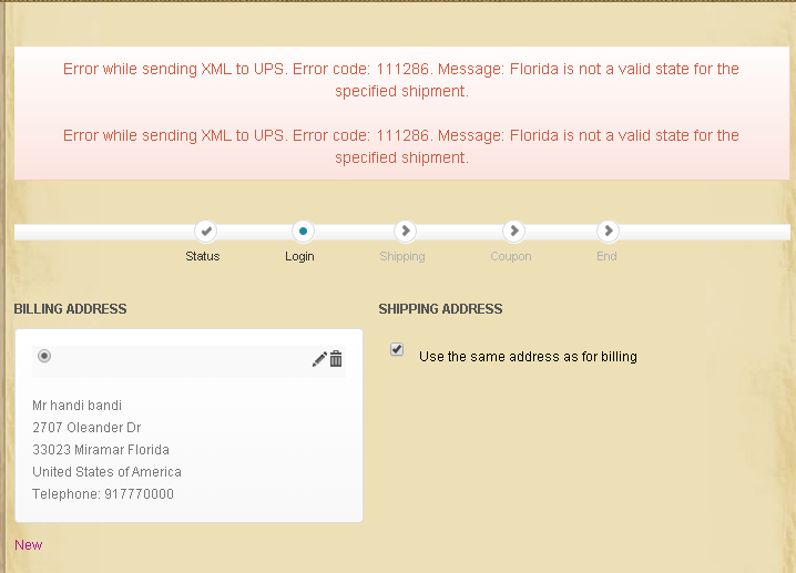

  • Posts: 11
11 years 5 months ago #198482
Please find attached the error with my test customer.

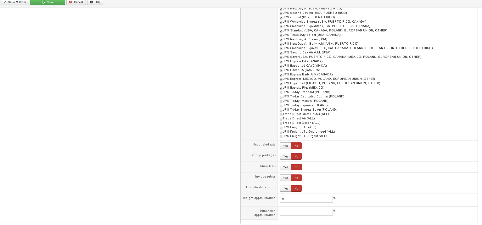

Can you show me how did you configured :
- Your UPS shipping method
- Your florida state via "Hikahsop->System->Zones->'Florida'"
Through some screenshots ?
Thanks.

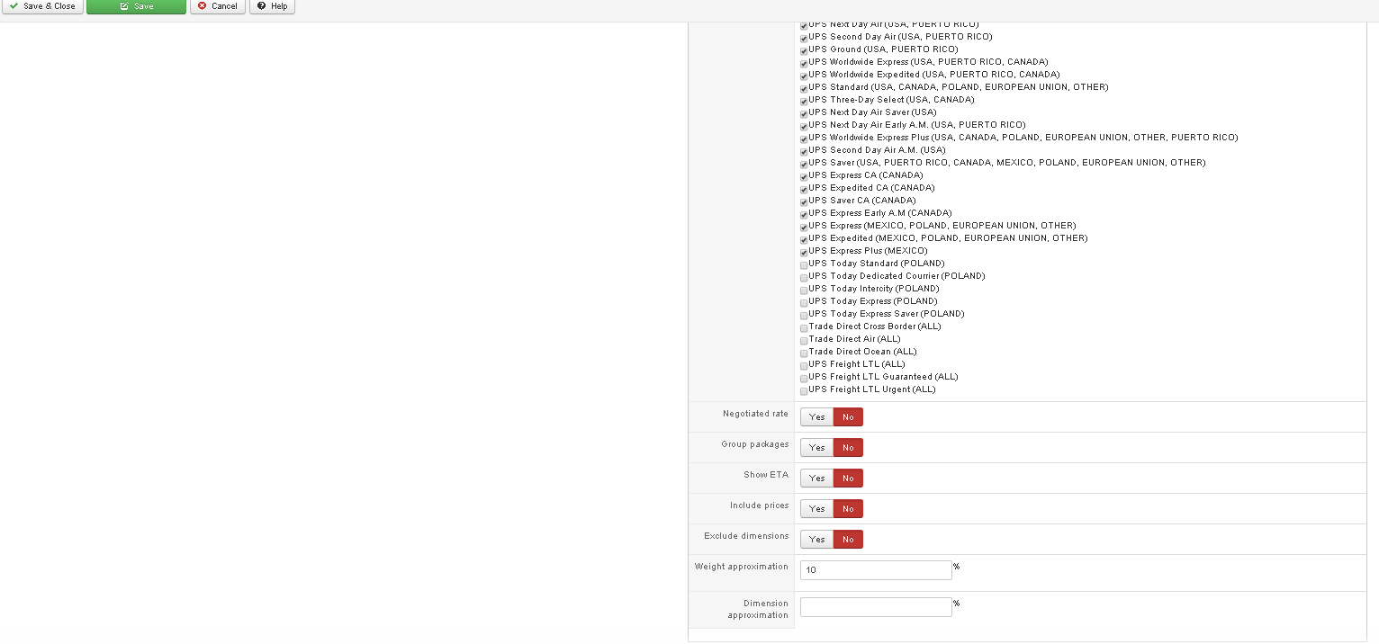

  • Posts: 11
11 years 5 months ago #198646
here you go...
all you requested!
Though it's all deffaukt configs though.. USPS works fine.. its the Parsing of the Florida to FL. where can i modify it to use the code 3 letters instead?...

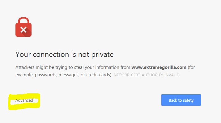

11 years 4 months ago #199145

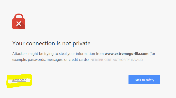

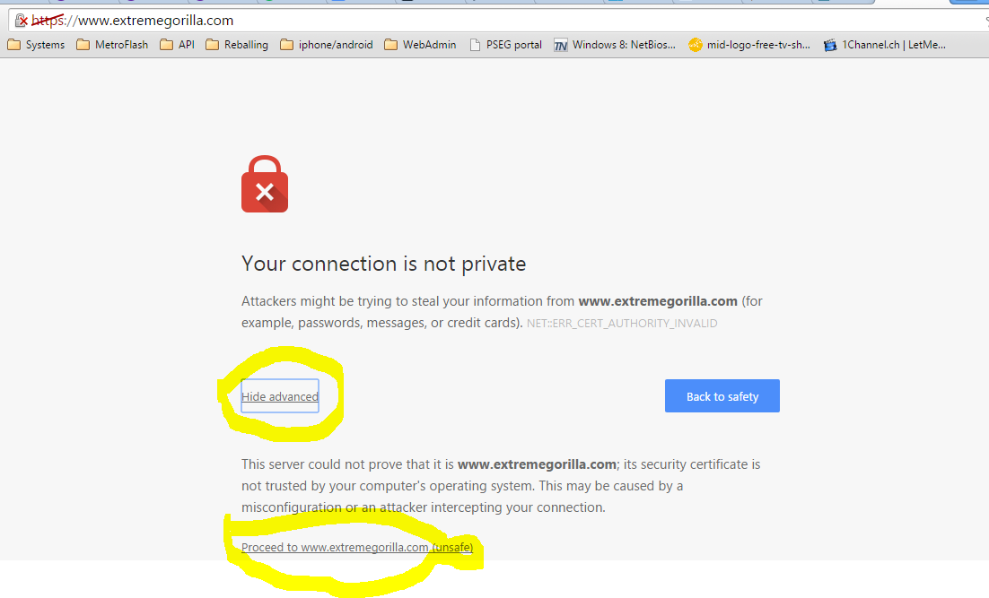

LMAO you guys! you guys! lol its a self sign ssl certificate right now for development purposes?
TIP: on chrome, or IE you can always skip and proceed to the page by clicking
attached picture on how to skip warning message :)!

11 years 4 months ago #199223
I know how to use Chrome and skip such error. But as you can see on my screenshot, the error is not about the certificate.
The error is "CONNECTION TIME OUT".
Yours is "CERT AUTHORITY INVALID".
As you can see on my screenshot, there was no such "proceed to ...." link where I could click on.
I've tried again just now and didn't get the time out error this time.
take.ms/SvJfj
This error means that either you changed one of the codes of the florida state zone to something else than FL so edit it anc check that it is not the case; or you entered "Florida" instead of FL in the "state code" field of your UPS shipping method, in the "warehouse" area.
So please check on that.
  • Posts: 11
11 years 4 months ago #199232
I fixed it. was UPS shipping method it said florida changed to "FL"... "Fl" didnt work.. ... Thats all ... great thanks, simple question loopy answer. thanks guys...
