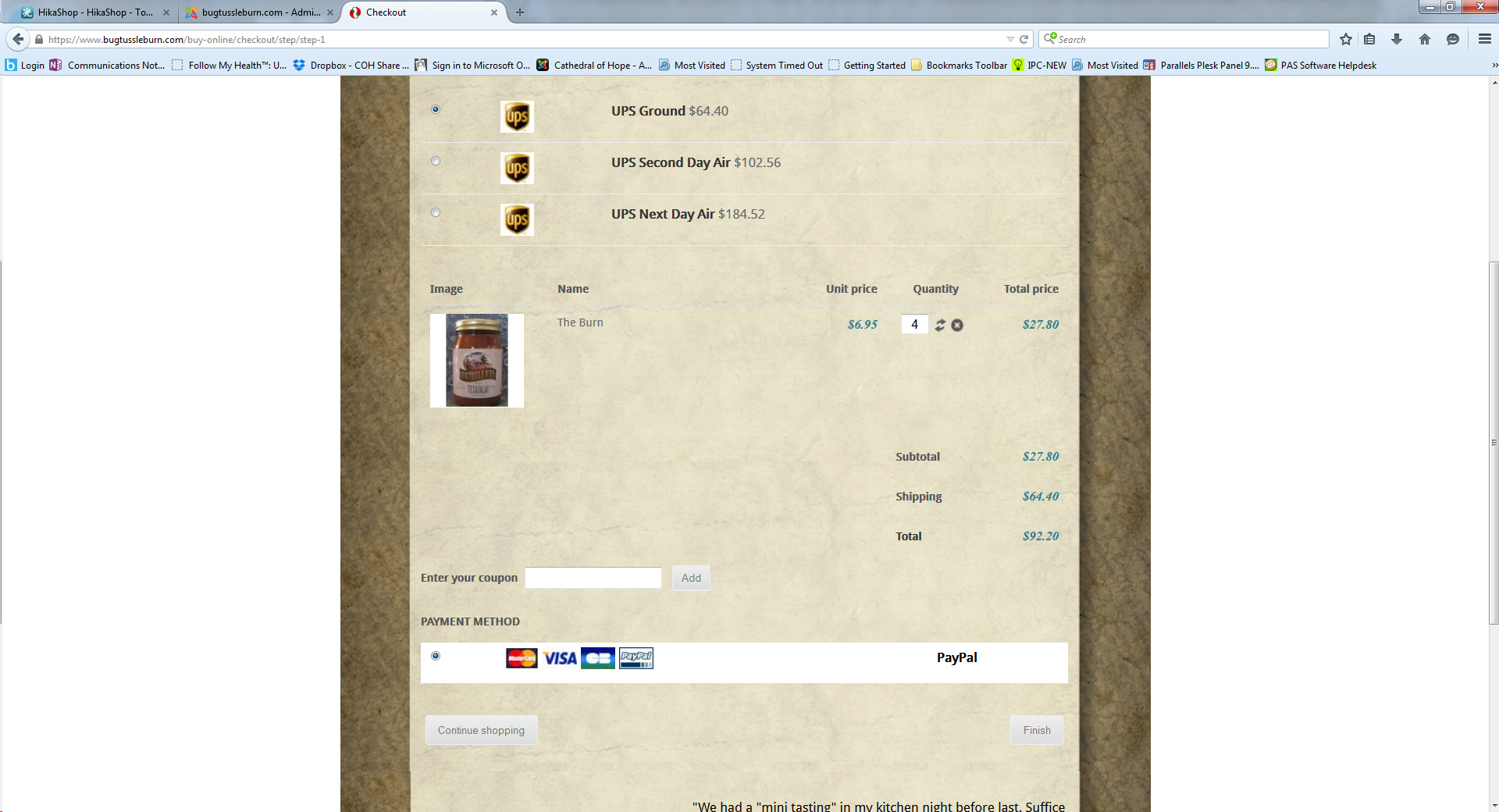

-- Error-message(debug-mod must be tuned on) -- : UPS rates WAY too high
I'm having issues with my ups rates through the shopping cart are WAY too high. I've installed the latest version.

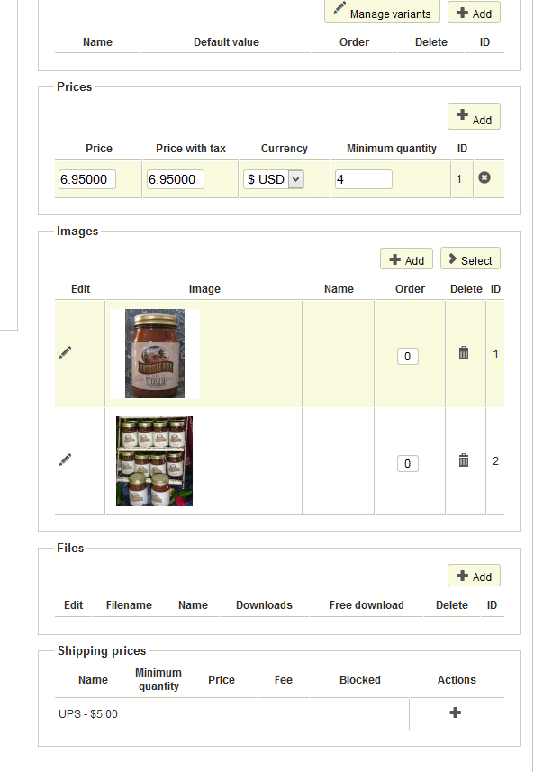

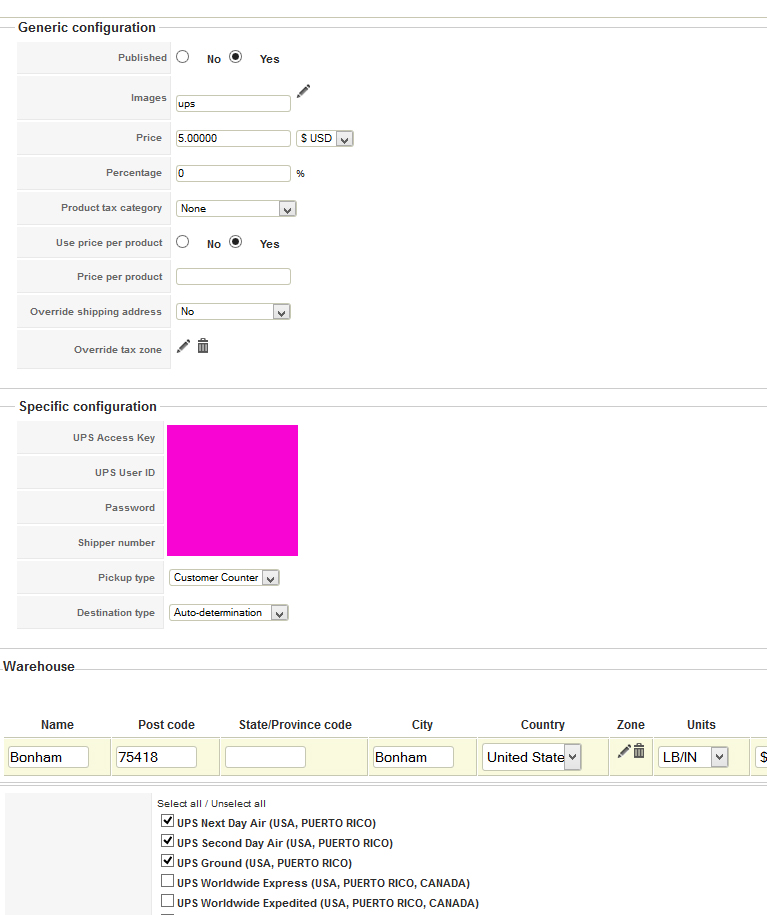

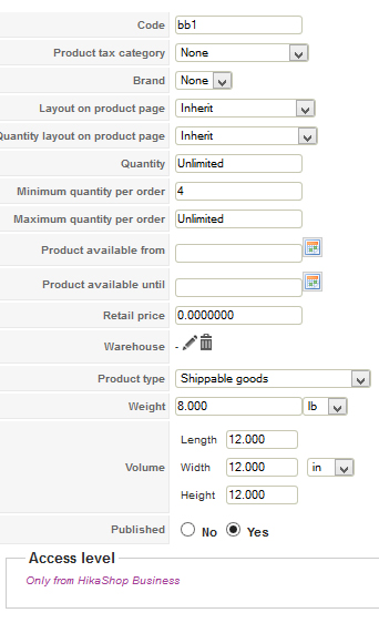

I've attached some screen shots. I used the UPS plugin. The package is 8 lbs and 12x12x12.
It SHOULD cost about 18$ but it's coming out as 64 or 56 or WAY more than 18

11 years 3 months ago #203060
Note that you have set the "Price" option to 5, so that rates will be equals to the rates that UPS is sending + 5$.
You should also set a state/province code through you UPS shipping configuration page.

11 years 3 months ago #203202
I checked your UPS configuration and note that you should remove the UPS "Price" option that you have set to 5, and also set the "Group packages" option to YES.

Thanks...that helped. How do I make it into 1 package instead of 2?
My shipper says she can get 4 jars..my minimum into one 12 x 12 x 12 box with a total weight of 8 lbs. When I set the size and weight on the product level..does it mean for all 4 minimum bought..or is it for 1 single jar?
